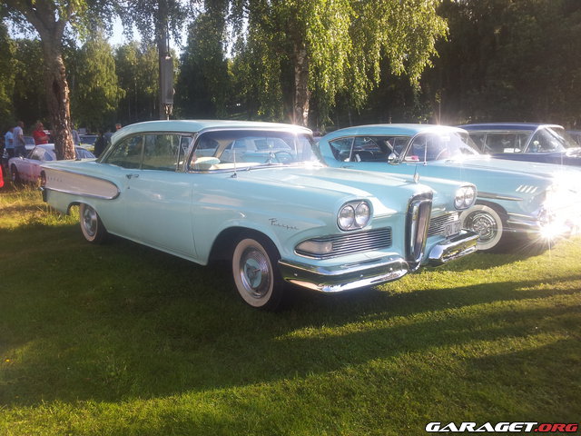

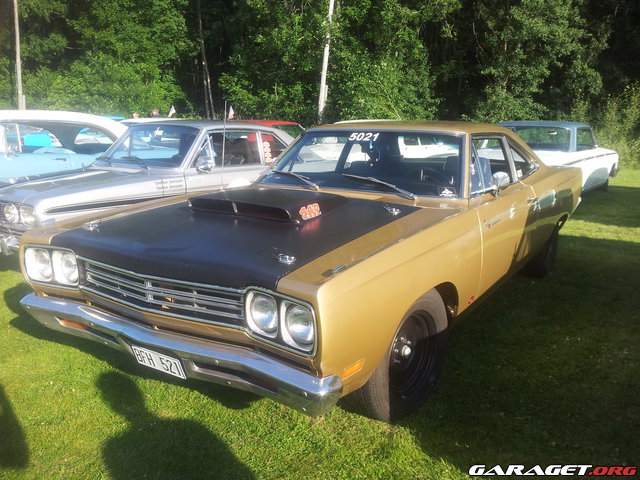

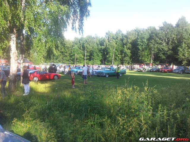

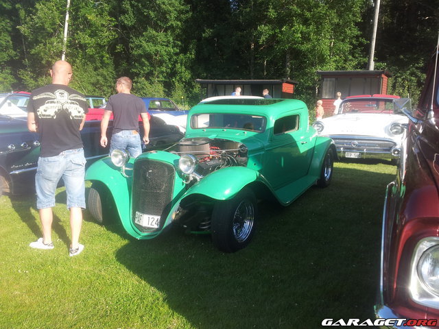

Went to a weekly car meet today. One of the nicer ones during the summer.
Love the mix between american cars and european classics, tractors etc.
Today was well over 300 cars in that field!
Sorry for the bad pictures, forgot the phone with the good camera at home.

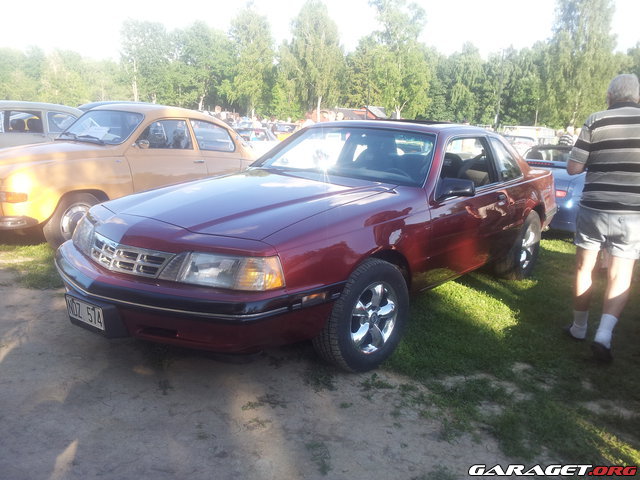

My T-bird there

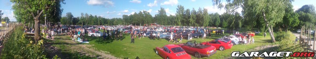

Panorama view in bad quality

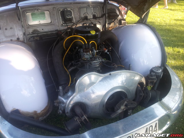

Awesome Panhard!
Panhard engine

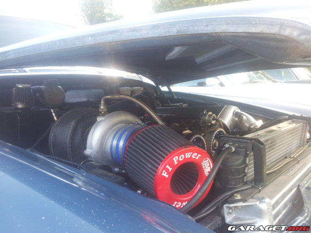

A very cool sleeper minus the seats

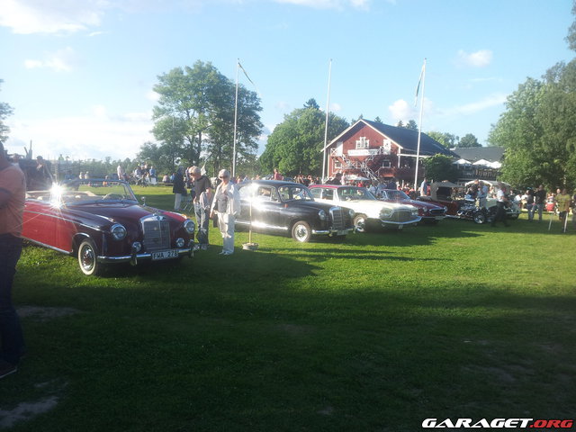

Some more overview

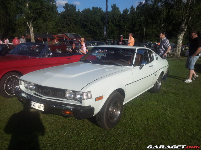

An old Celica!

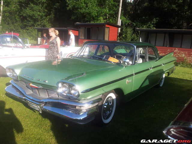

Edsel Ranger

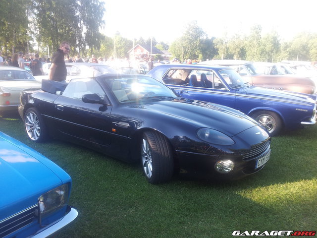

Aston Martin DB7

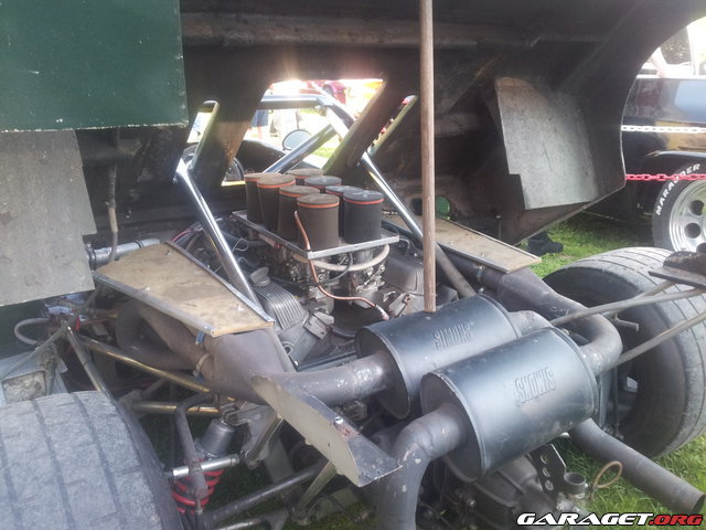

Some old race car

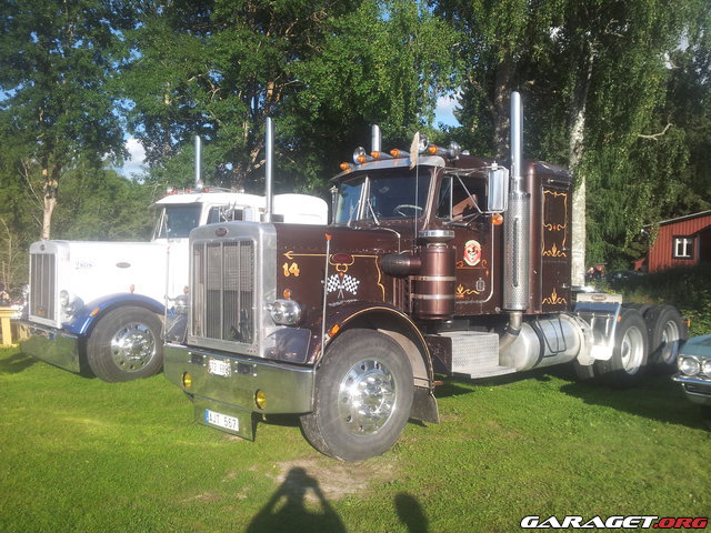

Peterbilts
An INCREDIBLY nice Volvo F88! Fabulous! Every single part was just absolutley perfect!

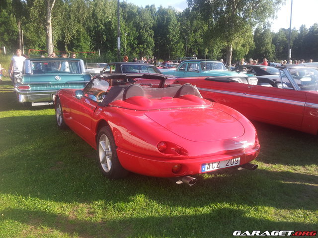

And lastly, if you know what this is I will give you a cookie!
Hint, it's a Swedish sportscar!
That was a nice warmup for Power Big Meet that starts on wednesday. If you don't know what it is, it's one of the worlds biggest car meetings. In my town of 130k residents there's about 14 thousand american cars. Best weekend of the year ;)
