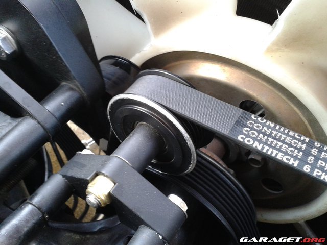

6 rib belt leaves room for the fan...
Can hear the surge at idle.  You may find "clocking" the MAF (or rotating it in small increments to get the sensor in "clean" air) will clean that up.

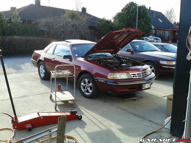

Anyways, here she is outside the garage
And a picture of me tuning it, trying to get it to work

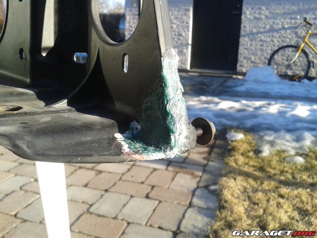

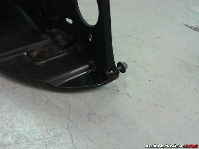

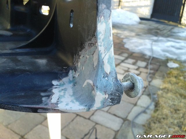

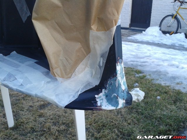

The front broke off in the corner a few years ago and we glued it back together and it worked over the summer but when I removed the front clip it broke off again. So me and my dad took some fiberglass bondo to put it back together. Seems to work, really steady now!
Before sanding
After around 5 minutes of work
With this little  :)
Some masking
And some paint
Good enough for something that's never gonna be seen anyways

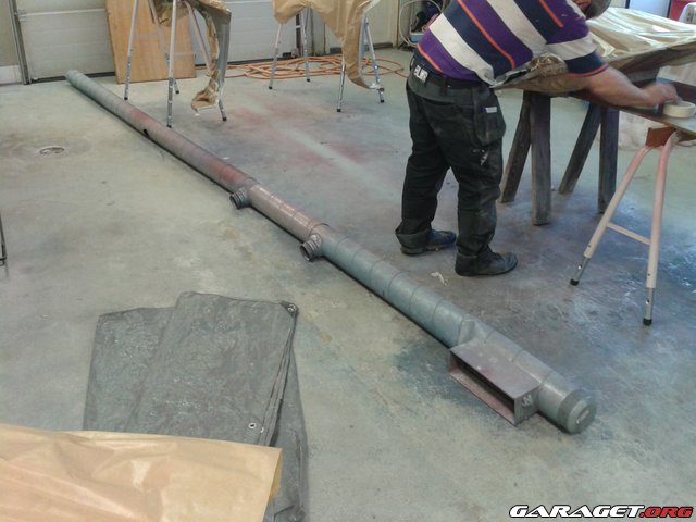

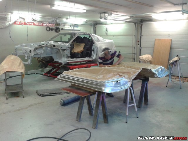

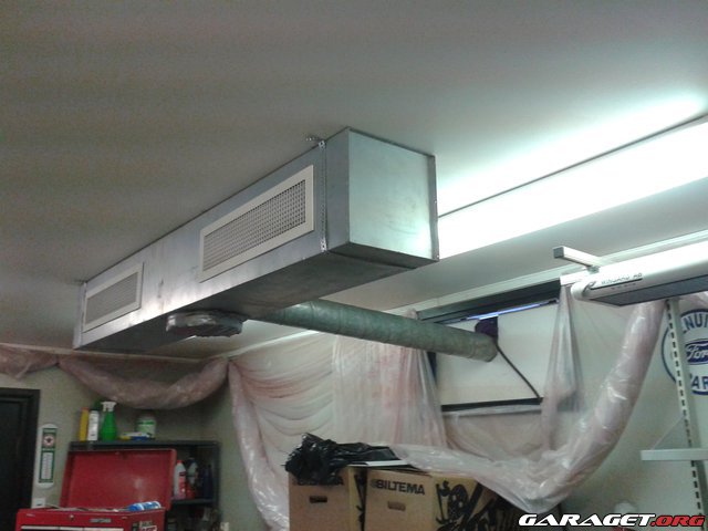

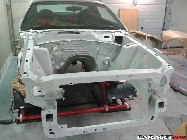

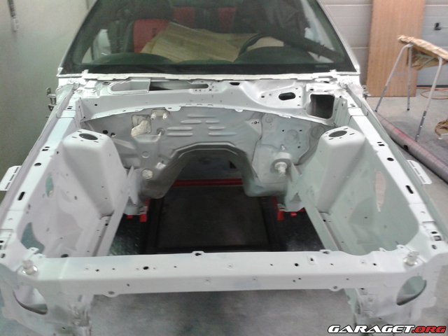

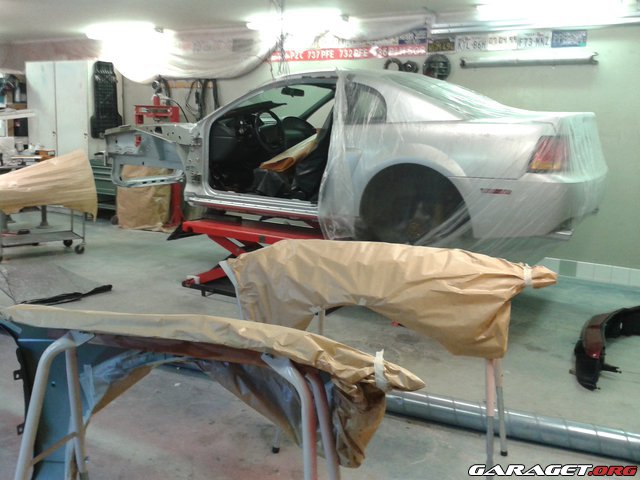

I have to work outside because my dad has temporarly (or permanently? ;) ) kicked me out of the garage because he's gonna paint the engine bay and underside of the doors (bady painted under the doors from the factory).
Also our little device for turning our garage into a paint booth. The one in the ceiling is the filtered intake and the thing on the floor is for drawing it out. All of the work benches and so on is covered by all the plastic you see hanging around on the walls.
The thing that sucks the air out
Does it work? Well my T-bird is painted in that garage with those stuff so you be the judge :)

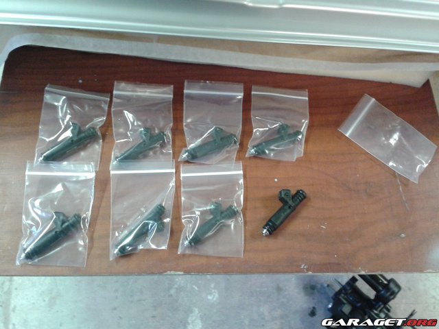

I recieved these!

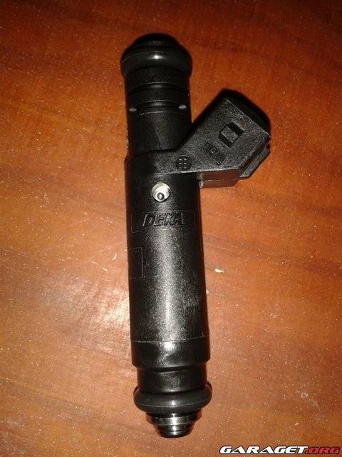

Mmm, Siemens Deka 60lb

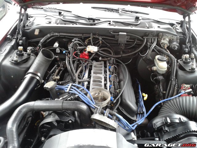

And the intake went off!
Today I installed the injectors, put the intake back on and with some fix in the tune for the new injectors, guess what?
IT WORKS! With some work on the tune, it actually idles well, goes abit on the fat side when I give it some gas but that's no worries.
I even took it for a test drive! Nothing fancy, it just works!
Hangs on the throttle abit and I think the MAF table is wrong.
Other than that, some few tweaks to it and it's actually driveable!

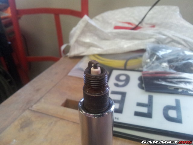

I thought I'd set the plug gap just to see if I could get rid of the problems.
My friend had set the plug gap to 0.028 earlier but I noticed that a few of the plugs were down to 0.018 (!!!)
So I set them all to 0.033, spotless! I didn't revv it like a madman, only to 4.5-5k RPM, nothing of what my ears could catch.
So the tuning can now continue! :)
And people, I suck at reading plugs (I'm from the wrong generation :D), how do these look? All of them looked like this

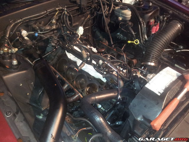

Bad news. Well, I'll show you with pictures.

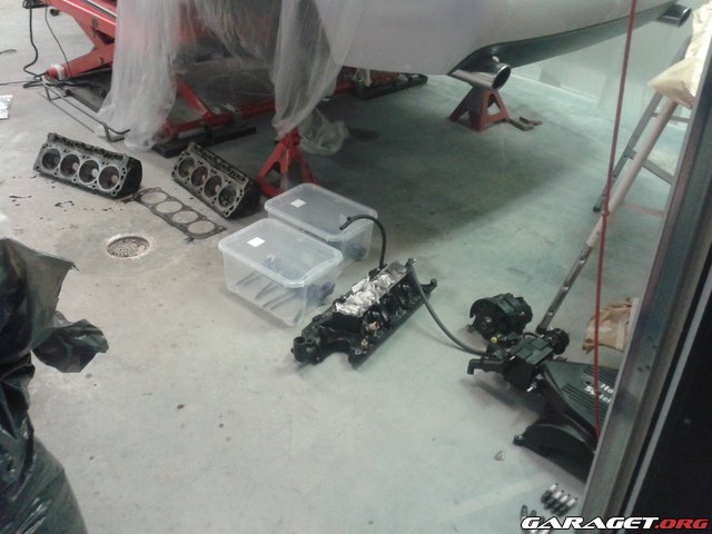

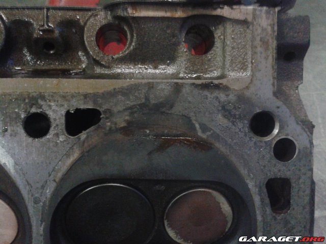

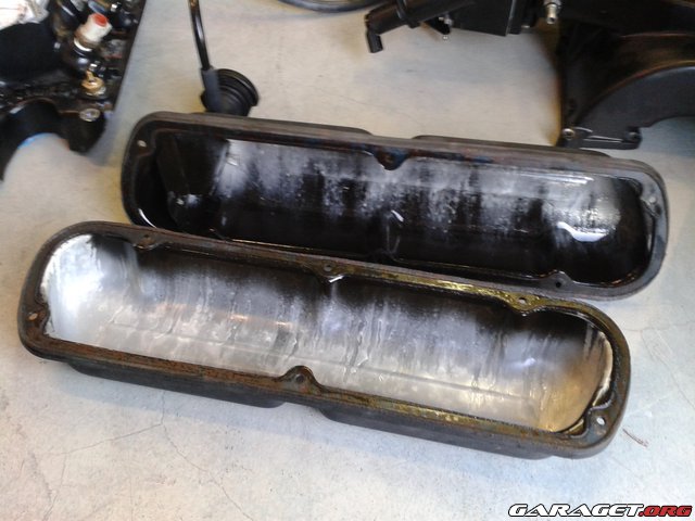

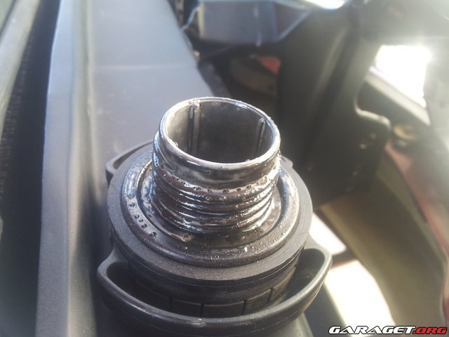

Hmm... Milk
A fine weather for investigation!

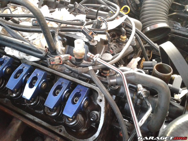

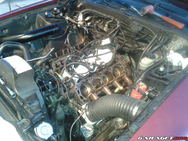

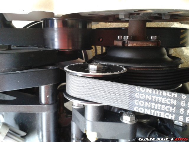

I thought the Procharger idler pulley looked abit weak, and so it was. It has been flexing, hitting the waterpump pulley

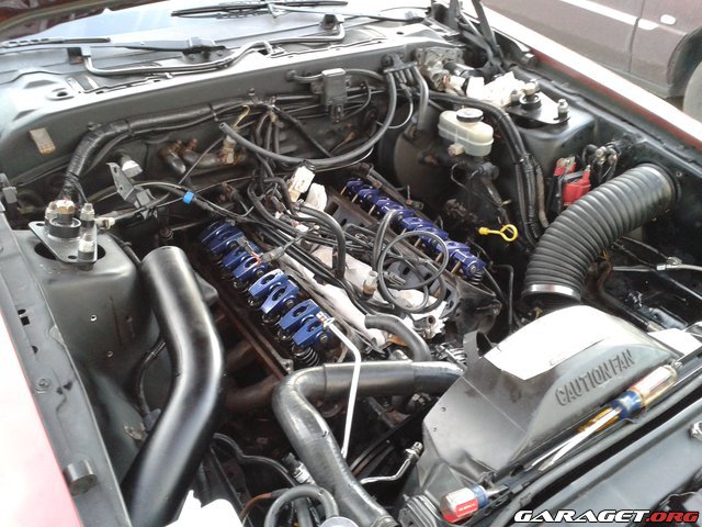

Valve cover off!
Yup, my car is officially a cow!
Well hello there beautiful ;)
Now there's your problem!
Hall of shame underneath/next to dads Cobra
And how she sits now :)
Not bad day. I got to sleep half of the day, tune the car, break it and tear it apart! All in one day :)

 headgaskets, looks like its well under control though!

Headgaskets suck! Instead we should just bolt the heads directly to the block ;)
86T-bird: Not at all! Only took me about half an hour of laughing about it until I started tearing her down.
The only problem I have now is that on monday I'm traveling to Shanghai for work for 2 months, and half of the cars engine is in pieces :D
But my father found some headgaskets in the garage, Fel-Pro 8548PT2 to be exact. So I'm trying to find out if they're anything to have on a boosted application, if so I'm gonna have it back together and running on friday!
But I need a bigger supercharger pulley. 12psi at 4500rpm was way too much boost. And I already have a huge 3.75" on it! 86T-bird do you perhaps have a bigger sized pulley?

A 3.75" pulley is pretty small!  Particularly on a small engine with a modest intake & exhaust tract.  I have a new 4" if you are interested, but I'd suggest at least 4.25" to slow that thing down!
As far as headgaskets go, it may make sense to use a piece which is not as sturdy as an MLS or other units which are boost friendly applications.  The headgasket will then act as a "fuse" to keep other, more serious damage from taking place.
With a stock block (don't you have a stock S/O short block too?), you should be limiting boost to 8 PSI.  My P600B only put out 9 PSI and made between 475-485 to the wheel (closed & open exhuast).  That was enough to have chunks of block casting show up on the drain plugs, which resulted in the current project using an A4 block and forged rotating assembly as a base.
Sorry to hear you'll be away from it for a couple months.  The tear downs always go really fast, but reassembly is a much slower process, particularly when there's a time gap.
Hope you have good luck getting it back up running and sorted out!
PM if you're interested in the pulley, but even with a 4", you'll probably be limited to 5,000 RPM.
