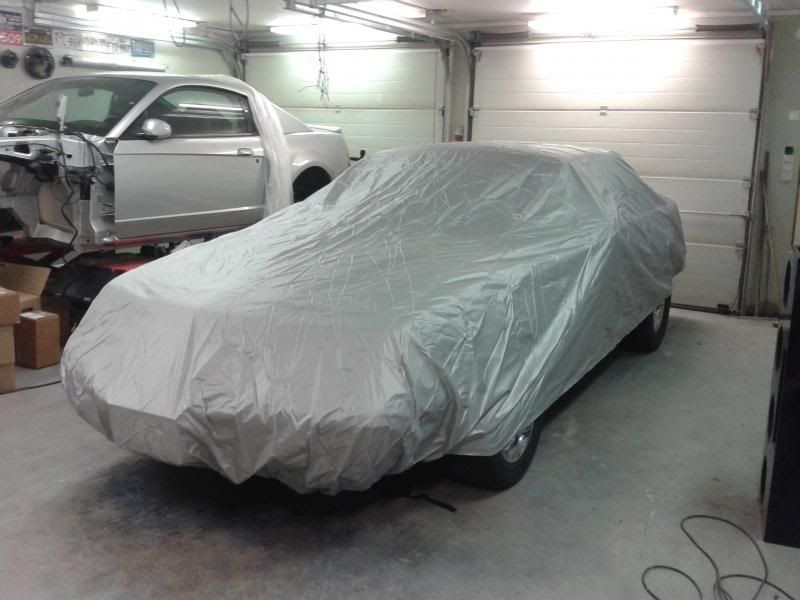

So, tomorrow I'm going away to China for work for a few months so I did one last thing to the T-bird, took the SC belt off and wiggled on the crank pulley, it's loose.
I check the bolts, they're loose! I can screw them by hand!!!
Tighten them, start her up, no knocking! But I do believe the wobbling pulley has ruined the damper but that is an easy fix. It's shaking a lot at 900-1000RPM. Flawless any other RPMs.
So I started her up, drove her in to the garage and put a cover over her and now she's going to sit like that for a few months.
