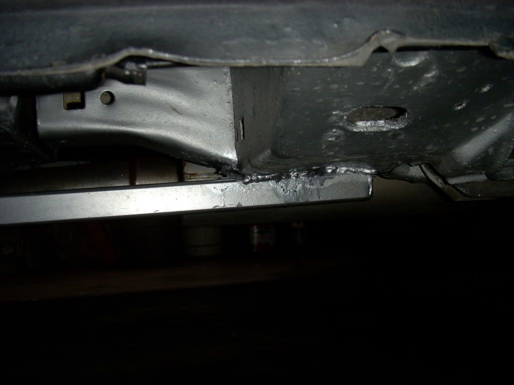

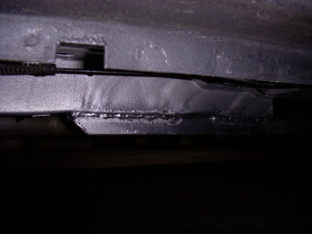

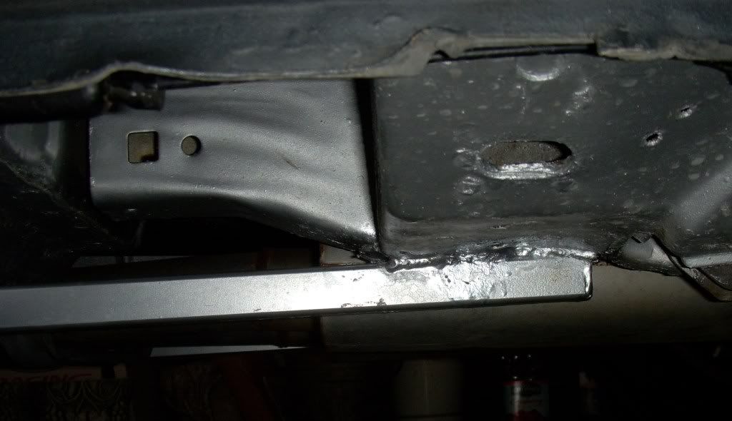

All you need is some channel and flat steel.  The channel needs to be as wide as you subframe and about 1 inch high.  Clean the subframe, lay the channel flat and tack on, lay flat steel to the side and weld solid.  The one they made for me is a bit narrow and it made welding a bit harder but it worked.  This may reduce you ground clearence slightly but it never been a problem for me, my exhaust is still a bit lower.
I'm sure that thunderjet302 will post pictures that will put mine to shame.  But this sure did make things a lot stronger and everything better, even shutting the door is solid.

Here are the pretty pictures;).
You need subframe connectors
Thanks for the pictures.  Maybe you don't need the flat plate on the side but I think it makes it a bit stronger.
