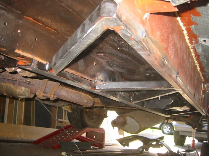

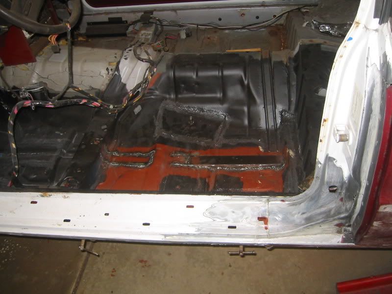

Quote from: thewestie;357186
That looks easier than I thought. I was looking at a through the floor set up I might go that route. Anyone have pics of through the floor subframes?
You need subframe connectors
Now Ill be a pain in the ass. Do you have a pic at the rear subframe at where it goes through the floor?
Now those are real sub-frame connectors and overkill in my opinion.  Would be better for road racing than drag racing, and what you need if you plan to cut off the top.  Also great for side impact from a low rider.

Someday Id like to road race in something like a street GT class as well as a trip to the strip. I'm 6'6" 300 lbs. I don't want to go much below 11.49 If the car needs monkey bars Ill never fit I look funny getting in and out now.

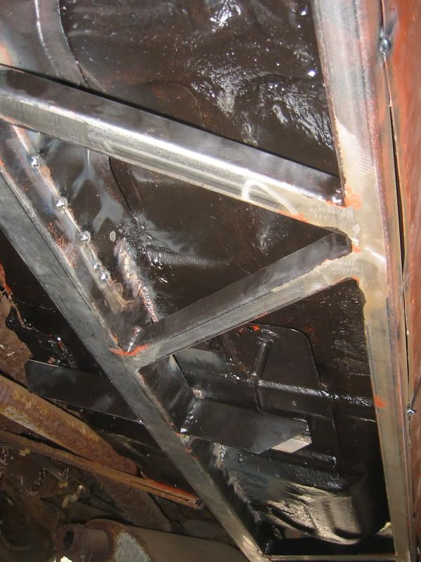

Quote from: thewestie;357205
something like this? or a diff angle?

Quote from: daminc;357214
So I got a 12' piece of 2"x2" 1/8" stock Iv got the fuel lines and brake line out of the way getting read to cut it to 5' 6" and make the front cut. I cant tell from the pics how far back on the rear subframe you went or how high you went on the floor pan? any more pics would be great.

Quote from: thewestie;357293
Thanks Steve
I will find more for you tonight.... hold tight, I have over 3000 pics of the car now....lol
