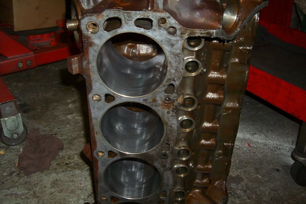

I got my block back from my friend today. He did a great job, all of the cylinders are within a .0005 of each other. I still haven't polished my crank to see if its going standard. My rods are good. I might be able to build my short block this week. I still need to install the cam bearings, freeze plugs, and hang my pistons on the rods. I took pictures today but I forgot my camera at the shop. I'll post some pics tomorrow.

I loaded some pictures today.
My block.

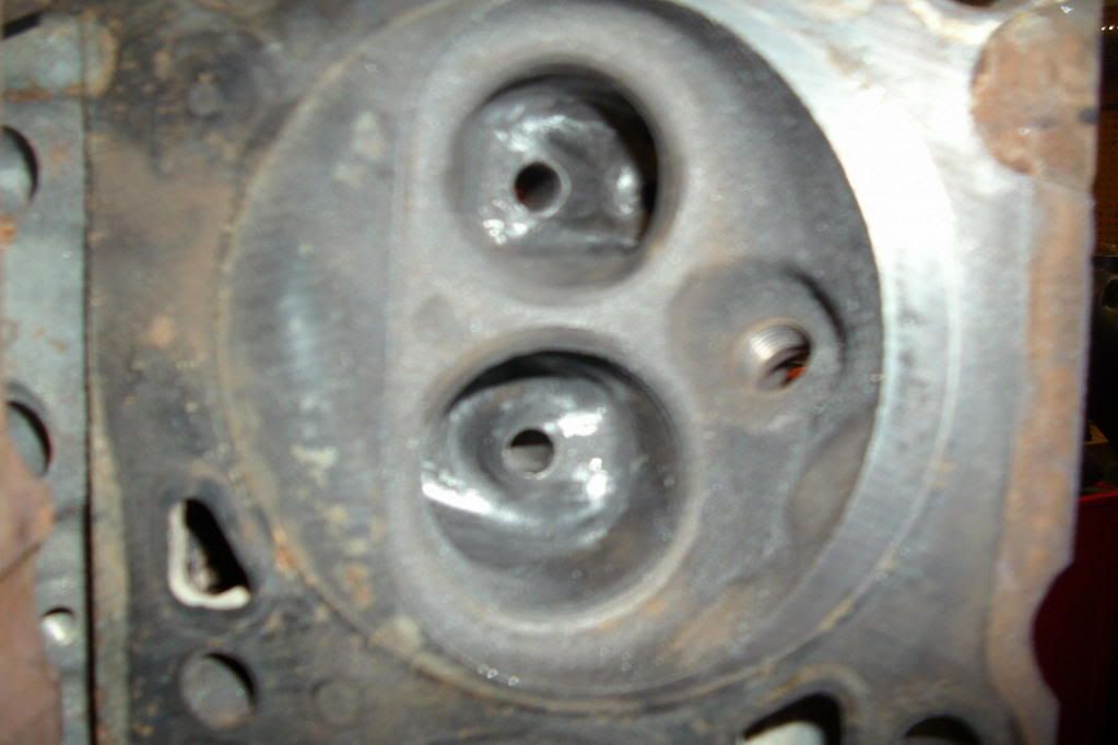

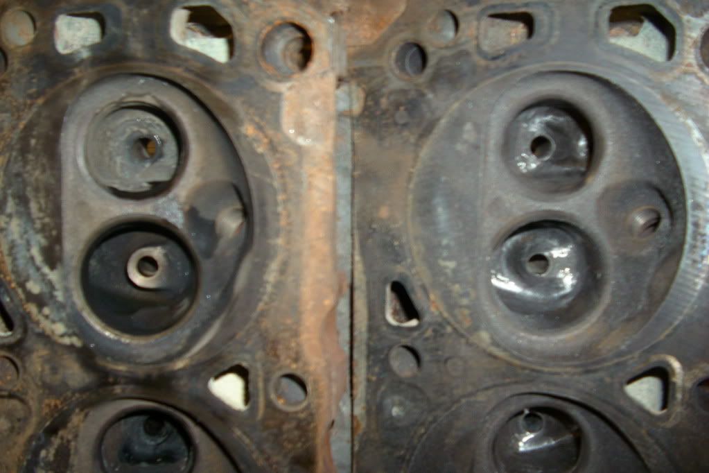

Here's some of the rough cut pics of the port job.

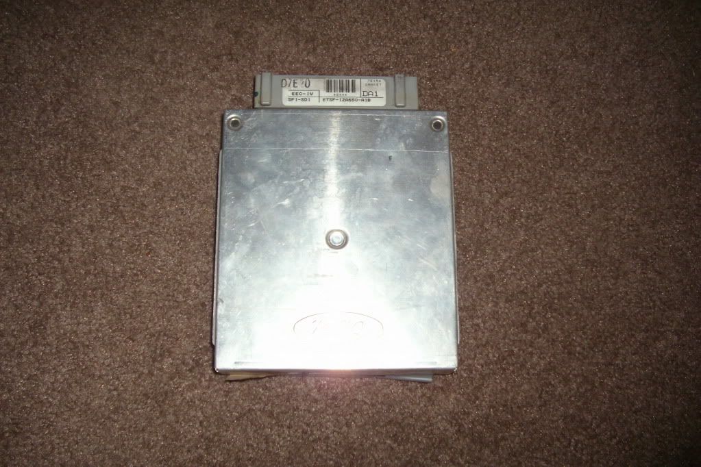

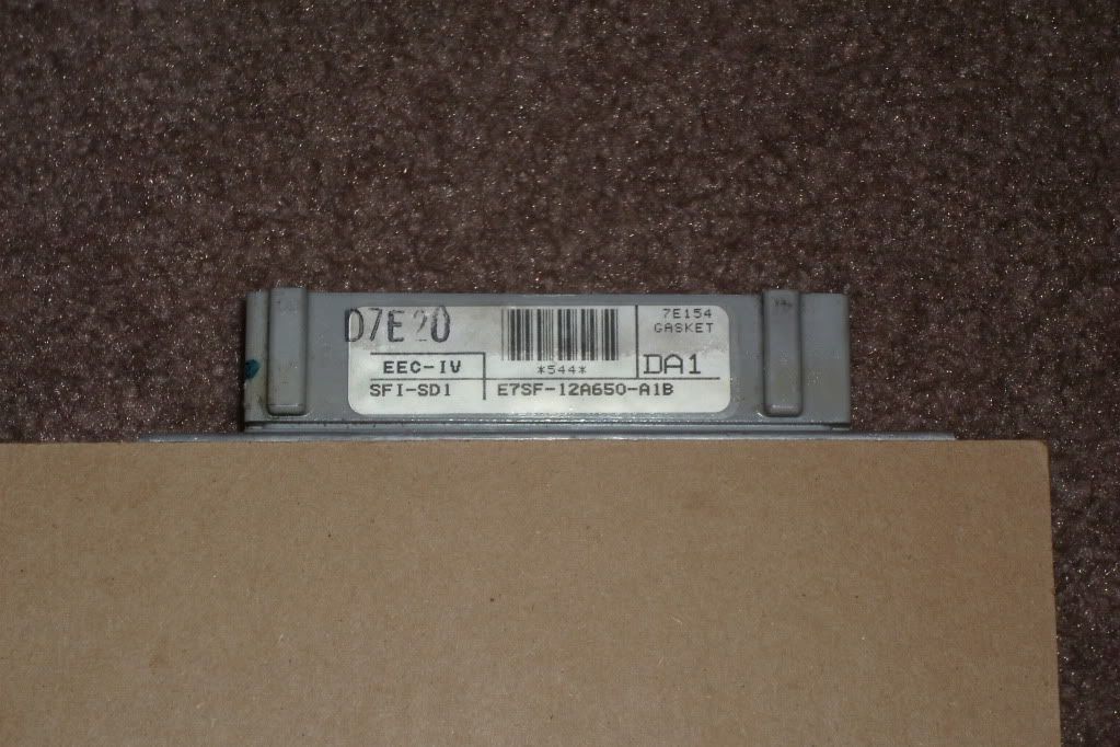

I got my computer today. $50
Does anyone know if this is the right one? It says DA1 but there is a sticker on the bake that says 3.0 taurus. Its the warrenty sticker. I think they might have put it on so that they could keep the warrenty. I can tell its not the original cause I can see old glue from the old sticker.
