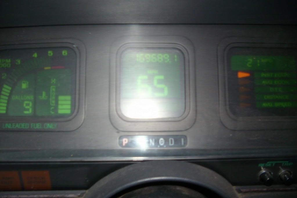

I changed the timing chain, it wasn't that bad, took about five hours. It idles and cruises alot smoother. It doesn't spark knock anymore. But the fuel mileage still hasn't come up where it was when I bought it. At 65 mph im turning about 1600 rpm and its getting 21mpg. When I bought it it got 28mpg. I don't knoe the average mpg yet.

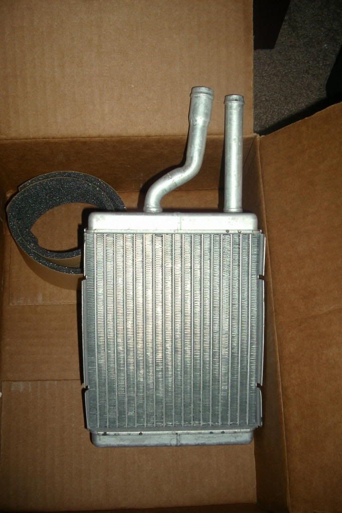

I got a heater core for the Cougar today. On the box it says that its for a 79-93 Mustang, 79-88 Capri, 80-88 T-brid, and 80-85 Cougar. I could be wrong but I thought that the T-bird and Cougars were the same from 80-88. Why does the box say that its only good for 80-85 Cougars? Is the box wrong? I'll post pictures soon.

Does this look like the right one?
BM's 88 Cougar build
It looks like the same one I put in my car several years ago.  If its for a 80-88 'bird, it will fit your car.
Thats what I thought. I dont know why the box says 80-85 Cougar.
Thank you.
It's the correct one.  Throw it in.
