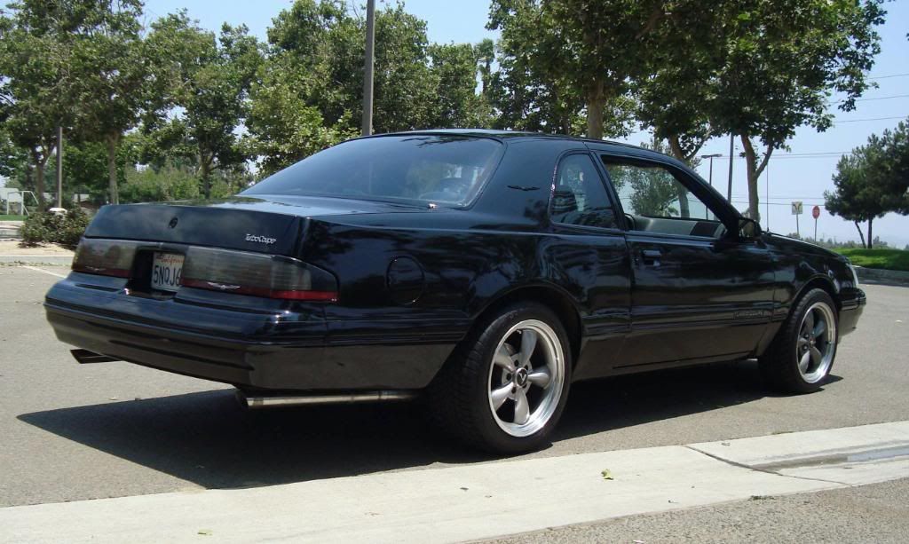

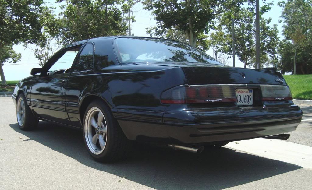

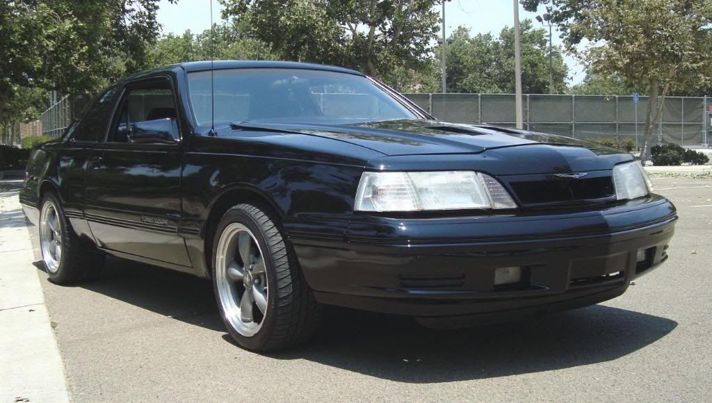

Check her out!! Painted and running. Love the 17X10.5 in rear. What ya think?
Car: slightly flared rear fenders, netted head rest, custom header panel for IC, big body damage hole GONE! Stinger dual exhaust and DP with ATR lers, 3" catco cat, 5 lug conversion, Mustang Bullits 01 stock in front and 17X10.5 in rear

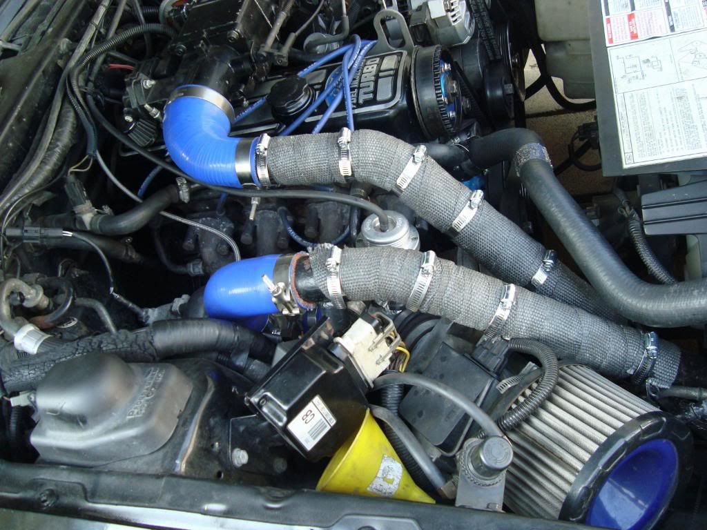

Motor Pics: 65mm TB and custom spacer, gutted upper, profiled lower, phenolic spacers in upper and lower intake, FMS IC, forge bpv, Hybrid T3/T4 .57 trim stage 3, boblog, relocated TFI, RR cam, round tooth gears,3.8 IAC, maddadder valve cover

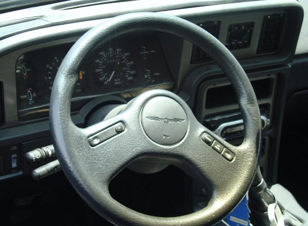

Last of my FMS 140 speedos

Looks great:D I'm guessing you used the base/LX header panel to increase airflow to the front mount intercooler?

Quote from: thunderjet302;278336
Yep. I was gonna add mesh or a floating ford logo in grille area, but its time to work on mine now.

Nice looking car!. 10.5 rears? custom offset, they don't look like 10.5s....

Definetly needs the 97 floating bird in the center and the upper bird removed,possibly some mesh(not sure though.
Otherwise,lookin good.

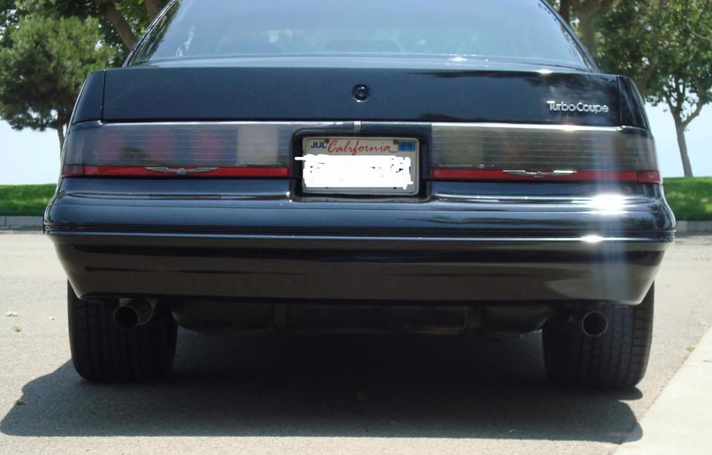

Quote from: 88turbo;278344
are those the tails that stinger and I mocked up for you?
Yes, I finally had a chance to install them. I slant cut them to give them that mustang GT exhaust look. Gonna send you and stinger a PM on install. friggin nightmare!

Finished Sons Turbo TC!! Pics!!
how were they a nightmare? mine went in without a fight... I took the shocks loose and the wheel off since I was doing them on the ground.
Quote from: 88turbo;278380
For some reason the passenger side tail pipe was not clearing the axel or the rear control arm. I had to cut the heck out of it and beat on the bracket that holds the tank in place to make it fit. The other side was not so bad, but I stil had to cut that side to so that the piping would clear the axel and control arm. Definetly not a plug and play. Cost me $$ in added time to get it adjusted right. Should have come with instructions or at least a picture layout fro whoever installs.

Quote from: shame302;278345
They sure are every bit 10.5". I shaved 3/16 additional from the backspacing to bring them in more. I also had to remove that secondary shock. My wheels didnt move outward with the 5 lug swap because I didnt use lincoln axels. I took my stock axels and modded them to 5 lug so that I would not loose my ebrake.
