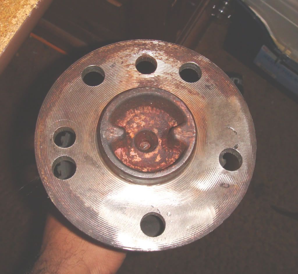

They sure are every bit 10.5". I shaved 3/16 additional from the backspacing to bring them in more. I also had to remove that secondary shock. My wheels didnt move outward with the 5 lug swap because I didnt use lincoln axels. I took my stock axels and modded them to 5 lug so that I would not loose my ebrake.
You drilled new holes and put studs in?
Finished Sons Turbo TC!! Pics!!
Quote from: jcassity;278398
yep. I sealed them and redrilled them. Then I just took stock rotors and had them drilled to 5 lug too(didnt seal those though, just redrilled them)
Heres a pic..
http://i158.photobucket.com/albums/t97/biggrgivens/parts%204%20sale/5lugTCreara.jpg
