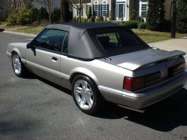

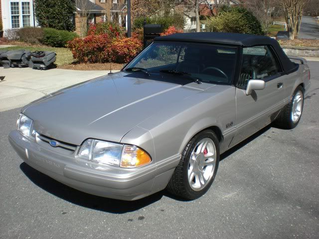

Wow..... that paint looks nice. Got some pics of the rest of the car?
X2 Great paint.

It is a 1992 Mustang Convertible in Titanium Frost...

Reply #583
Sharp car!!

Reply #584
Super sharp 'stang Shredder. Understated and squeaky clean. Very very nice.
