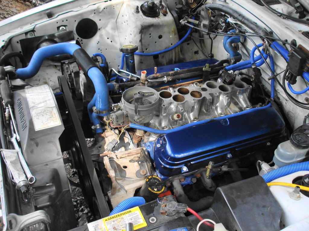

gone! I think the line going into the evaporator in the heater box has a crack in it, so I got rid of the AC.
the cougar is DONE!!!!.... HO/E303/MAS/T5 conversion complete. Drive Video added
Should have just changed out the evap,3.0h job to be sure but well worth it with the humidity in ontario.

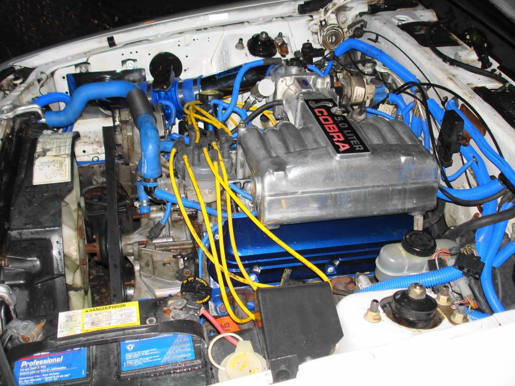

Looks great so far RJ. You going to modify the baffle for your cobra intake, or just try to find an explorer lower?
It's Gumby's fault.
just got done making a baffle for it... THANKS Kitzdnm!  I went to my parents place and printed out the template off of T Moss' site...
now I am just waiting for a buddy to get off work so I can go grab a set of 19lb'ers off of him, then I gotta figure out the wiring...  Where is the info for wiring up the MAS?

AAAAAAARRRRRRRRGGGGGH !!!!!!! Sorry for the delay.I JUST read all the posts.Man,I've been slacking....a LOT !! My E303 is working great,lumpy idle (has scared off a few potential races),and I've had ZERO interference with my pistons (flat tops).I've had the car to at least 6,ooo rpm's with no worries.(I need a factory tach that goes to 8,000).Anyway,I have the E-303,works great,and the Mass Air ,well,it's all in the signature.No worries at all.Go ahead and get it done and don't lose any sleep over it.Next up,my 5 speed.HOPEFULLY the pedal assembly will be in saturday.Any work I do I'll take pics.I haven't had the time and or weather to do anything.Saturday will be the start I hope.

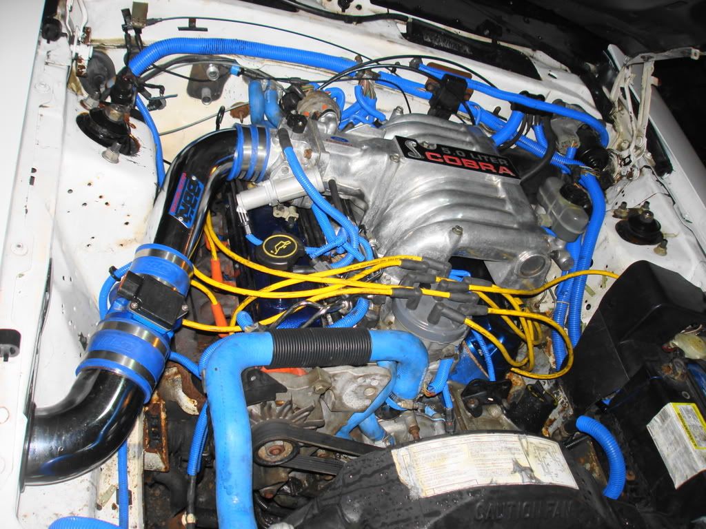

DOH!!  I was looking at an old version I printed...  thanks....  now one more quick question...
I dont have those colors (except the red one) in my MAS harness, so I am going to assume that they are in order from the red one going from right to left?....  my next wire is yellow/black stripe, (ground) then yellow/white stripe,(MAF signal ground) then yellow/Red stripe (MAF signal)...  I took the harness from my old '89 3.8L SC XR-7 harness...

Quote from: 32VFoxBird;227703
what ecm are you using?
A9L
Edit:
Just came in from working on it... 12:33am...
only thing left to do is change the oil, and wire up the MAS, then hit the key and hope it starts...  should have it up and running in the morning....
