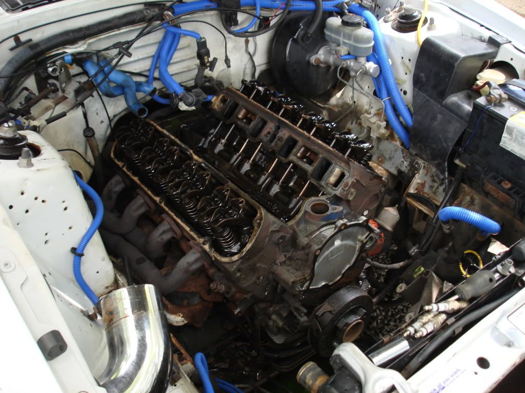

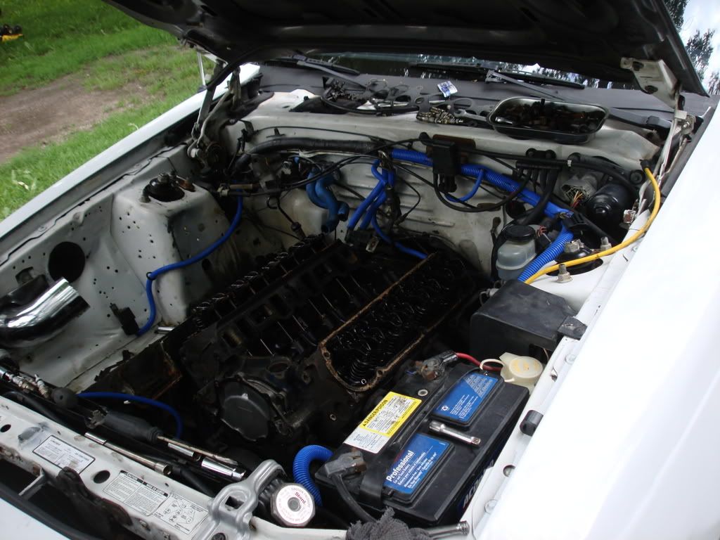

and started the HO/E303/mass air conversion today.  here is the progress after 1.5 hours:

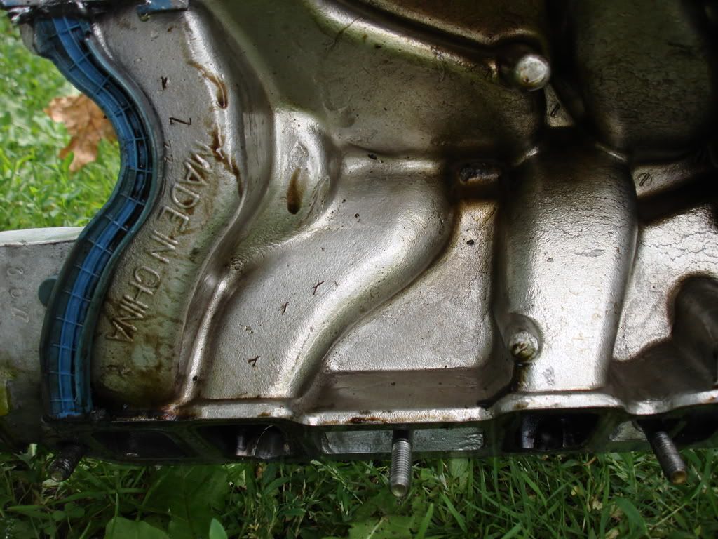

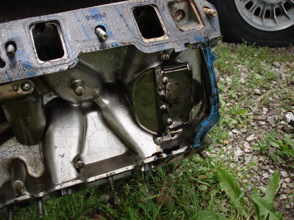

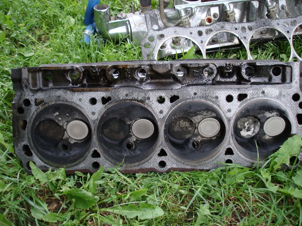

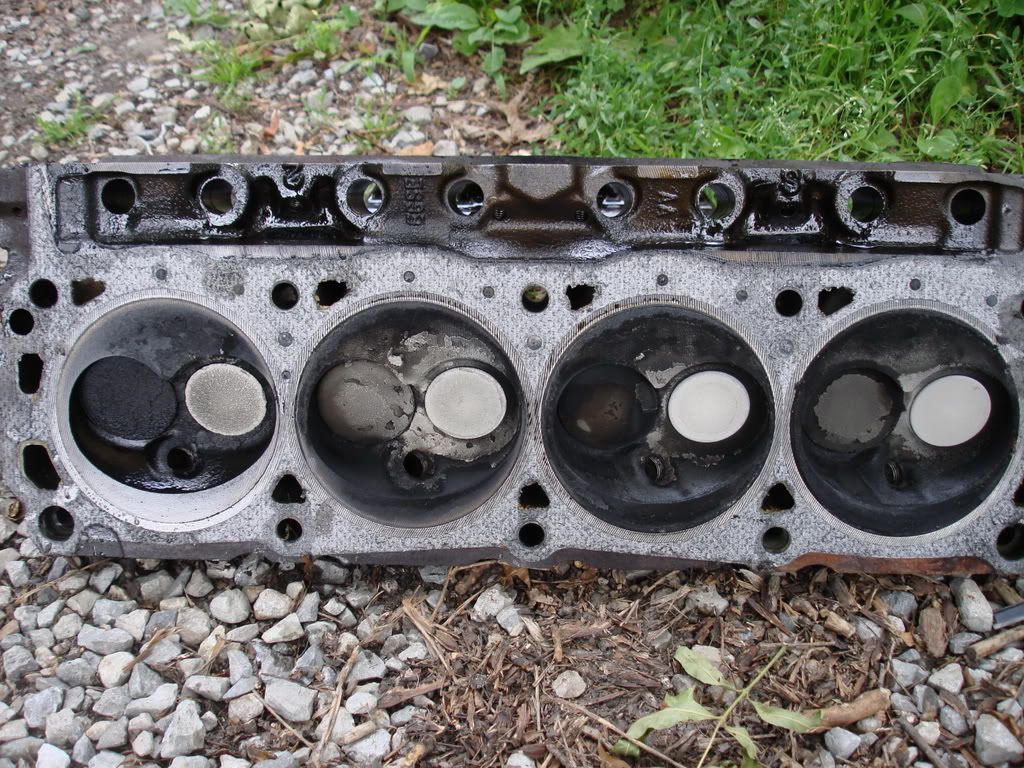

Here is a pic of the baffle that is causing the oil burning issue.  I seen some people give me a funny look when I triied explaining the issue to them:
DO NOT buy a cheap chinese intake!  uless you like having a motor that burns as much oil as gas....

Tom moss has the pattern for downloading the larger baffle,on his web sight.But I do believe your goin a different route.
the cougar is DONE!!!!.... HO/E303/MAS/T5 conversion complete. Drive Video added
Quote from: kitzdnm;227357
No Im not actually, could you send me the link for it?

I just got done opening up the cambers in the heads and removing the ERG hump from the exhaust ports, and putting some colour on them.
I am done for the day, gotta get a Balancer puller tonight and finish the tear down in the morning.

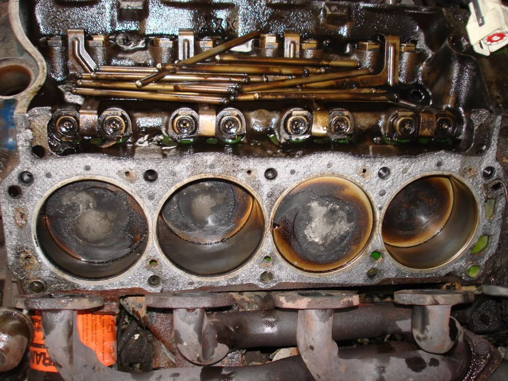

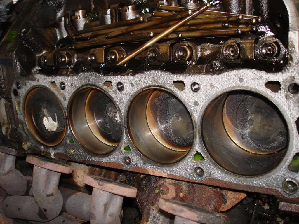

Im actually impressed at the condition of the motor inside.  with over 200miles there is no feelable wear on the cylinder walls, and you can still see the cross hatch in them...

Can I have the Cobra intake?The upper alone will be fine.You don't need that Chinese made .LOL.

and vinne, the upper is the only good part about it....  the lower is what the  chinese screwed up on...

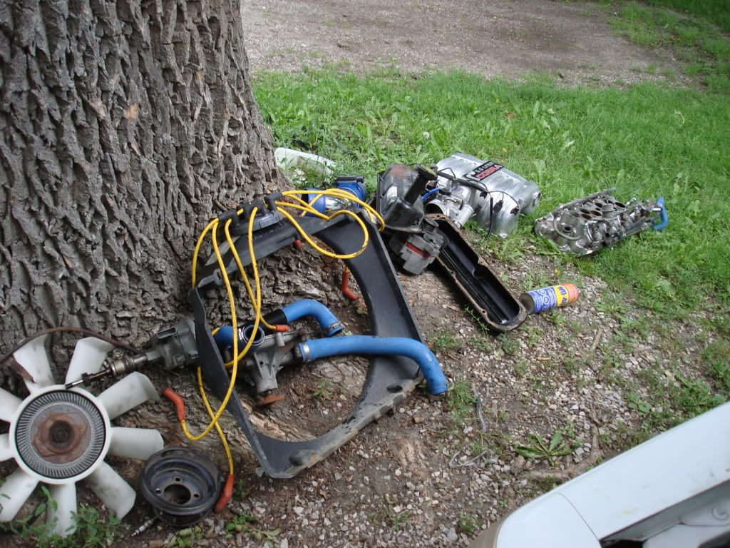

total disassembly is done, cam is out and waiting for morning to clean all the gasket surfaces and start slapping it back together....
haha Mine may be a knock off but it still works, lol.... I will just make a better baffle for it.
