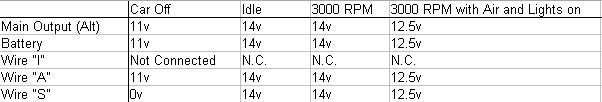

Thunderchicken, this graph is in direct response to your post. I ran a bunch of tests off the regulator plug, and here are the results. I should mention before I post this graph, that the wire coming out of the connector "I" was cut. So, obviously I was unable to achieve any readings from it.
Well, I think I know what you guys are going to say....connect the "I" wire, but I should mention that since I've owned this car, that wire has always been cut off, and I never encountered the problems I'm having now before.

Quote from: ThunderChicken
The wire that corresponds with "I" must have battery voltage WHEN THE IGNITION IS ON. This is the wire that turns the alternator on and off.
It can't hurt to try to connect it, can it?

Well here's the thing. If that black wire really is an excitor wire, why am I reading an output from the alternator? If it wasn't working, wouldn't I not read anything on the volt meter? And also, that wire's been cut since I've had the car, but nothing like this happened when I got it.
Also, if I do need to hook up that Black wire for some reason, where does it go? I know it's not the battery...
[COLOR="Red"]UPDATE![/COLOR] Ok, I just went outside and did some more tests. First I checked the Alternator output which was around 13v. I then jumped that "I" wire directly to hot and checked the Alternator output again. No change. Finally to be sure, I disconnected the Alternator, and checked it's output directly from the two plugs coming out of it. It was around 35v (Which also seemed kinda strange due to the fact that all I did was take off the stator connector and the volts spiked.....but anyway...) I ran a wire from that black "I" wire directly to 12v and again checked the output. It was the same. Now, I know you guys are saying that black wire tells the alternator to turn on and off, but from what I just did, I find that hard to believe.
BTW, now that I think about it, how is it even possible that I was reading 13v from the wires coming out of the Alternator, but when I took a reading directly from the terminals coming out of the Alternator, I got a reading of 35v?
