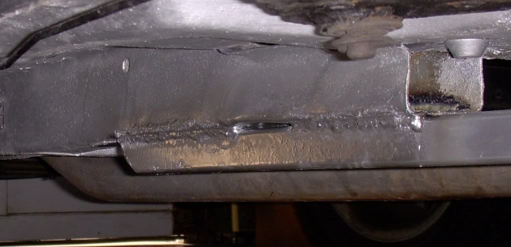

I made some based off of the global west connectors. I think for a street car these will do fine. If you are building an all out drag car or you want the stiffest chassis possible you may want to look at the thru the floor connectors.

I've just got 1"x2" square wall tubing as subframe connectors. It made the car noticeably more solid over bumps. It also corners much better as well.

thunderjet302,
 Can we see the rear section ?
I'm curious if you welded on the angle part of the torque box/jack plate area or directly on top of it.

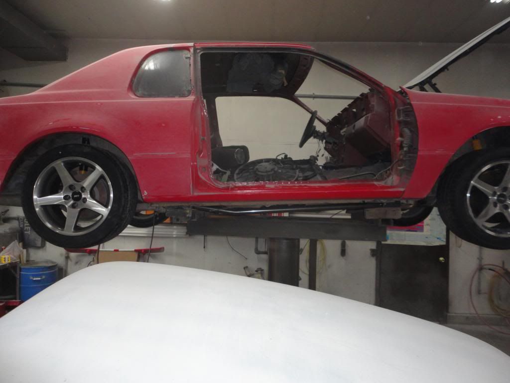

 One of the main reasons I'm interested in subframe connectors is the fact my car spends so much time on a lift (lol).
Here is the car on the outer 1" tubing.
The gaps around the door didn't change

Awesome design Daminc. How often do you get to see a Unibody car jacked up from the side like that so easily, lol.
You fab that yourself?

Quote from: Big B;411906
Yes, I made just about everything that went into my car, including the new front frame sections
If you jack it up just right I had 3 wheels up on mine.
