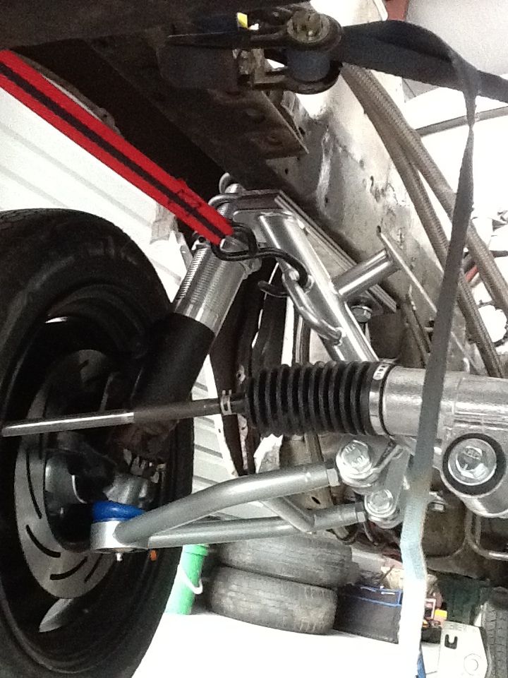

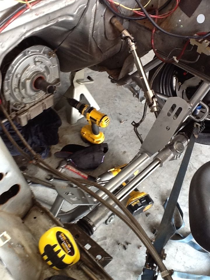

Thanks for all the well wishes and the fair winds. I'll take a few shots of the front end installed. I put it all together and mocked it up, still need to take it apart and, grease it all up, paint a few spots, grind a few and line it all up the best. The tubular K member is ridiculous light compared to the stocker. It must be close to 100 lbs difference in the front end with everything I have done to it. I bought a book on setting up stock and super stock suspensions and will try a few springs to get things ironed out, with less wheel stand and more go.
Resurrecting the Wicked Chicken!

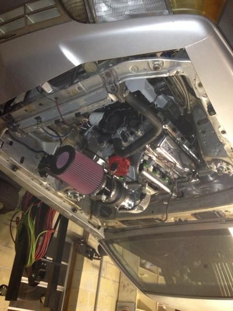

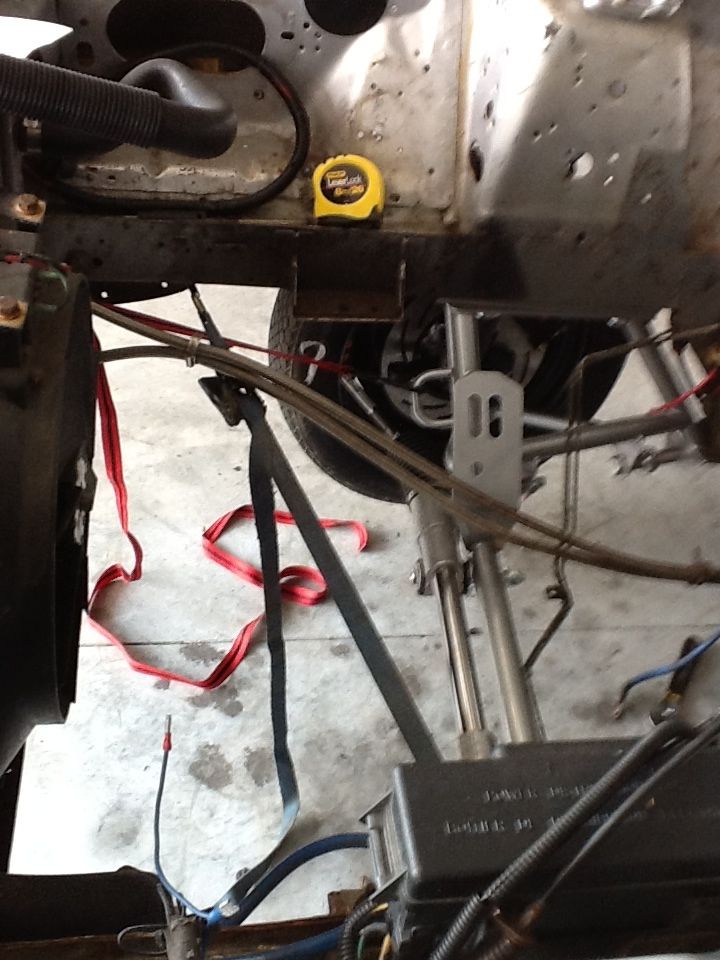

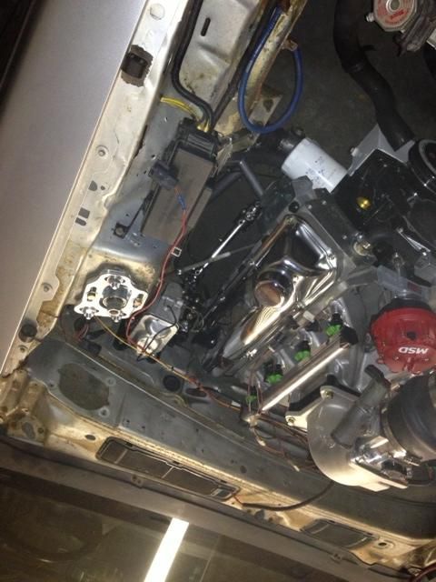

Got the k member, a arms, coil overs, manual rack and brakes installed. Upr makes some nice stuff and it almost fit correctly. I had to add almost 1/2 inch of steel plate to level it all out with the frame rails. I need to clean the wiring up a little better because it is looking bad besides being close to the headers.

Your front end set up is very close to mine. What springs are you using on the front? I bought a used coilover setup that came off a fox mustang and they are 150's. Still in the building stages, so I haven't tried them out yet.
150 should be good if you want to pull the wheels use 130 lol

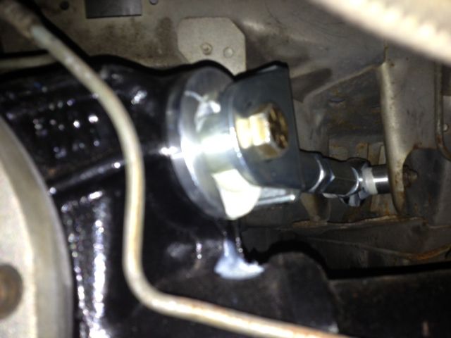

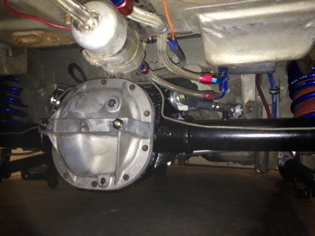

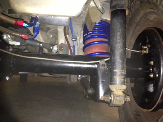

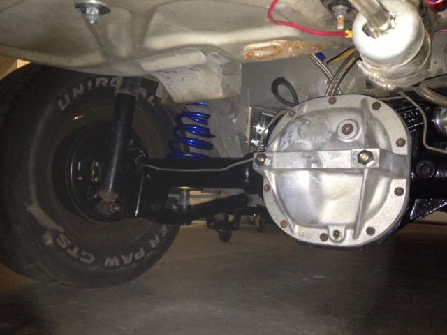

Got some work done this weekend. Rear end Rebuilt, Brakes Installed/Operable and Control Arms Mounted. Clevor and the tranny have been stabbed and it sits a bit high. Please let me know what you are thinking.
MotorBreath!!
Spherical Solid Aluminum Bushings and 1" longer (8.8" T-Bird or 9" in a Mustang) Adjustable Uppers from UPR

Any plans for torque box reinforcements ....
Quote from: STANG8U;409584
Sweet!!!!!!
I'm kinda Himing and Hawing on that. Car is stripped and will weigh <3000lbs. I hope that I can get it together and down the track a few times before requiring Torque Box Replacements.
It's a major week link at least weld them up once they rip the car is done or a lot of work needs to be done
