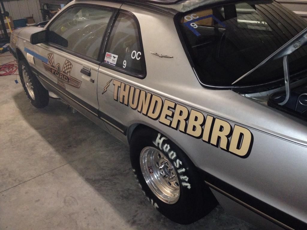

Well Christmas leave period was finally upon me and I had time to get a lot of stuff done. I'm now down to the last few things to do and off for some more chassis work, fire suppression system and the NHRA Chassis Cert. I will post a couple of pictures. I only have about 20 more wires to connect or run and to make some plug wires, load the computer, add fluids, double check everything and fire it up! I cannot wait! Maybe get some Dyno Time soon!! Added some decals too. It's starting to look good again!

Added the decal pic today, what's your thoughts? A little plagerizing from the Thunderbolt and add it to my T-Bird.

I like it!

So do I.  Looks mean!
