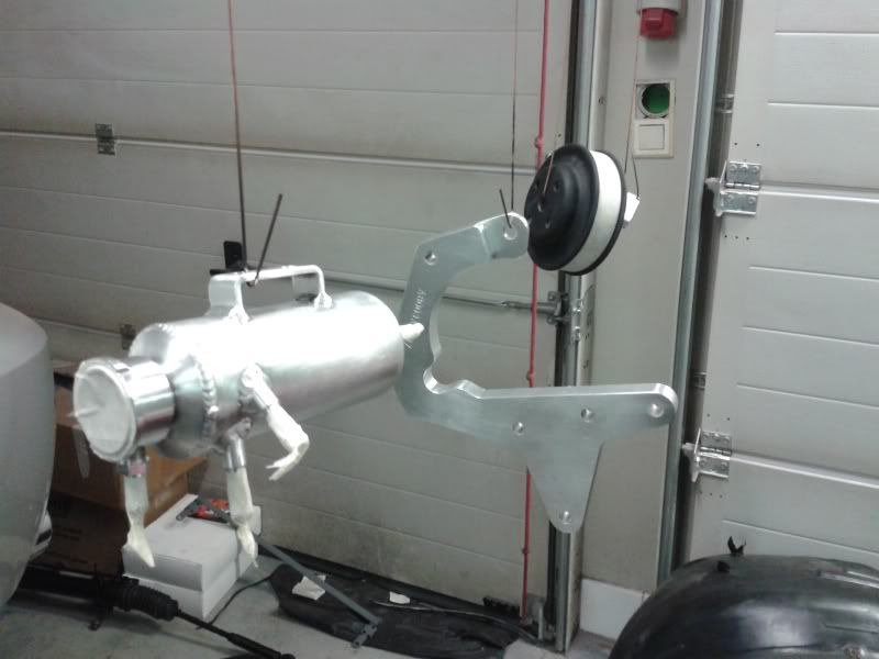

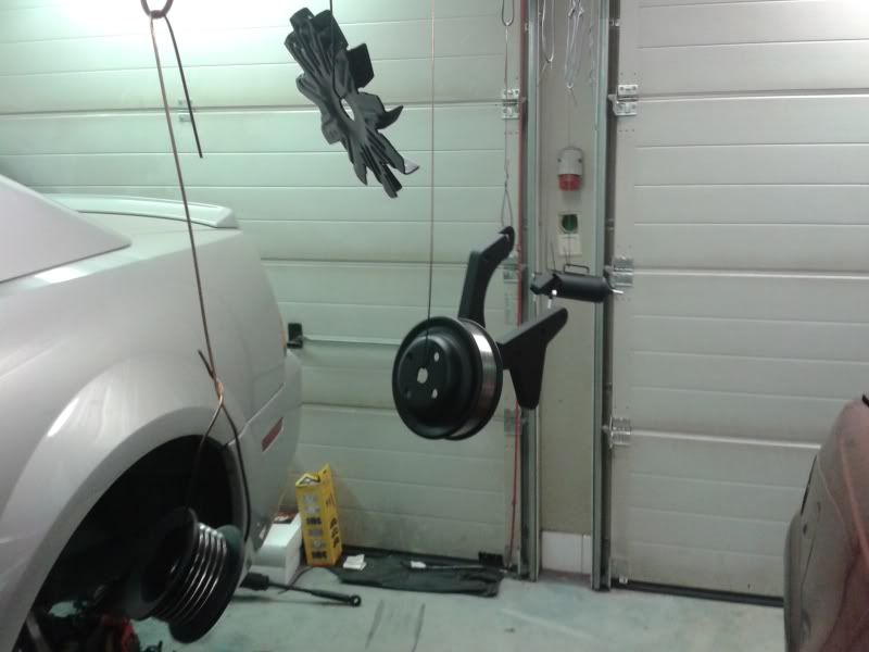

But here's a few progress pics.

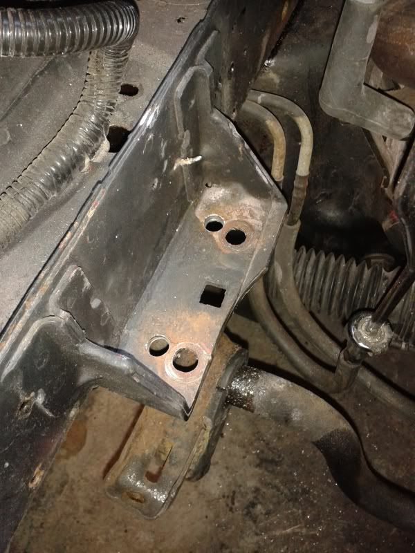

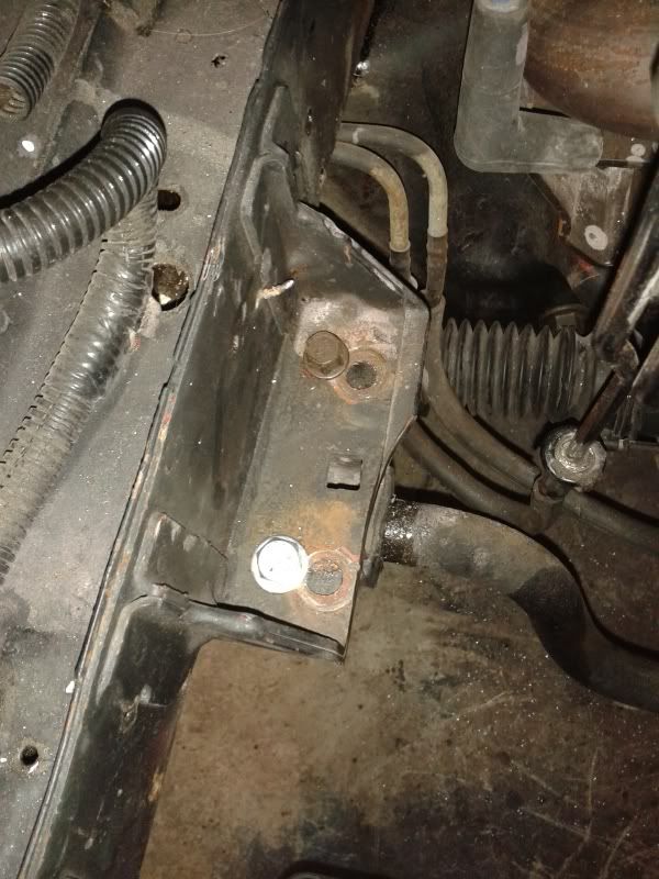

The Procharger P/S relocation bracket came very close to the mounting point for the sway bar so I decided to move the sway bar mounting holes inwards
And then the parts was prepared for paint

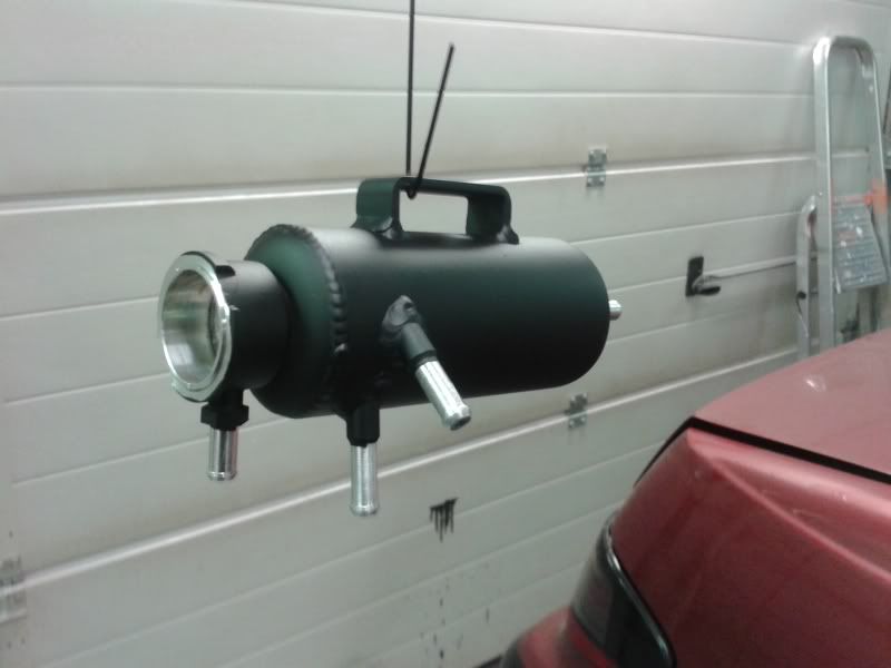

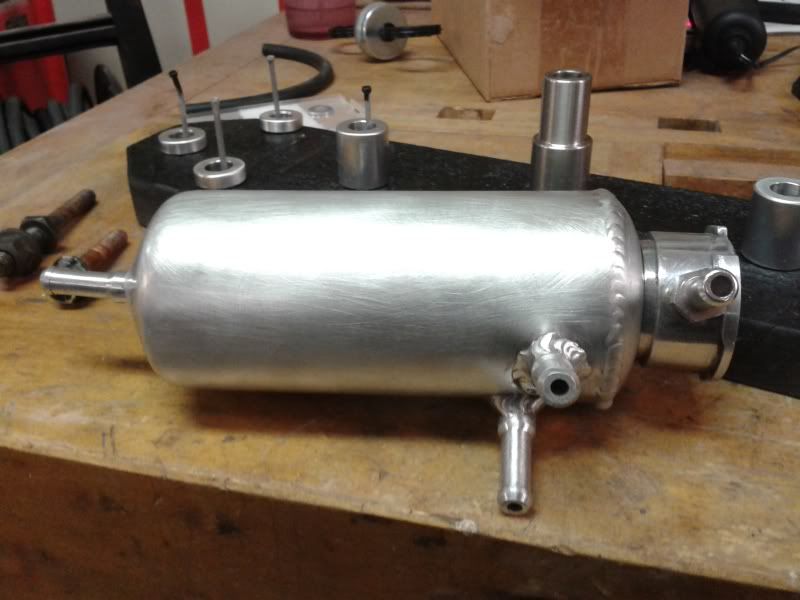

Shiny overflow tank doesn't stay shiny for long in my garage!
Tadaa!

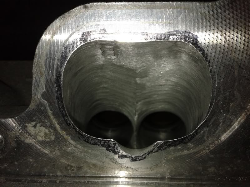

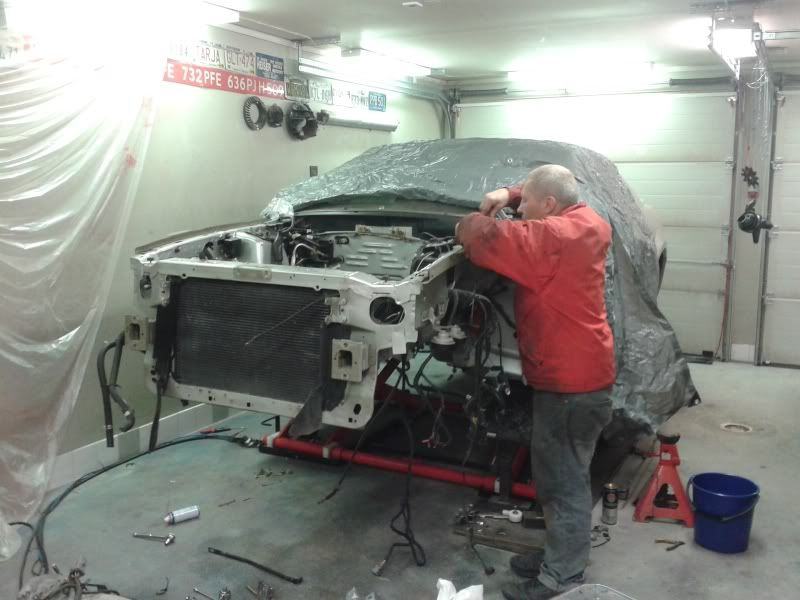

My father also got some of his Cobra stuff painted today
Some bonus pics of his work. Ported heads for the Cobra, lots of work with 4 valve heads.

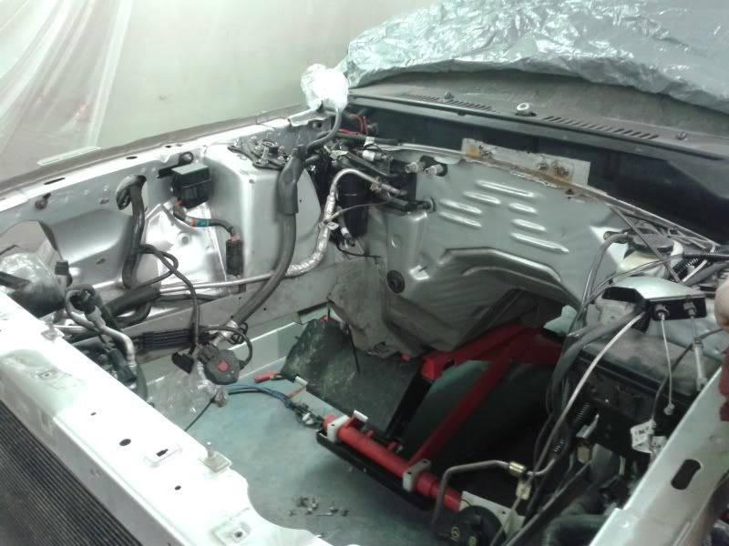

The old man himself taking apart the engine bay

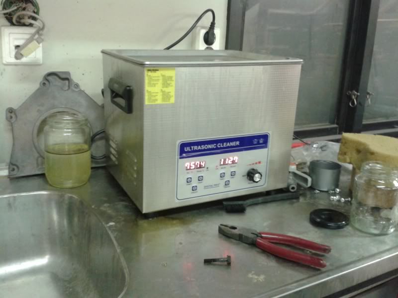

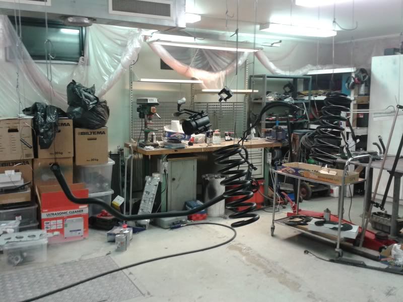

And he also bought a new toy for the garage, ultrasonic cleaner. Works great so far!

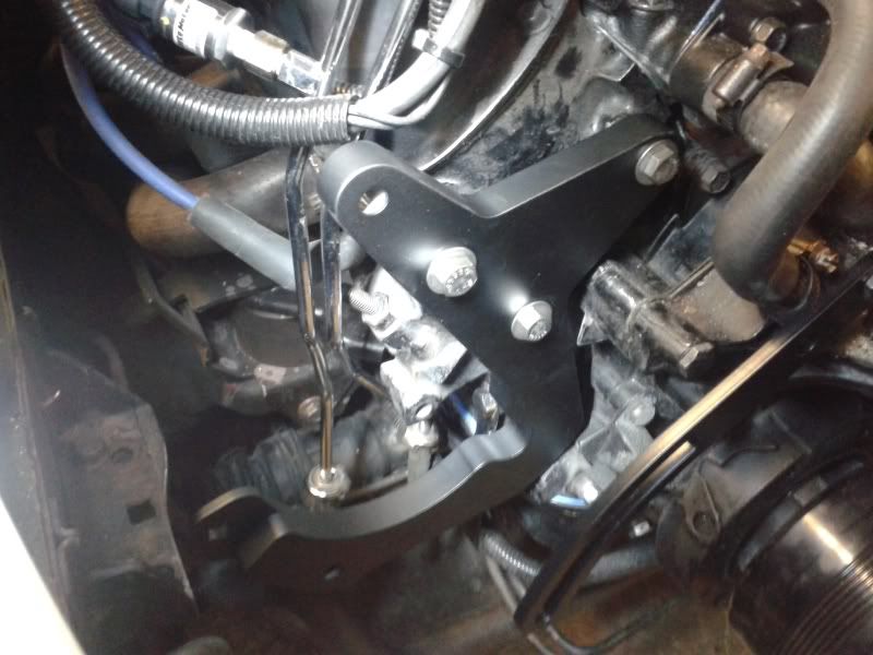

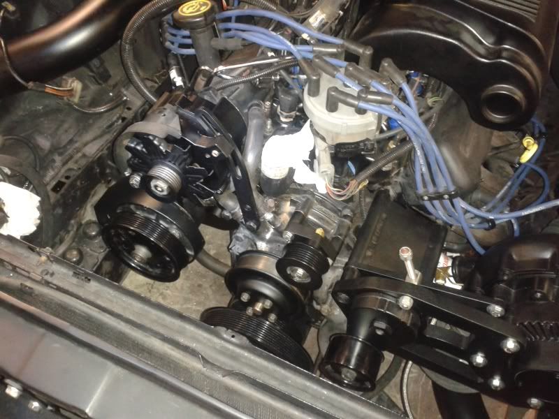

Also have a P/S hose on the way home. For future references if anyone is googling and wondering, what you need when using Procharger P/S relocation bracket #AB003A-010 for 87-93 Fox Mustang is a P/S pressure hose for a car WITH A/C. Don't take my word on it fully yet, I'll recieve it in a week or two and will post if it's the correct item I ordered or not and if so I'll also post the part number. I bought a P/S pressure hose for Mustangs without A/C here in Sweden and it did not fit (it's all they could order home). It needs a sharper bend going in to the P/S pump.
Anyhow, a few pictures. Nothing fancy, shiznitty pics as always, for your amusp00get (or suffering, what ever fits best for you ;) ).

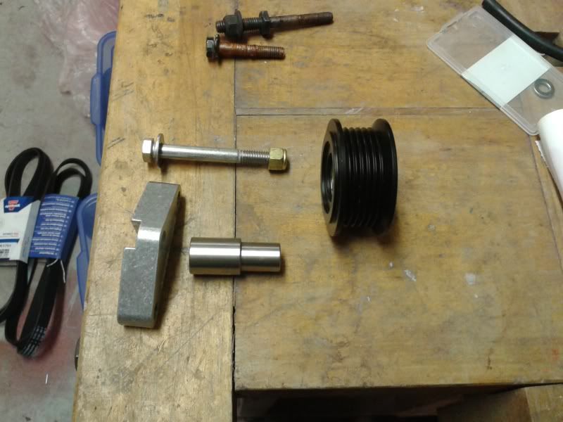

Bracket mounted
The idler that comes with the kit

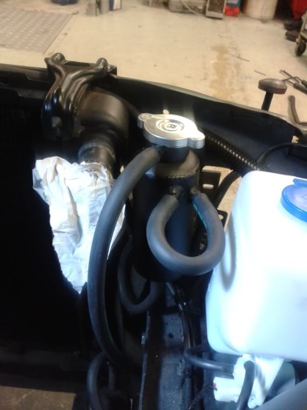

My 0.5L tiny tiny overflow tank. I don't know why but it had 2 extra connections on it which looks retarded and I fixed it like this. I think this overflow tank will be replaced later with something better.

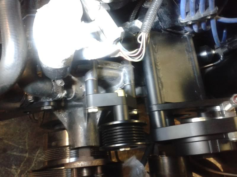

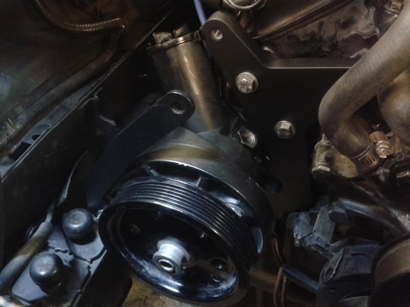

P/S in place
So is the alternator. I really need to clean the engine later on this car. Still have a layer of dust from all the primer that's been on the car during the paint prepping. Thick layer on it!
