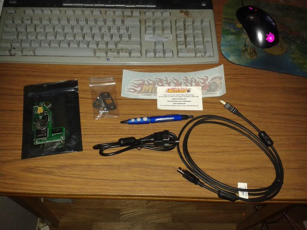

Anyways, ordered my Moates Quarterhorse this tuesday. And I picked it up today.
I even took the slow shipping but as you can read on the package, they sent it with the express mail :) Not complaining, awesome! Gonna put it in tomorrow.

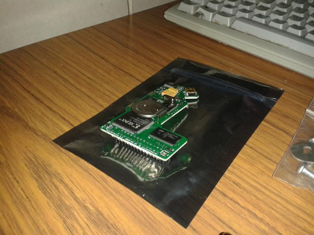

The photos I posted? It's the computer chip for the car. It's a Moates Quarterhorse.
Already have on of those in the car but it refused to make contact to the laptop so I bought a new one.

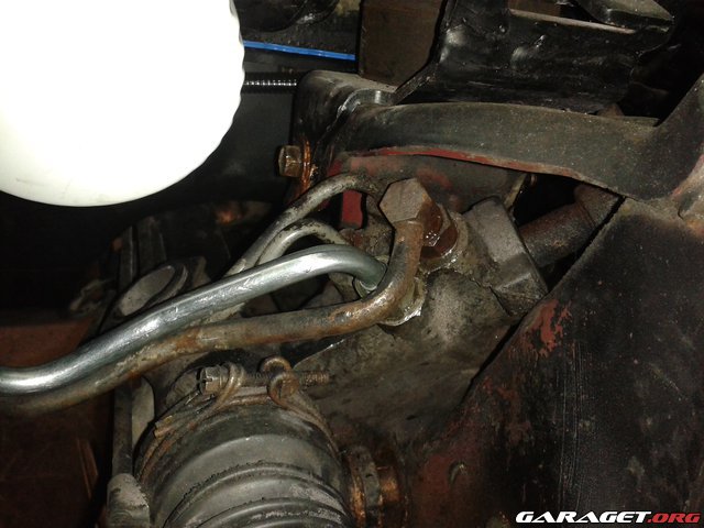

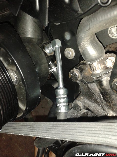

Started out with mounting the power steering pressure hose that arrived today from Rockauto. Easier said than done. But finally got it on!
The other end mounted on the pump.

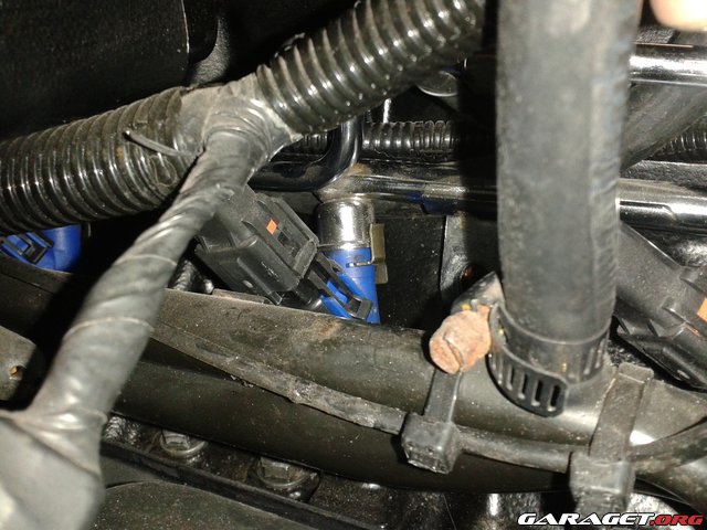

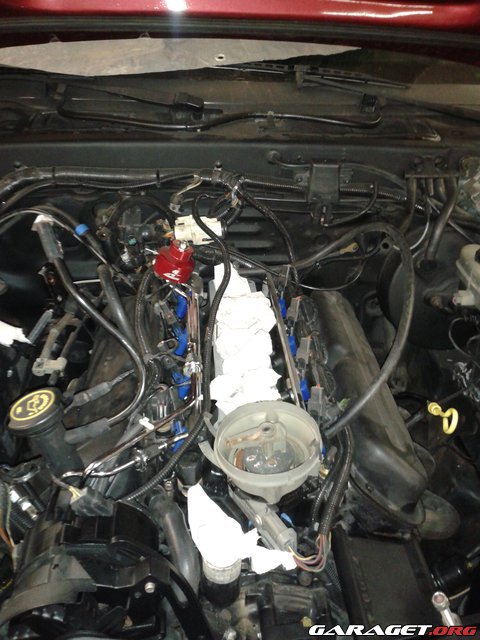

Next problem was that the fuel rails kept jumping up and almost completely come loose from the injectors.
So the intake was pulled off and some changed and adjustments was made and voila! Not a single problem even at 68psi (not going to run that, going for 40psi static).

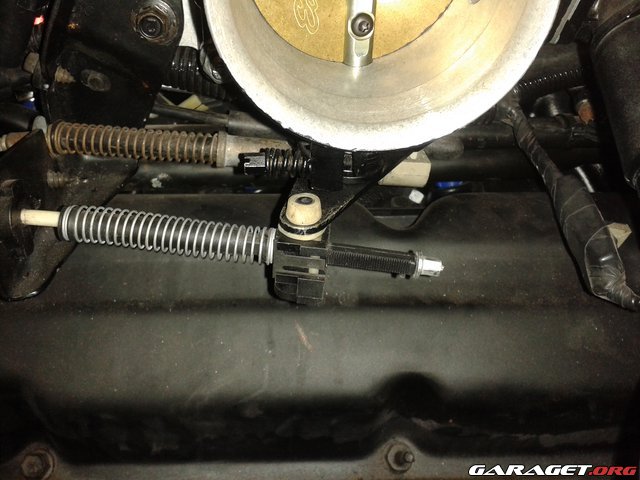

This little rubber mount-thingy for the kickdown on the throttle body caused more trouble than you'd imagine. The original broke last time I took the original intake off, and I decided to keep using it because the only spare we had was this one (which is/was too big). And today the original didn't want to be in the game anymore so I was forced using this one which is too big. After lots of time adjusting it's measurements I got it fitted. Puh!

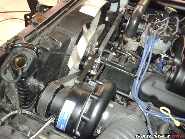

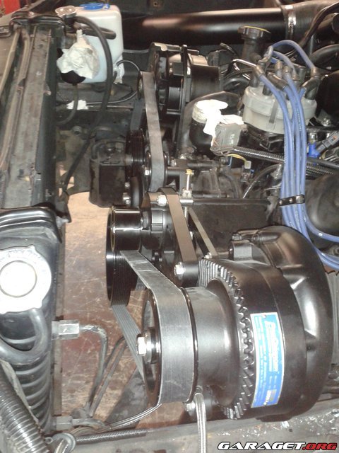

And the big belt went on ;)
Looks pretty  cool!

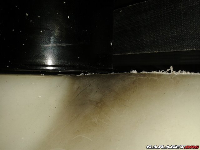

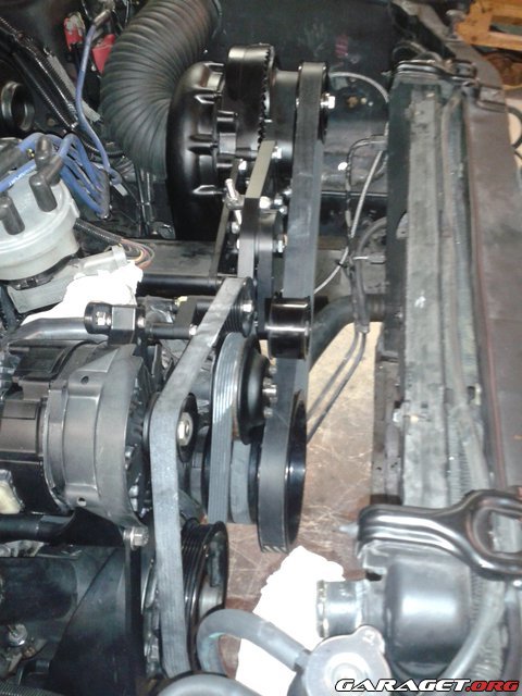

The tolerance between the belt tensioner for the SC and the OEM fan after some filing. Can you say tight?

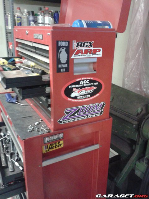

Bonus pic of the tool box.
