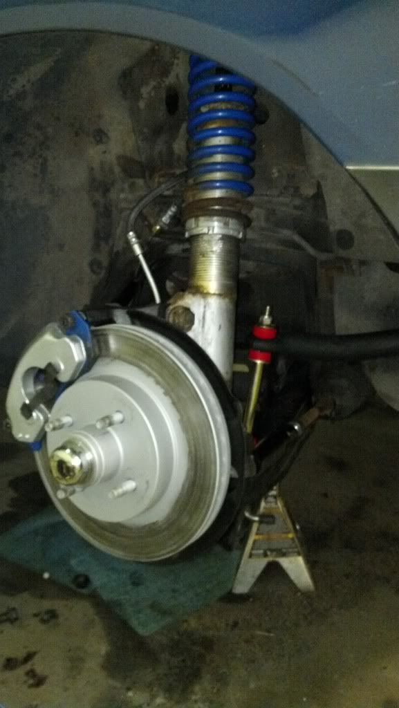

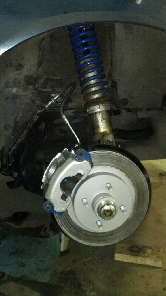

I have the car in the garage right now getting the 11" brake conversion described on coolcats.net. As of right now one side is completed.

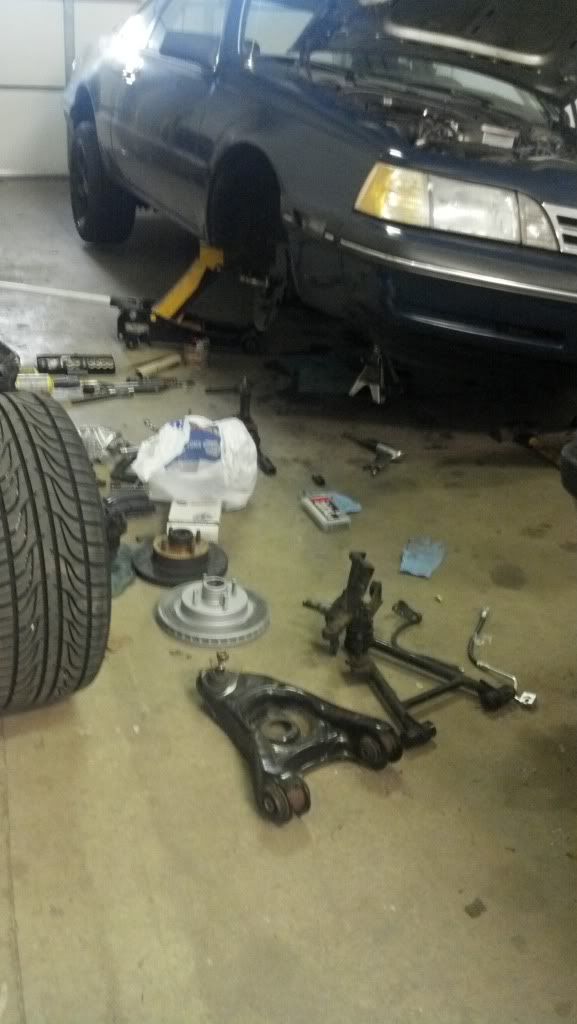

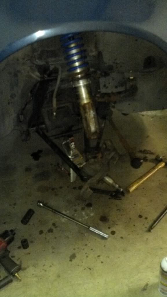

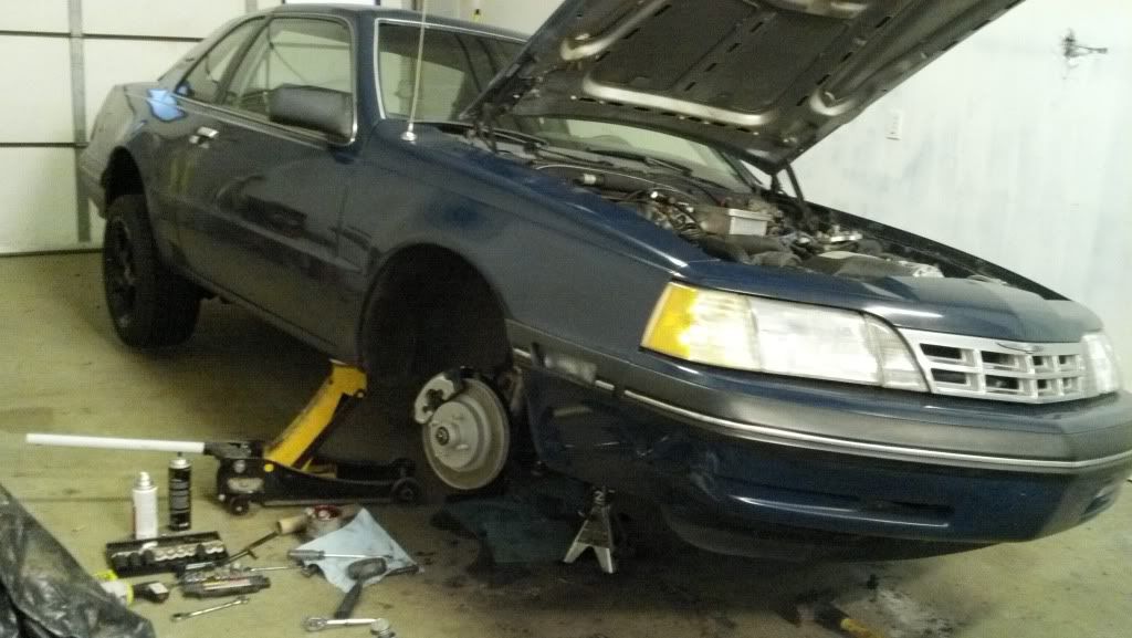

Pulling the old stuff out.

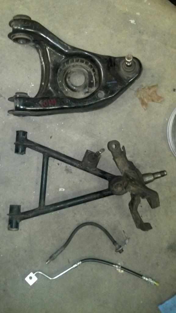

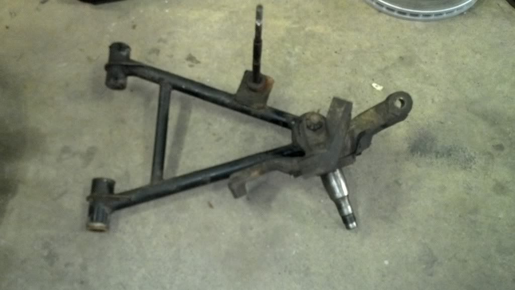

doing away with the stock spindles and AJE control arms in favor of some 03 Mustang arms and 93 spindles
old and new arms, old and new brake hoses

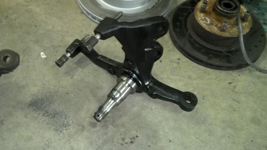

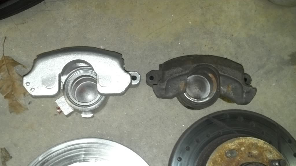

93 mustang spindle

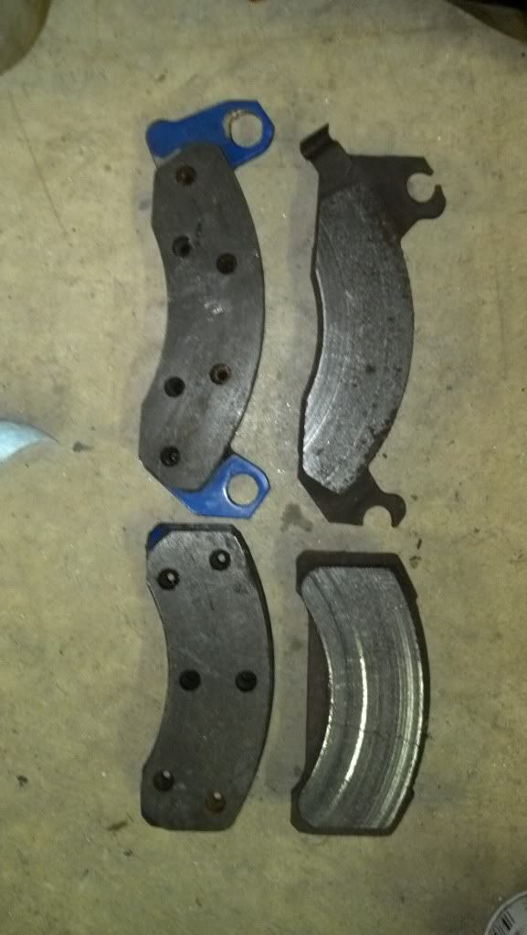

stang vs. stock pads

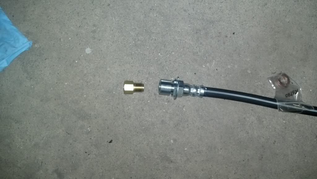

stang brake hose with adapter to work on t-bird hard line

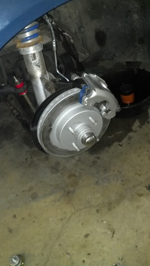

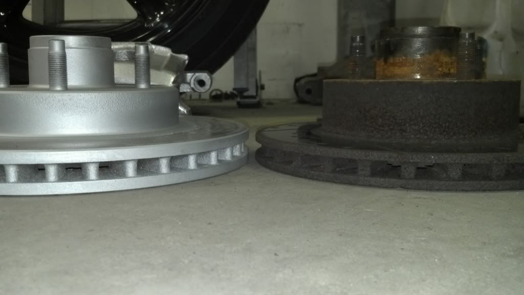

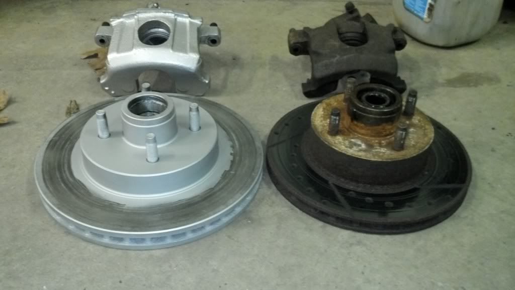

Stang vs. stock. aside from being an inch larger diameter, the Stang rotors are also a lot thicker
one side down

Is everything direct bolt on, or did you have to modify anything?  I can't believe how 'small' those mustang a-arms look!

It's a direct bolt on. Same thing as an '87-'88 TC, less the ABS particulars.

This may be a dumb ?, but the rotors are off of what?  this looks like a cheap, easy upgrade for my py stock brakes.  Where do you find that fitting adapter? I like the coil-overs, what brand are those?

Its pretty much a direct bolt on. The mustang spindles were a little narrower where the strut bolts up and the spacing on the holes was a little off. Both problems were easy to solve. Also had to enlarge the hole in the flex hose bracket on the frame a little to get the mustang hose to fit. The rotors I used were from a 93 Mustang GT and I got the brake line adapters from Napa.

I finished the other side 3 days ago, but I'm finally just getting around to post the results tonight. Everything is working fantastic. The Stopping power is awesome now, with no fade whatsoever under hard braking from high speed:D

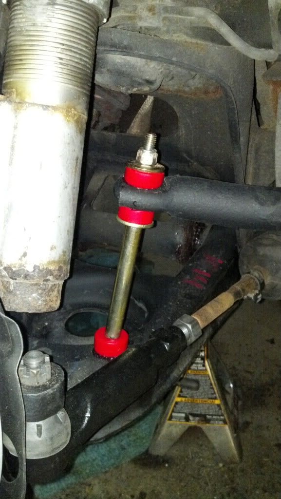

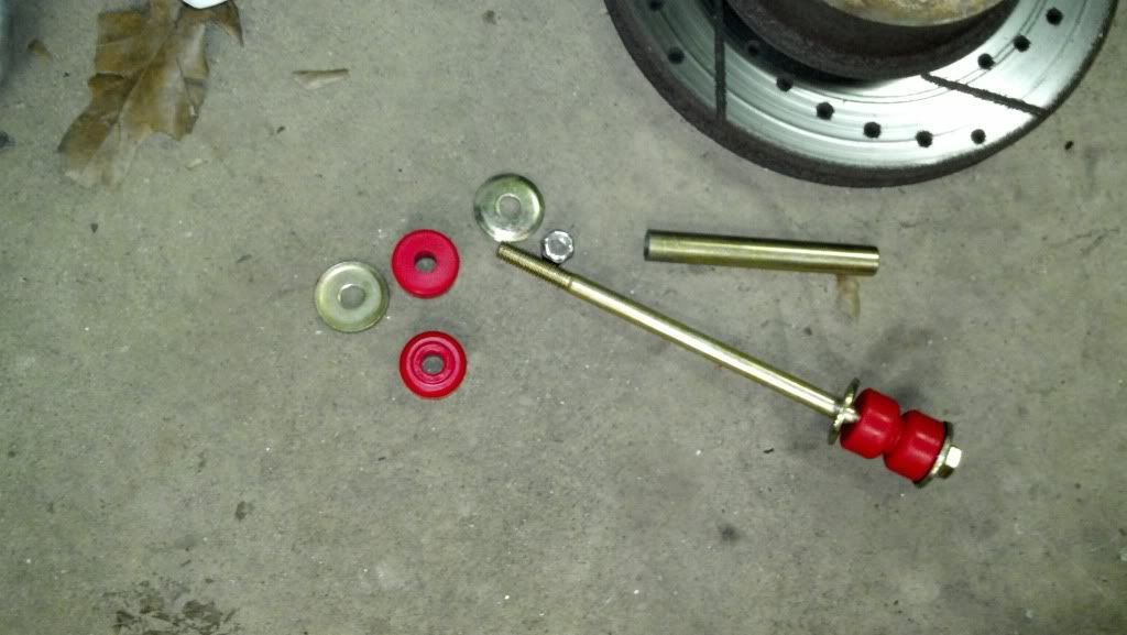

I ended up getting some new ES swaybar links too.
My ST swaybar and some new tie rod ends

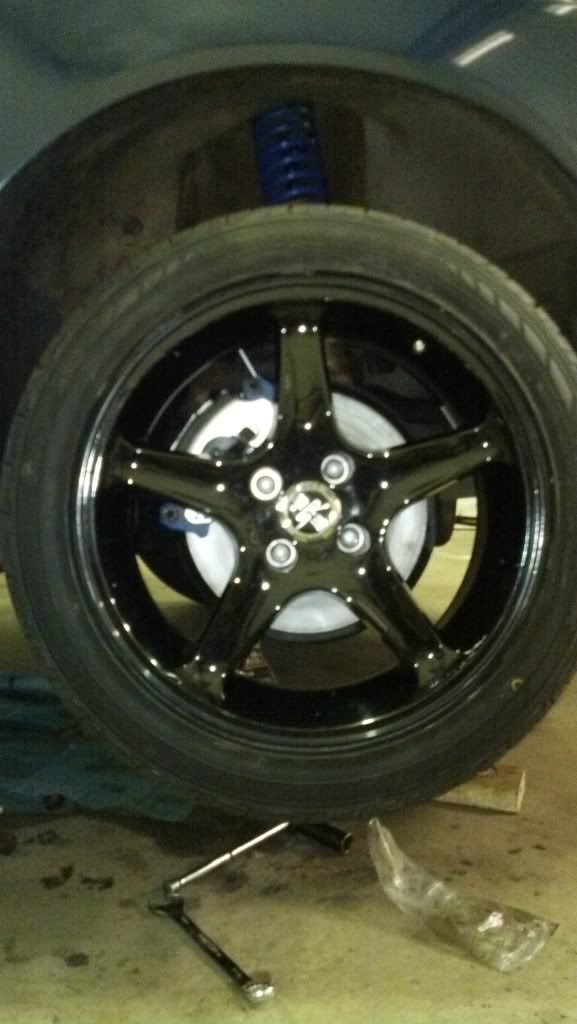

Other side done

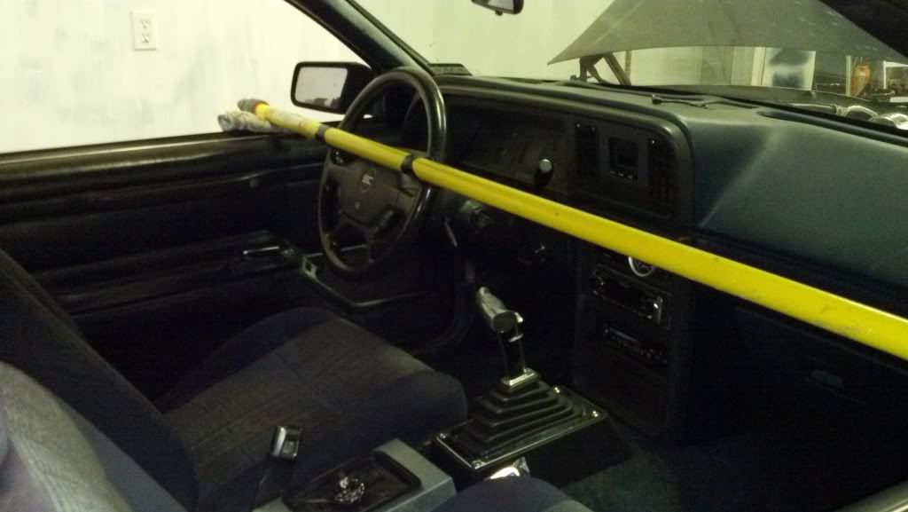

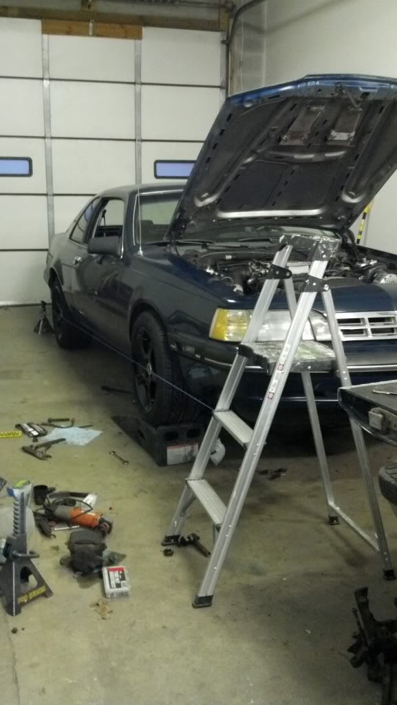

Locking the wheel straight while I do the alignment
Pulling a straight-line off the rear wheels to align the fronts

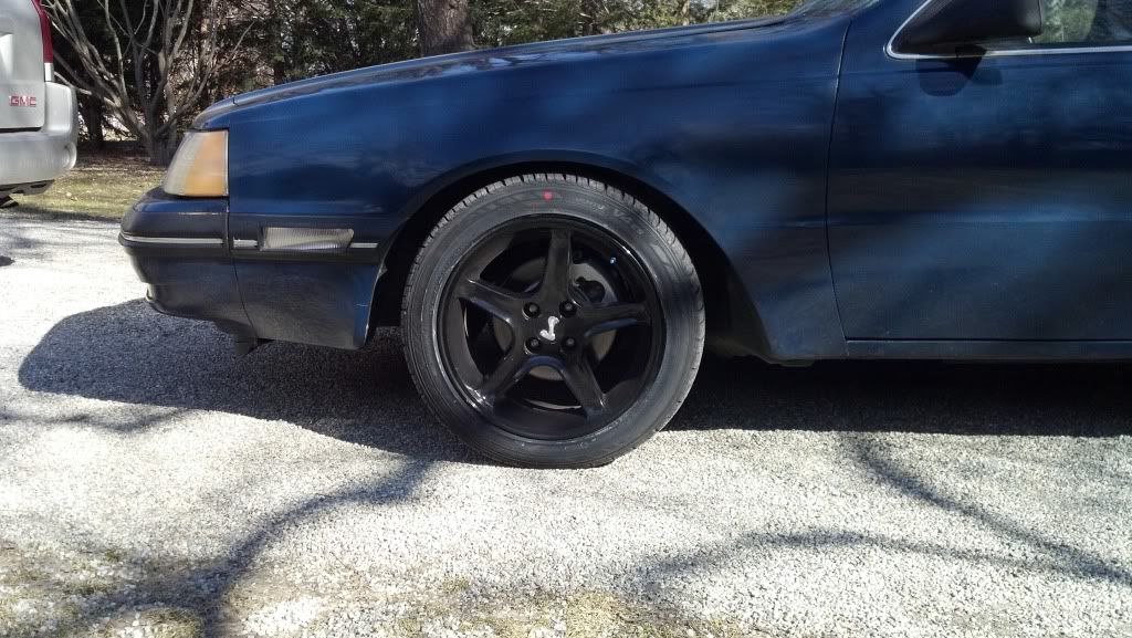

Definitely fills out the 17s a little better now

I too had alignment issues after going from stock to 11" brakes, and then again from those to SN95 stuff. The first time I dealt with it, as it wasn't too terribly bad, but when I swapped in the Stang 5 lug parts, it was so bad I couldn't drive in a straight line just idling out of my building. I finally got it where it barely pulls at all using a method pretty similar to what you posted.
Looks good, and how do you like the SC wheel in there? I wasn't aware they'd fit...I may keep my eye out for one now..hmm.

I learned the alignment thing from a friend who's on the pit crew for a low budget, modified race team. The SC wheel works great. Even the cruise control buttons worked with no modification and best of all, it doesn't have a wrap to fall apart and make a mess. Its all one piece. How do you like your SN95 springs?
