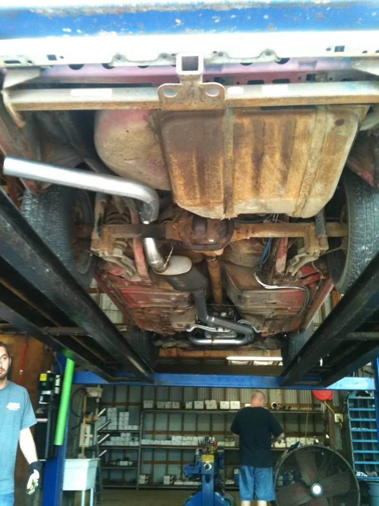

Yes, I do. I'd rather have the Baumannator but that's $540 with the "universal" wiring harness.
Here's a better pic of the exhaust:
1979 Ford Fairmont
[/B]
New daily = 79 4dr Fairmont
Reply #119
Nice trailer hitch!
