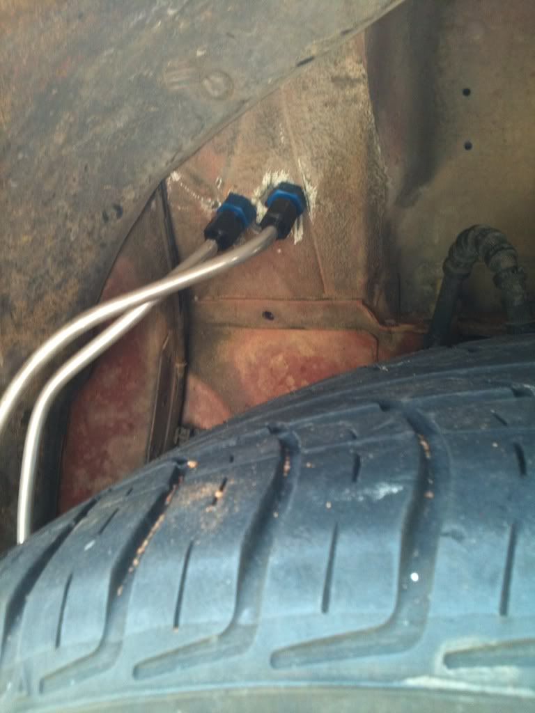

Productive day, but not productive enough. Lots to do tomorrow. I got all new fuel lines ran. I used a 6an push-lok hose from the rails to a bulkhead behind the pass strut tower. From there I used 3/8" aluminum line. One to the tank. One to a 40 micron filter. Currently using a frame-mounted 85 Bronco fuel pump. I drained the gas tank and drilled a hole for a return fitting a put a nut on the back side with a nylon washer.molested

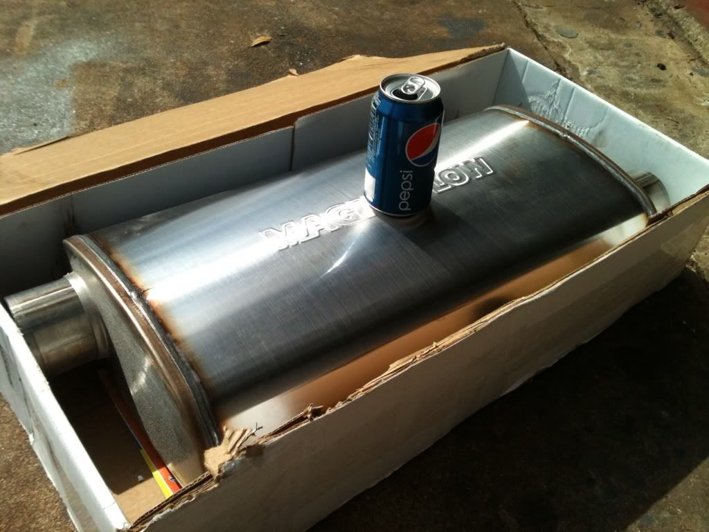

My new ler showed up and it's HUGE. 3" Magnaflow. Overall length is 24"!! I could probably fit one of my 2yr olds in it. Sending it back to Summit and getting a refund. Local ler will be doing a full custom exhaust as soon as I finish up what I need to.

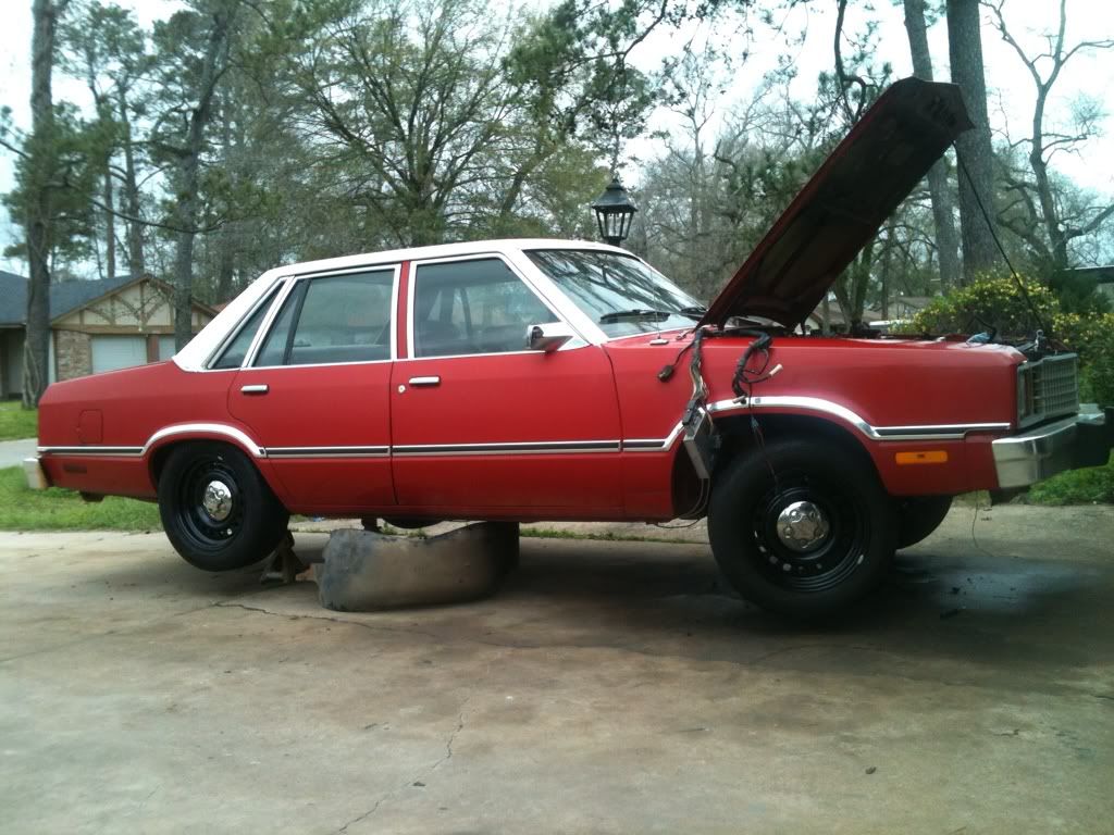

Pics in its current state:
