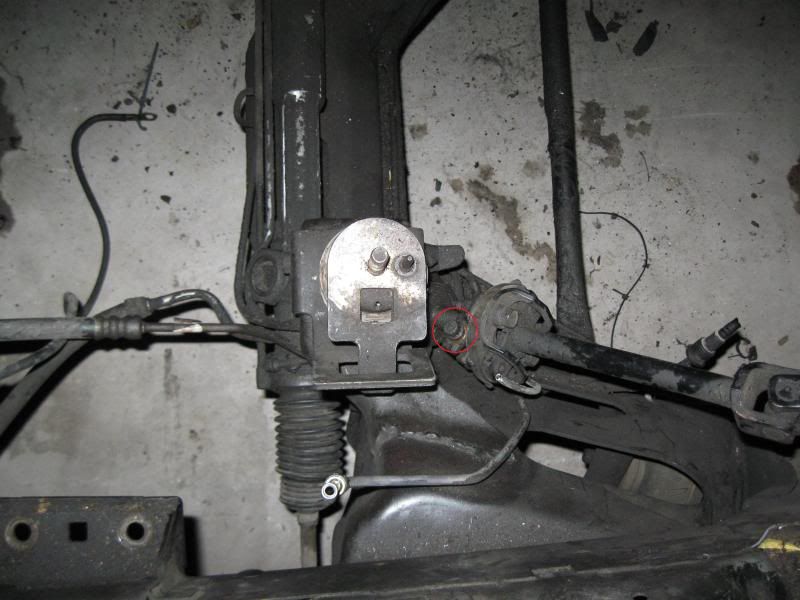

I am thinking about swapping the steering rack form my TC into the Cougar.  It looks easy enough to take out of the TC because it doesn't have an engine in it but is there any tricks to getting it out with an engine in?  Doesn't look like there is too much room.  Also, do I separate it by removing the bolt circled on the pic below?  Does it just slide out after removing that and the two 18mm nuts?  I will probably remove the alternator and power steering on the Cougar to have better access when I got to that part of the job.  Any advice is helpful, thanks!

That's pretty much it.  It may not "just slide out" of the coupler @ the column, but it should work out easy enough once the cinch bolt is out.  Obviously you need to remove the tie rods from the spindles as well.

If you look at the top knuckle there is a one bolt that holds it to the column at the firewall.
Tricks to swapping out steering rack?
Unbolting it at the top knuckle won't work because the round part just above the circled bolt is just a little too big to pass through the opening under the motor mount.

You can get to the bolt you have circled in the picture with a short socket, wobble or knuckle joint (what ever its called), and a 6" or 12" extension (been a while).  I use all 3/8" drive stuff to this point but use a 3/8" to 1/2" adapter on the rachet end of the extension so I can use a 1/2" drive rachet.  More lever arm and less work for me as this bolt is usually a bit tough to break loose.

Thanks for the response.  I actually got the circled bolt out with just a long extension (I do have the alt and PS pump out though.)  It didn't put up much of a fight.  I took the rack out of the TC without undoing the lines from the rack side and was hoping to do the same for the Cougar rack but if I do end up taking them off there I will be sure to get the teflon washers.  I will probably get this done tomorrow morning.  I will take pics and update this thread then.
