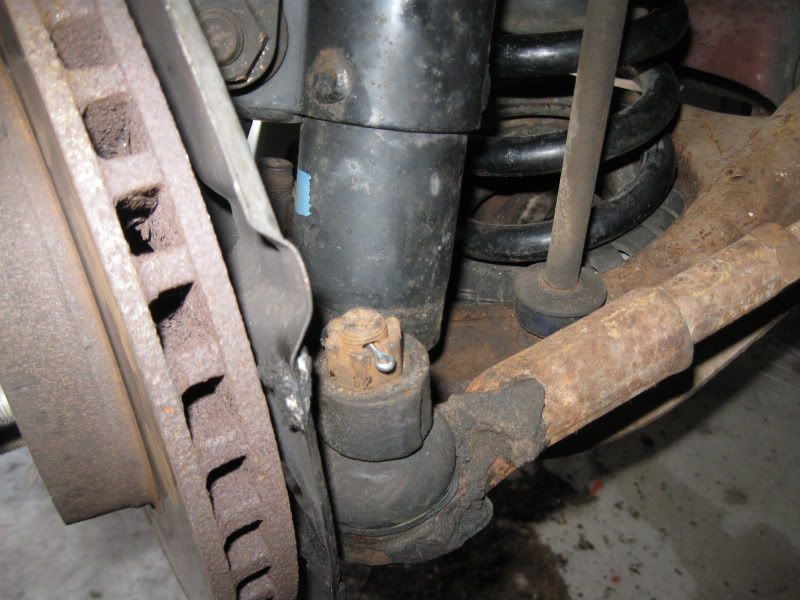

First I soaked all nuts and bolts with PB blaster the night before.  I also marked the rotating part of the shock with the stationary part of the shock with the steering wheel in the straight ahead position.  Then after removing the tires and supporting the car securely on jack stands I removed the cotter pins and castle nuts (3/4) from where the tie rod ends go into the spindles.

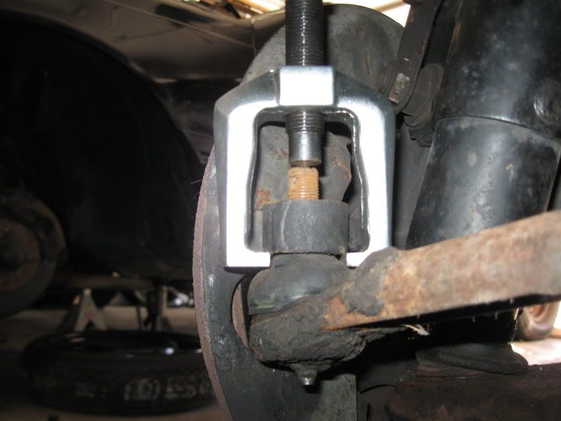

I used a puller type tie rod remover on the TC (because it has 10" brakes now) but the 11" brakes on the Cougar interfered and I had to use a pickle fork type separator.

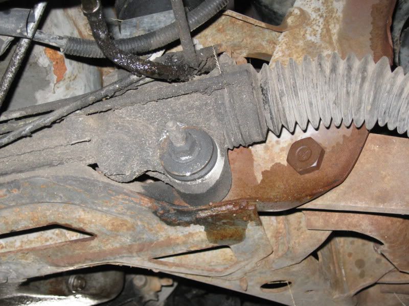

I then held the bolt (rusty, in center of pic) in the back side of the k-member that the rack mounts on with a socket (15mm) and a breaker bar held in place through one of the openings on the k-member...
...and loosened up the nuts (18mm) on the front side

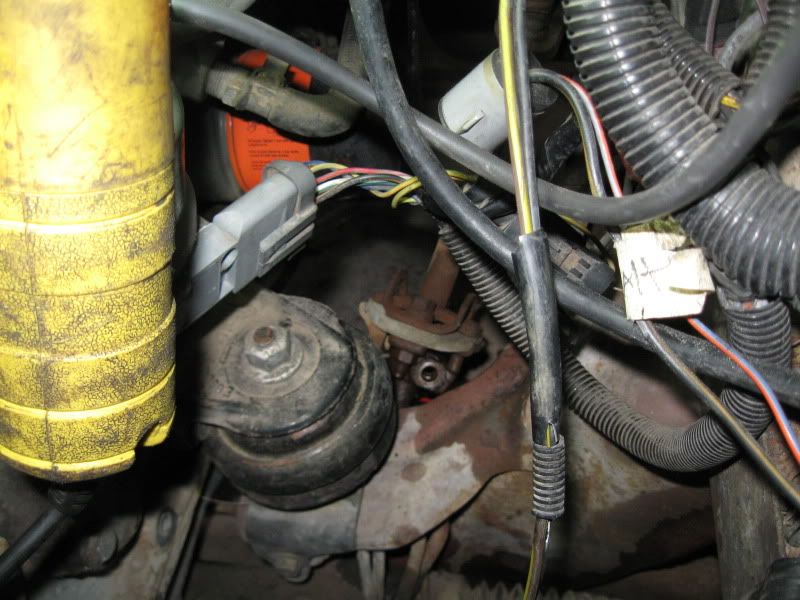

After that it just takes some prying to work the rack loose from the bushings and then some prying to separate the steering shaft from the rack coming off the shaft.  Putting the new rack in is pretty much the reverse.  I took the bolt out of the steering shaft (between the steering column and the rack) and removed that section from the column.  I hung the new rack up on the bolts to mount and then attached the steering shaft to the rack and then attached that to the column.  I tried it with the steering shaft still attached to the column first but I just couldn't get the splines to line up on the bottom.
