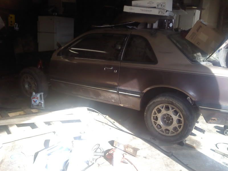

Well, I got busy...

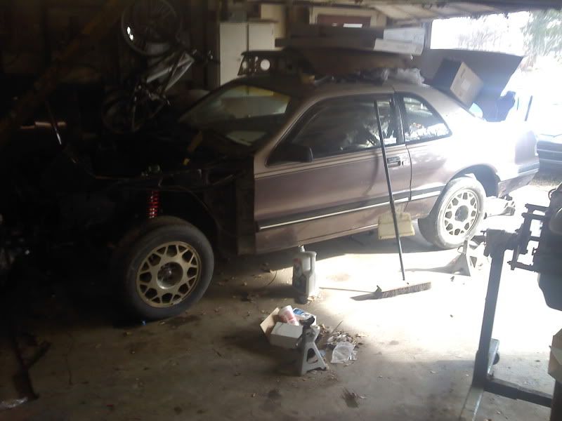

Shes on the ground now.
Next project is to finish up the brakes, run lines, get the steering shiznit situated get shocks under her, and toss the 302 in it.

Great. More accomplishments today on the forum !!! Let's have an internet cookout !!! Congrats on the Bird sitting on the ground again.All down hill from here.

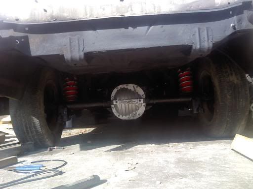

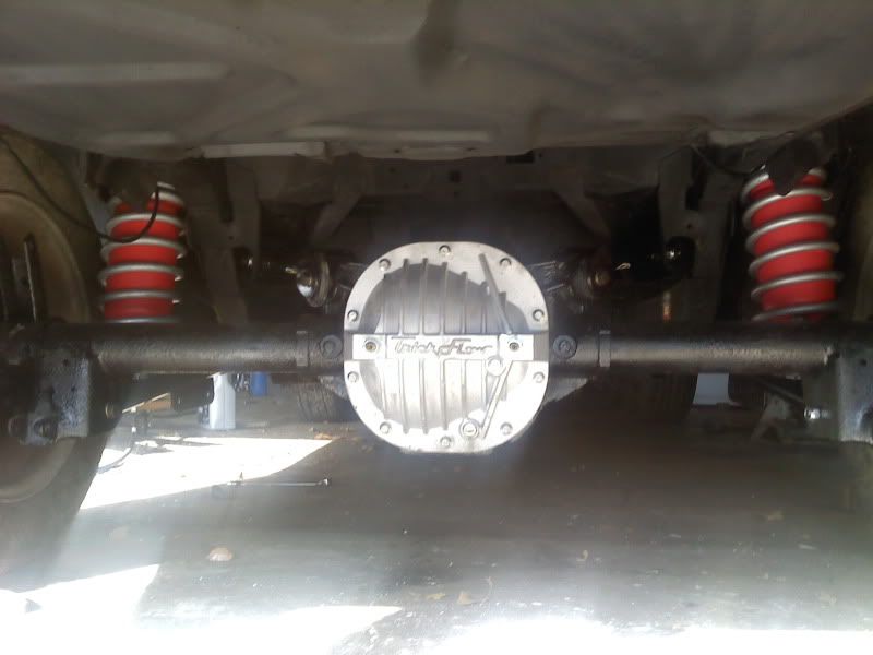

The rear looks like it's up in the air a bit.
Congrats on getting it back on all 4 wheels :).

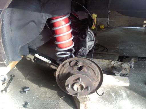

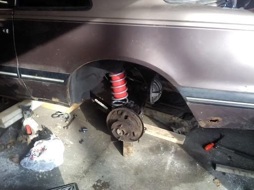

I'd like to know what springs you've got on there, and where you got them. It will settle down some after driving. All that work and your keeping the stock drums?

Thanks all, I felt real good when I sat her down yesterday
Im running factory 5.0 LX rear springs. The coilovers are Granatelli ones.
Im searching for a set of tc or 4banger stang springs

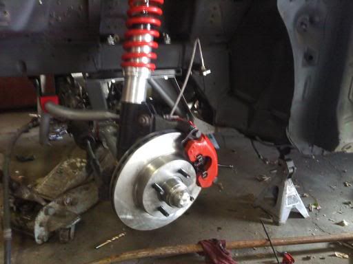

Got 99% of the front brakes done. Have to get new fittings for the braided stainless lines because they went to bigger fittings... Oh welllll.

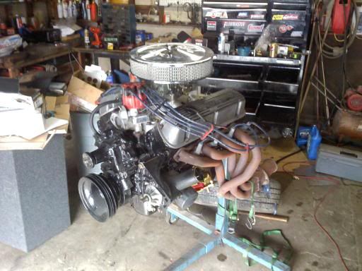

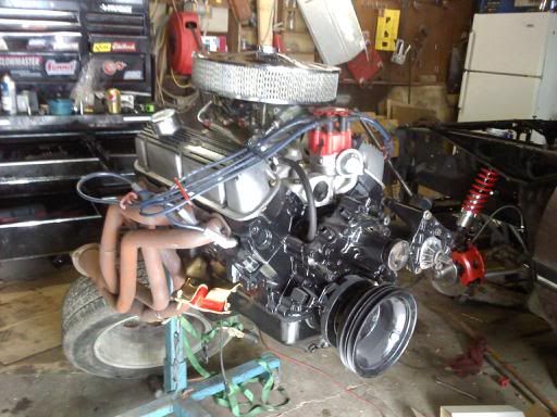

Mocked the headers on the motor while it was on the stand to tweak the header on the driver side over more to the passenger side because as it was it was headin straight for the bolt in the crossmember mount. Well hopefully everything goes in peachy keen.

Engine needs more Ford Blue paint ;) j/k.
Looking good. You're getting close to driving it :).

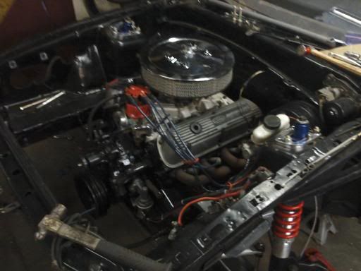

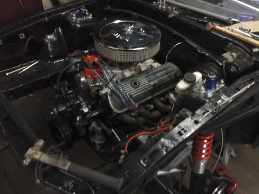

No more big empty space

Looking good man!

mmmmmmmmm.. finned valve covers.. looks great!
