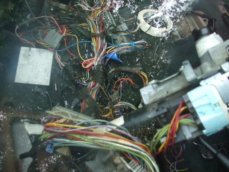

Two weeks ago this coming Thursday,I was installing sound deadener in the Sport. I started with the roof, then went to the trunk, and I had stopped for the evening. I was moving the Thunderbird from the drive way when I happened to notice that my clock and radio weren't working. I though to myself " a blown fuse". So, I pulled back into the driveway and got out. I looked up at the fuse panel,and I saw a large burnt hole with a white ashy center. The hole was about the size of a 50 cent piece. I tried to drop the fuse panel, but the wires were to short and tight to allow it to drop, so, I removed the dash and this is what I found upon more inspection............
I remembered that the '86 V-6 Thunderbird was at my favorite boneyard (only Bird for miles). I had gotten the dash from it a few weeks ago. Anyway, I drove the 16 miles, and cut out the fuse box leaving about 6 inches of wires on them. I got home,and compare every single wire from the Sport ('88 5.0 car) to the '86 fuse panel....identical to the last wire.... WOO-HOO !!! (looking for anything positive at this point). I then started swapping the fuse panel one wire at a time. Cut and graft.....cut and graft....cut and graft.... until it was all done.
After I finished swapping the panel, I figure now was a good time to install the rest of the sound deadener throughout the floor,firewall,and doors. While I had the carpet up,I found wires on the passenger side and driver side floor running along the door jambs that were melted. i replaced those and finished up. I took the replacement dash and dyed it gray, along with the console, glove box door and associated dash pieces. I installed the passenger side power seat equipment that had been in the garage since early this year as well. I applied sound deadener on the back of the dash and air ducting as well (had an extra roll....Thanks Zillamat !!!).
I then installed the dash, console, and everything else. I turned the key on and no dome light, no radio, no clock, no trunk light.I checked the fuse, burnt out. I installed another,and still nothing. I got to trouble shooting again, and found the dome light harness that goes down the passenger side a-pillar was melted. back to the salvage yard,pulled the dome light harness and installed it. Same issues, no power still to those above mentioned items.
I called Jerry (daminc) and we talked for a while and did some long distance, over the phone trouble shooting and I found that the visor harness was bad. It had a screw from the driver side visor going through it. Grounded out. I swapped that harness and everything worked as it should.
I went out to move the Sport last Thursday night, one week after the whole bunch of  started, and the dash lights and head lights didn't work,but everything else did. I swapped the light switch, no change. I pulled the switch again,and looked at the fuse harness with a flash light and there it was.... a wire had broke from it's connection. I reconnected it together and then everything was working perfectly again. What a relief.....for an hour.
I went to pick my son up from school and it was pretty warm,so,I figure "I'll use that a/c I paid all of the money to have working again". No cold air. I called the a/c guys at "Olde and New", and they took the Sport yesterday and changed a bad valve for the R134 conversion and now, really cold air, and all is good again. 46 hours of total labor. I can NOT imagine having to pay someone to do all of that. Holy .

Lol... now that I look back at that pic...... That thing is really cooked. Your so lucky the car didn't catch on fire from that. On the upside, I now know all the wiring from the fuse box, all the way to the trunk.
Hey,I'm glad you learned from my ordeal.LOL. I''ve kept that fuse box.I need to put it in a shadow box and hang it up somewhere.I know a lot more than I did before I got started on the repairs. Yep,learning the hard way. Nothing quite like it........thank goodness.
