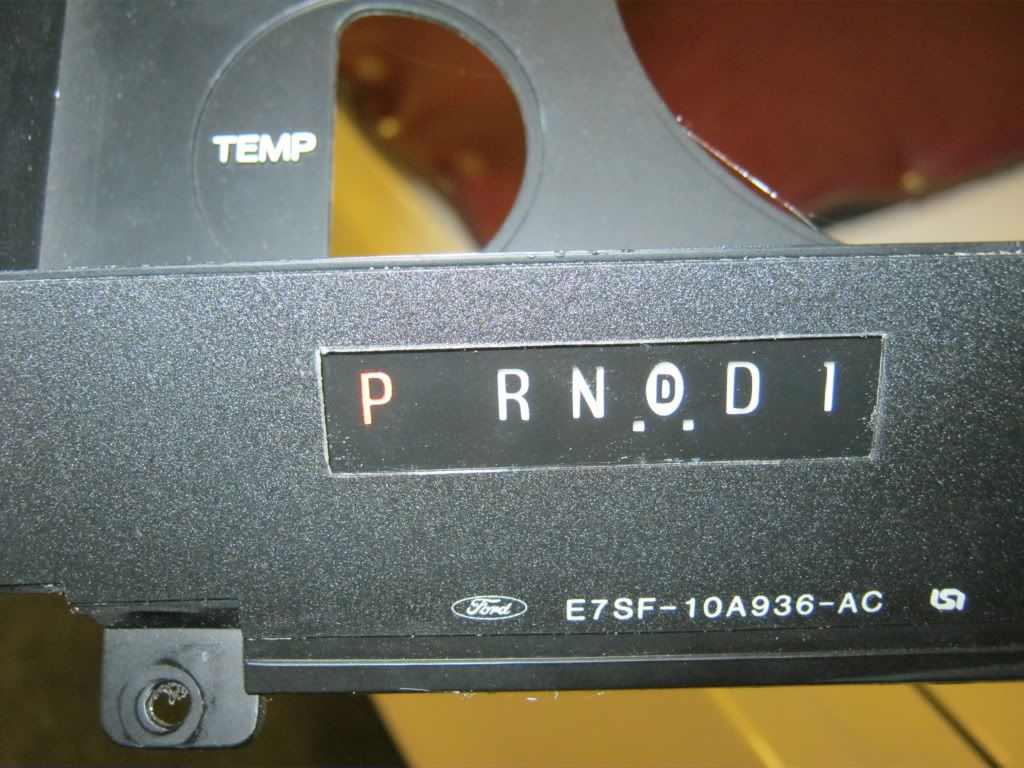

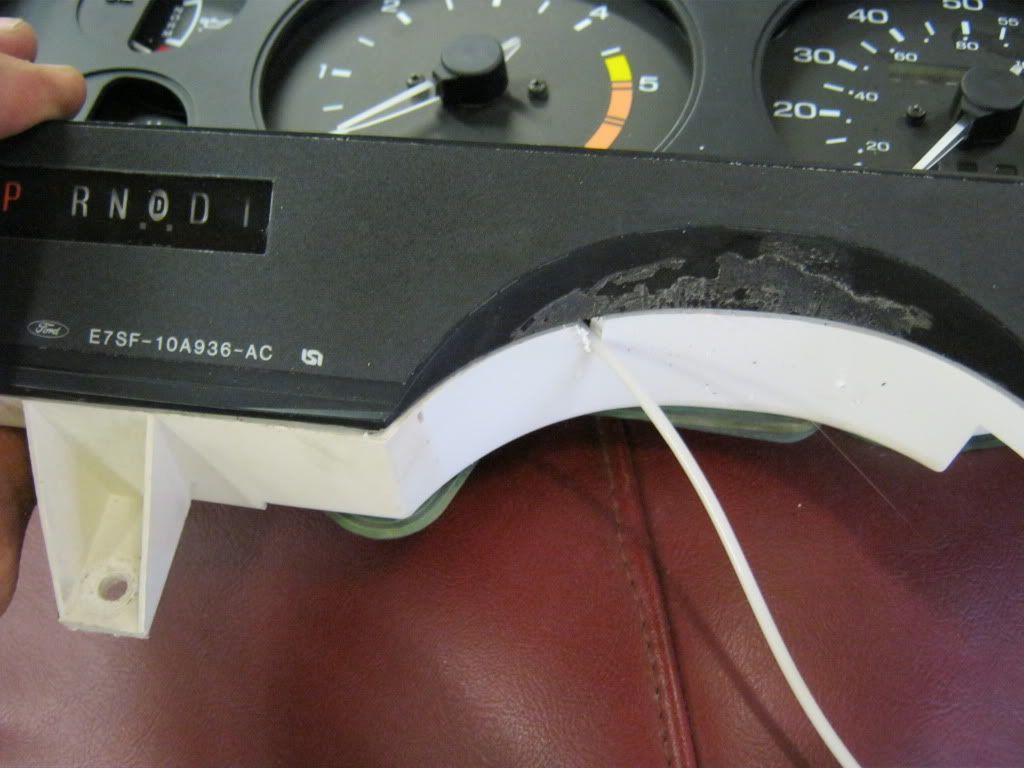

Space is very limited on an buttstuffog cluster. the only idiot light on the bottom left was the seatbelt light. If I don't know by now if I'm putting on a seat belt, then I need to get out from behind the wheel. lol... I took the selector from the digi cluster that I pulled out of the parts bird. did a bunch of cutting on the back of the vert's cluster and bam.... Gear selector for a car with a column shifter..... I'll be working on a longer cable next. I figure a guitar string in some tubing would work perfect for this simple mod.  I'll post the inner workings of the whole thing after I get it all together.
BTW...the speedo, and the gas gauge is are all that work in the vert. I need to get the rest working, or connected or something. :hick:

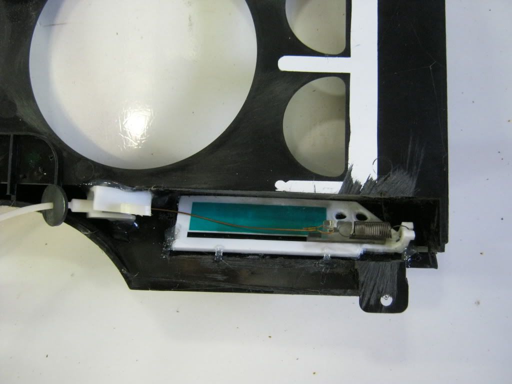

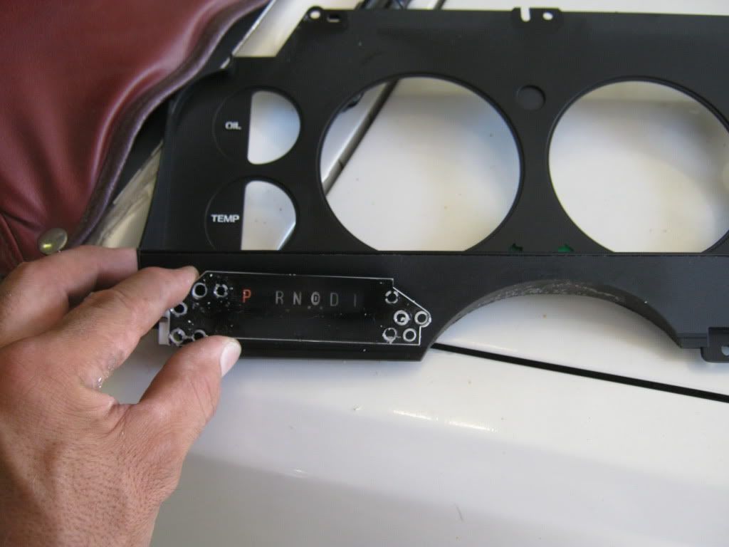

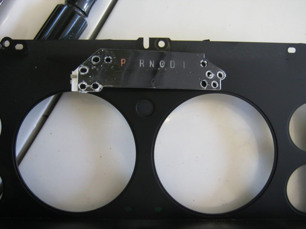

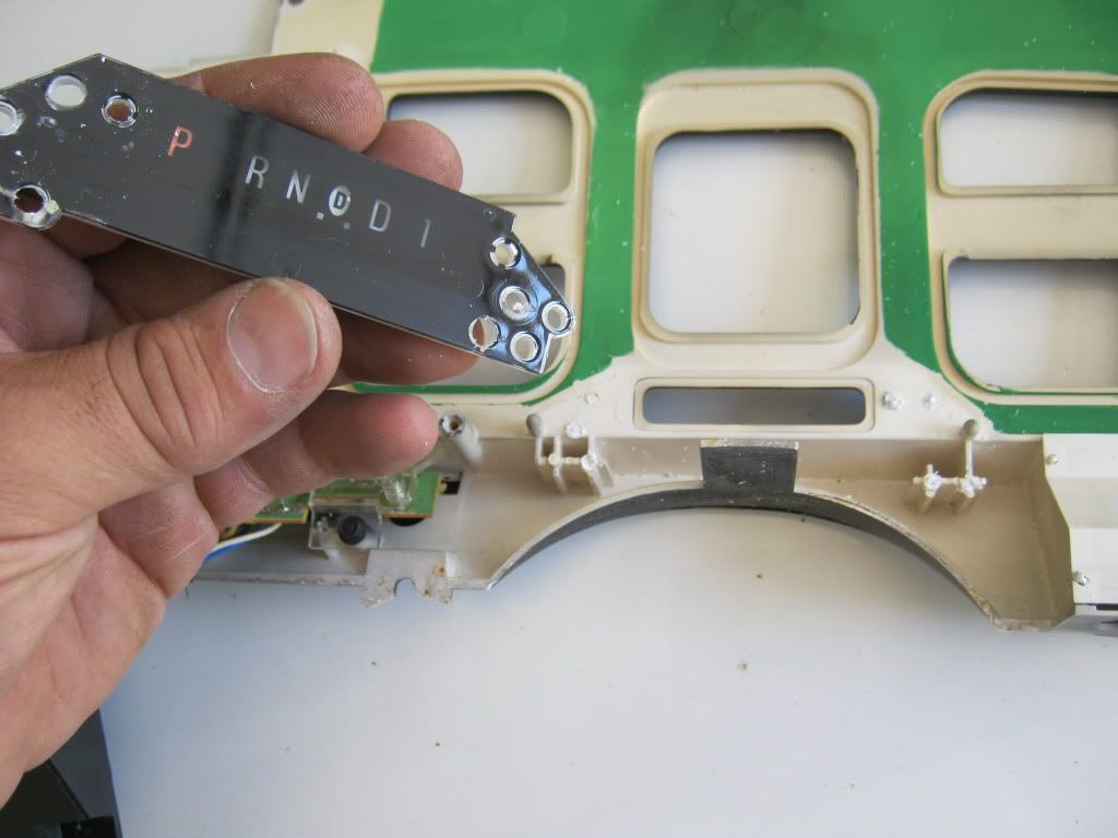

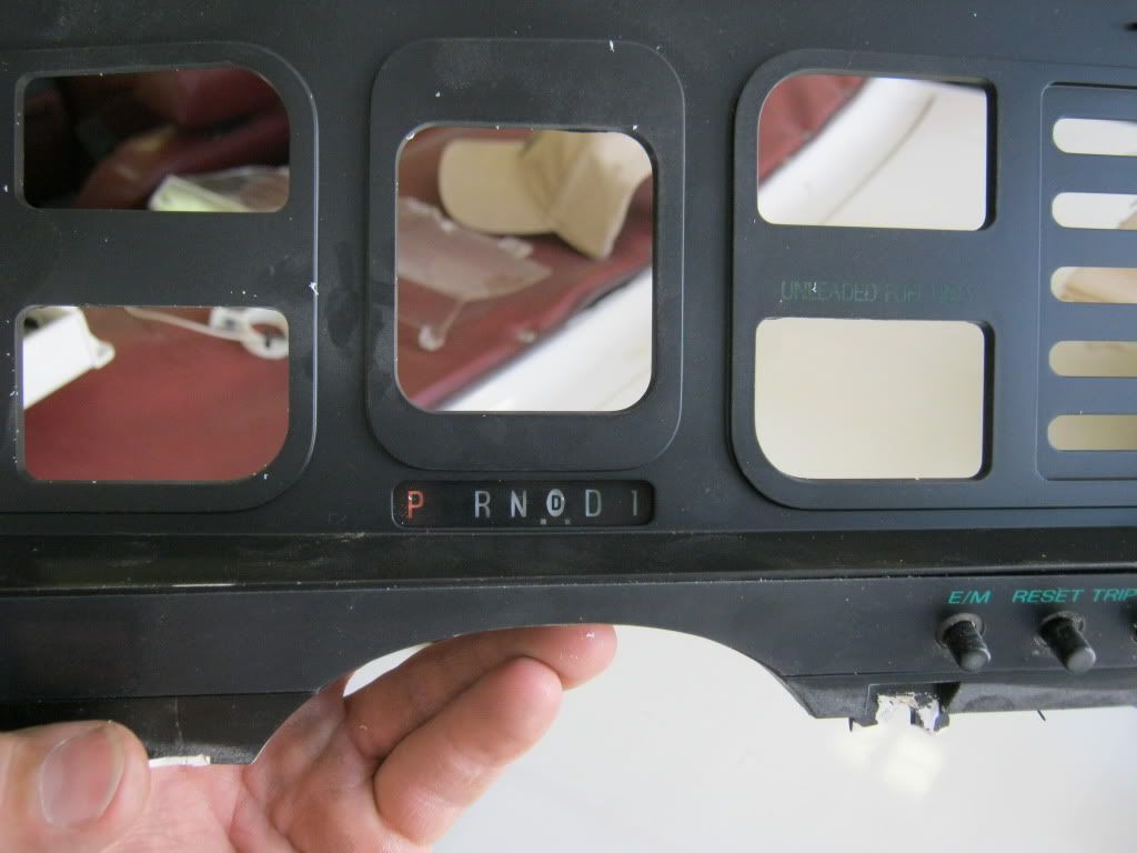

More pics of the project.
selector from the parts bird
I drilled out the plastic welds to set it free
then to find a place for the install. I would have liked it up here, but the trim covers it just above the  speedo and tach
so this was my only option.
here's the back side of the selector
And of course the front side
I made a notch for the wire.... now to see if I have enough slack make it work. It's gonna be close
