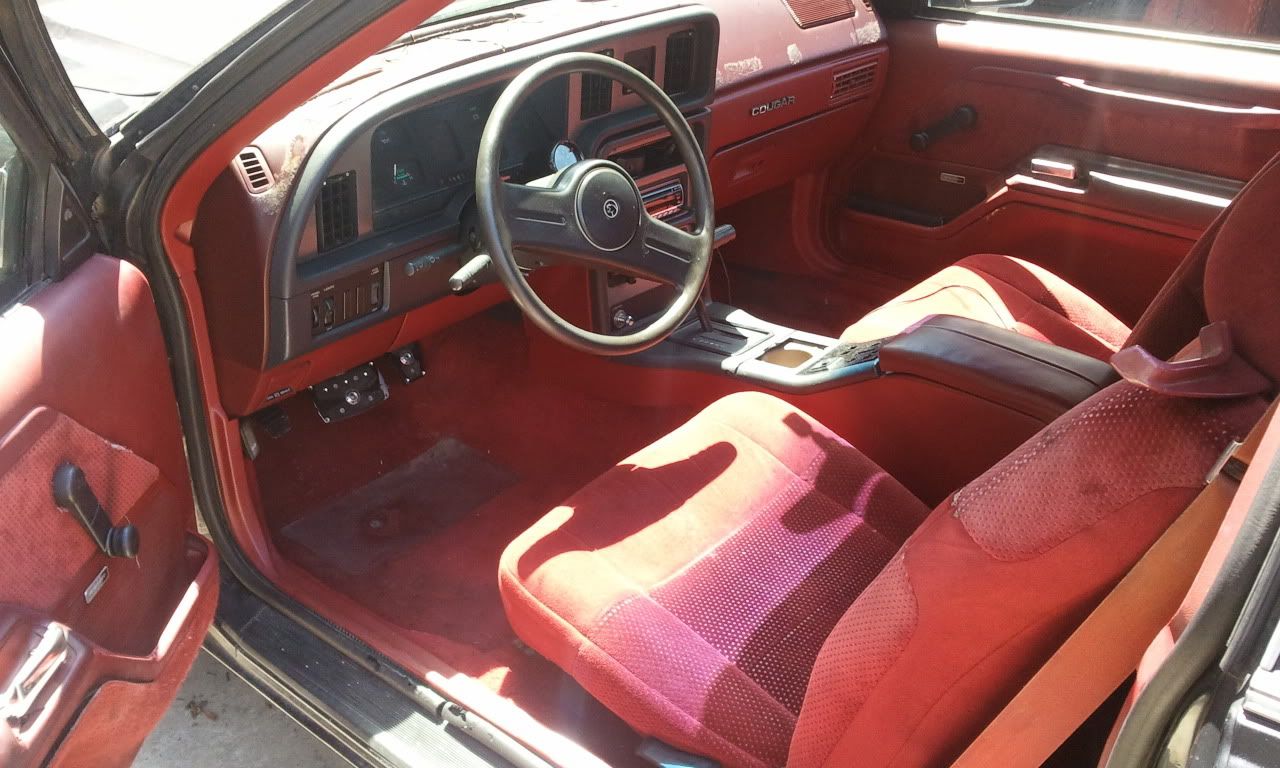

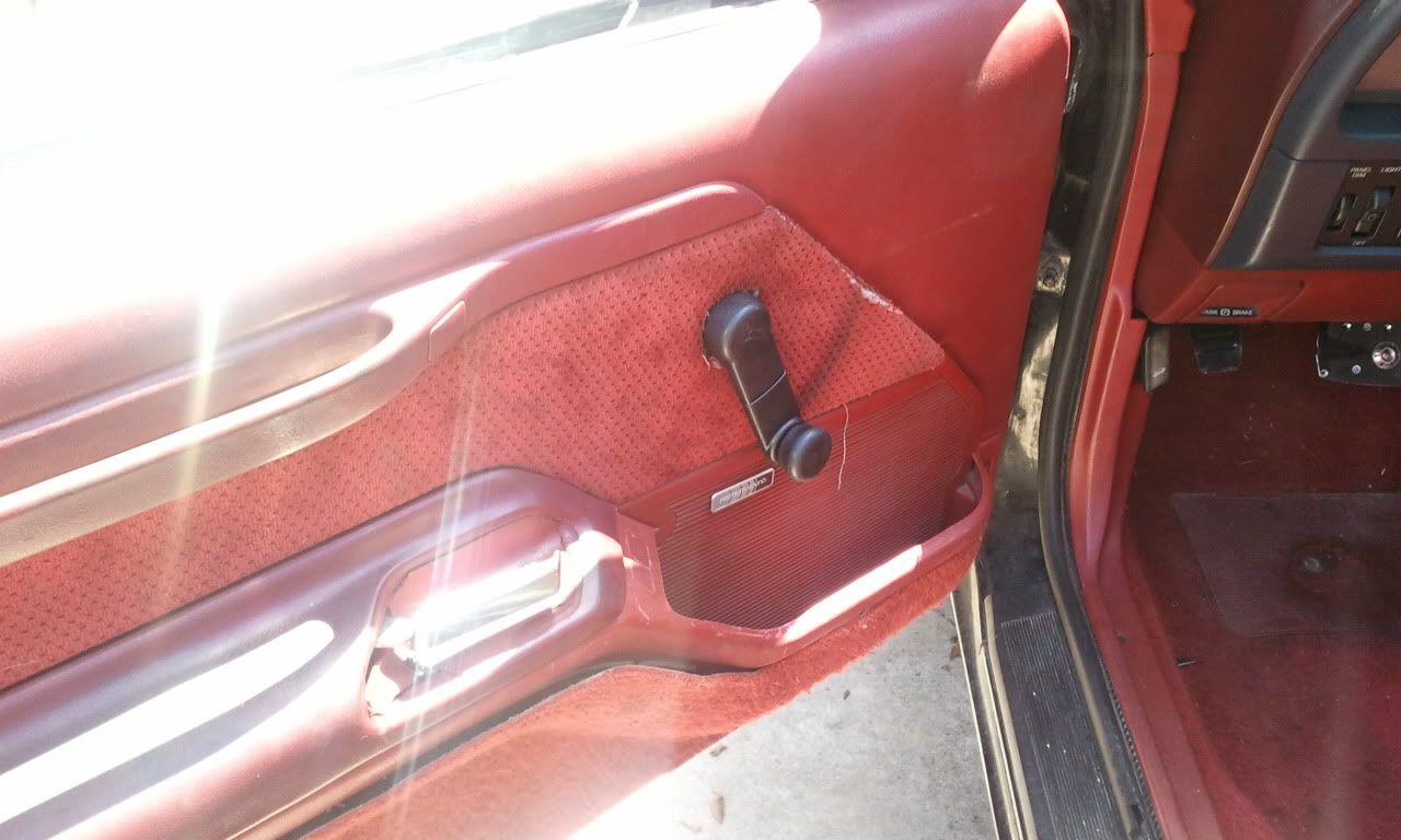

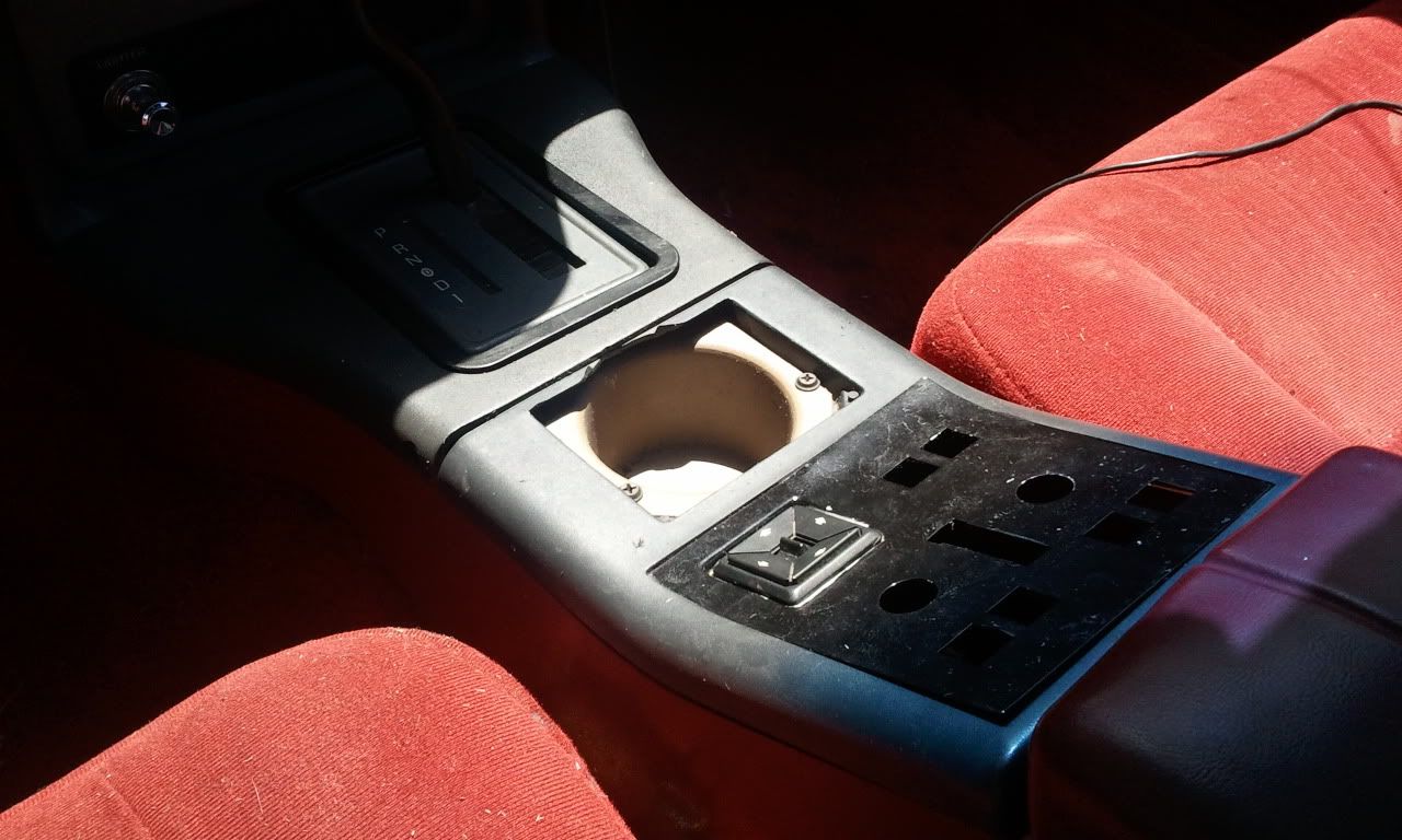

First of all I fixed my DS door lock, which I broke once trying to jim into the car. I snapped the little plastic lever off the lock. Second, I got around to repairing my windows. Neither one rolled up correctly and the PS had snapped off of the connectors. Well I epoxied it back together and oiled up all the rollers and track and cranks. Everythings good now. I also got brand new correct crank handles. Then thirdly I got new door latch bolts with the plastic bushings attached so now the doors clunk shut instead of rattle shut. Got the window spacer in on the driver side which was missing too. I took my door handles out and bent the slot in the door a little to tighten the tab back up and rebolted both handles which were all loose. Used to have to slam the handle out to get the door to open. Added a couple of screws to my door panels to tighten them down too since all my tabs are broken. I need to get hold of some new fabric though. And then of course I put the cupholder thingy in there. Still working on that.
Reply #355
That darn cup holder....... The more I look at it, the more something is missing. I think it needs to be flush mount with the panel itself. It looks like there should be a door, but isn't one. It'll come together. needs some fine tuning. As far as the door handles (inner) being harder to open, I loosen the bolt that holds it to the door, pull the assembly forward as far as possible, then tighten the bolt. It tightens the rod, making the door open a lot easier. Just my tip for the day. Glad to see you are making progress. It's the little stuff that drives me crazy as well.
Reply #356
Oh no I got the door handles fixed. The problem was not the rod, just the fact that over the years the handle and the assembly had both come loose and were wobbly. I just had to tighten everything back up.

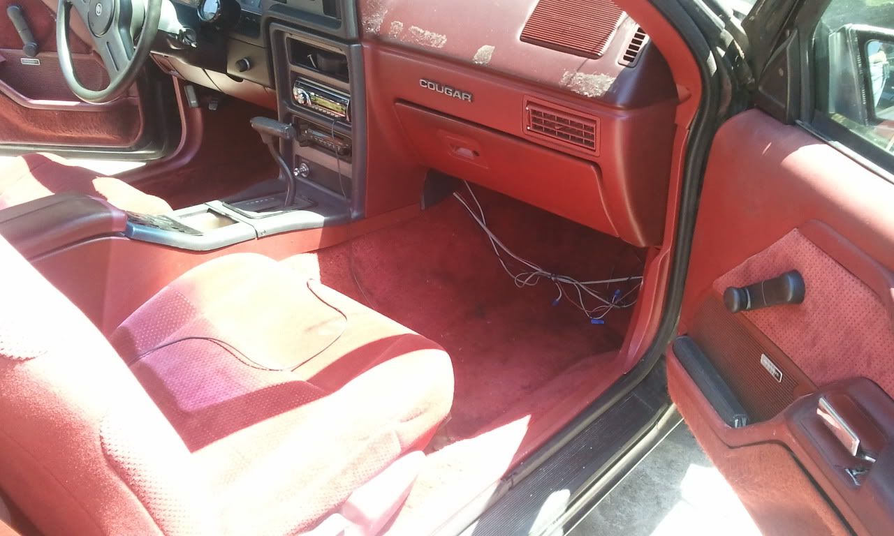

Well, then that's a good thing.LOL. If you were closer I'd love to help you work on the car.........................and remove the Cougar emblem from the dash...........................................
Reply #358
LOL, you could help me remove the dash from the car, but.........the COUGAR emblem is um, well....STAYING;)    It'll look much better after the dash cap is on and the ugliness above it goes away. Hey, come on, the 83/84's had it, why cant I?:cool:
