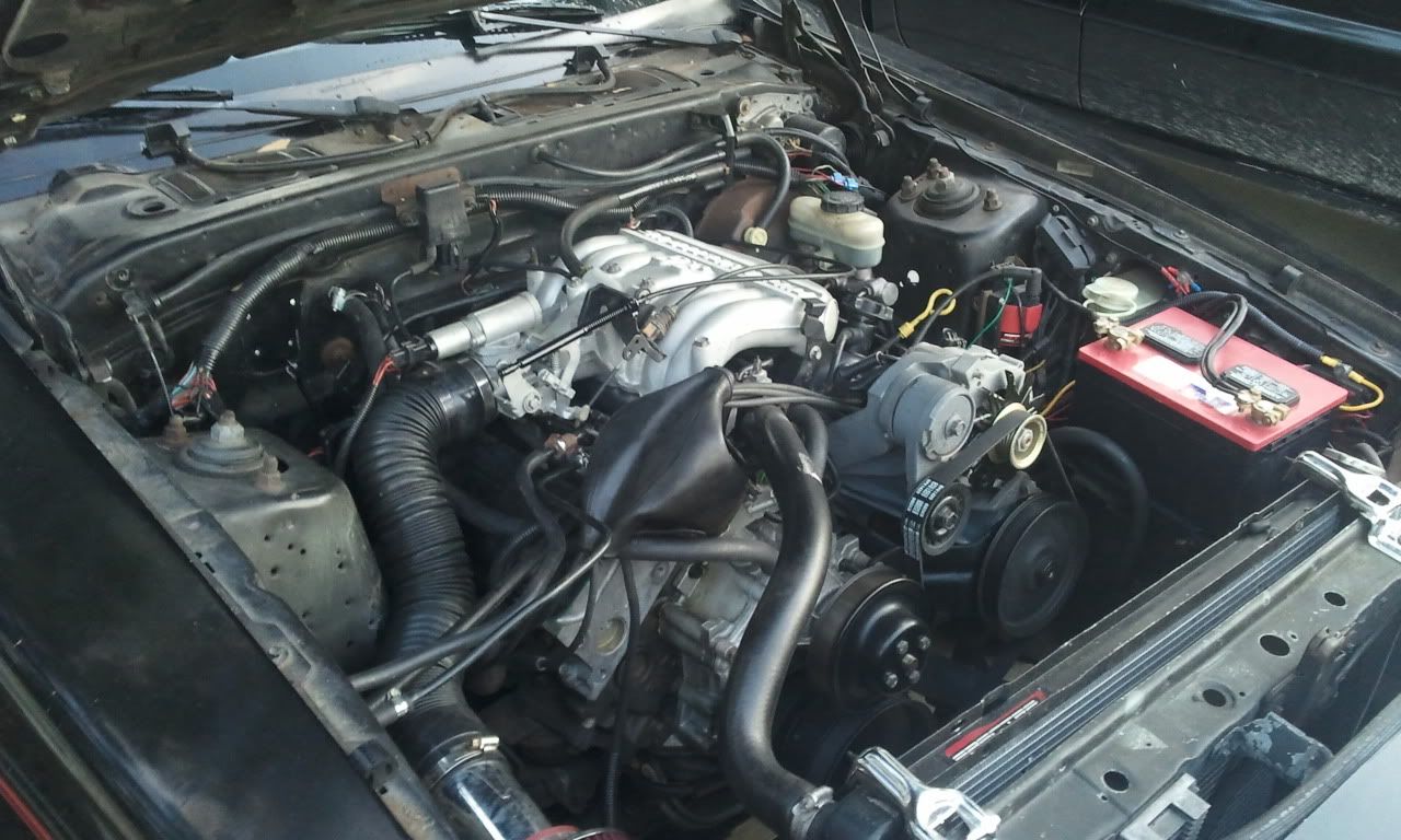

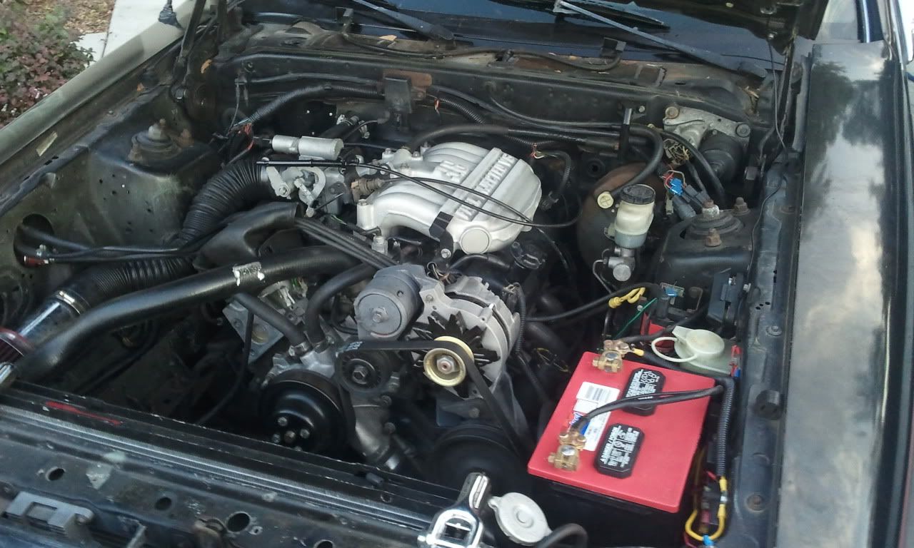

I'm not going to actually poslish my intake. The one in the pictures is new though. I cleaned it up real nice before I threw it on. It looks so nice it looks out of place lol. I'm not going to go full on with the polishing b/c I've currently got my eye on a s/p setup so it'll all be going away soon....:D
A note, btw, for anyone who for whatever reason, ever gets the idea in their head to replace their 3.8 intake with one from a mustang, like I did, well every thing will bolt up 95% exactly the same except for one problem: You will need 20" of 3/4 heater hose to re-route the hose since the new intakes don't have that idiotic pass-through in the main intake to the heater. You know, those stupid little pesky hoses that are like 4 inches long and PITA to get to/change? well they're gone and now you'll actually be using a single hose and routing it under the intake. Which actually is nice b/c now you don't have freaking HEATER WATER PASSING THROUGH YOUR INTAKE????? like you did before. I mean, really... who was the one who came up with that bright idea in the first place? was it for gas mileage? well anyway, now its better. Oh and you'll need a vacuum cap cause the late model intake has two vacuum ports where we have one... which is where the MAP sensor connects.
Just a little random 3.8 fyi.
