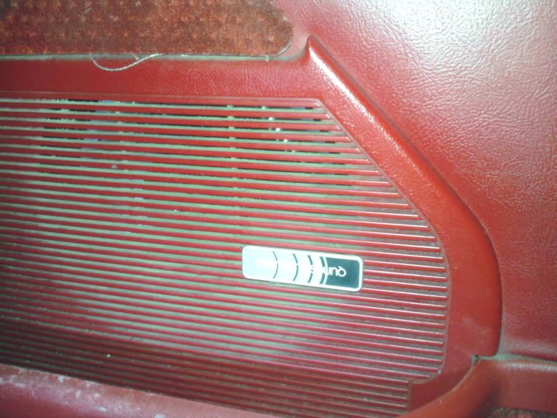

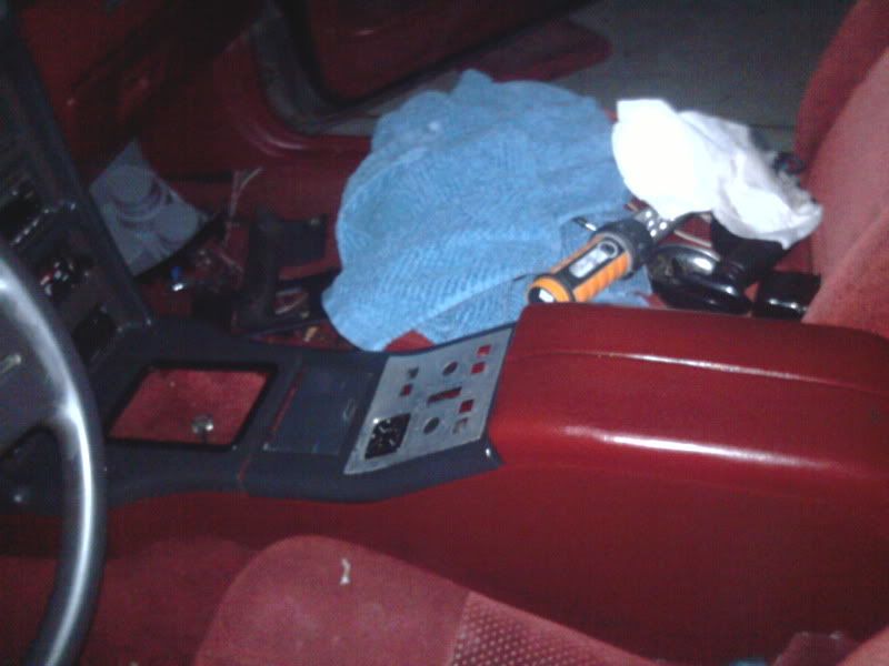

Got some stuff today from hcor:D....
Lid and auto bezel::grinno:
Dash trim with intact screw holes:D
And, even though I got the factory "PY sound" I installed my own "PREMIUM sound", so... they fit:headbang:

Reply #185
Thx bud! There's gonna be a shifter in that hole in a couple weeks;)

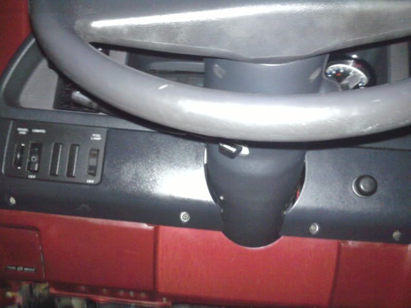

Also I got ahold of the guys over at AutoMeter and got some finish dimensions for my guages so that I could design the proper setup for them on my cluster. Well, as it turns out, it is impossible to fit 4 2-1/16" and 2 3-3/8" gauges without losing part of one somewhere. The dimensions given are for the holes to be cut, not the finish face dimesnsions. So I got a template drawn up to the best I could. Turns out the top two are going to have to be cut out of the bezel a little bit for them to properly fit and be seen. Trust me, I worked on this for hours, with 3 different designs, it is impossible to get them to all fit in there.
Here's what it looks like inside of the bezel:
