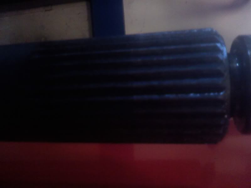

Here is the Ford Racing Axles:
3000 Miles Supposedly, From an SN95 Housing.
