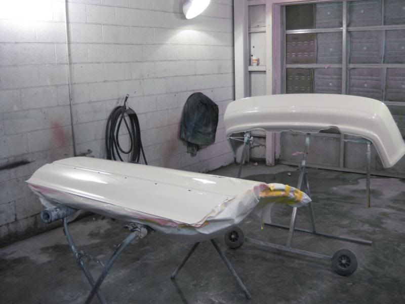

Pics from the days labor
Reply #538
A couple progress pics.
XXX
1988 TC single Holset turbo 5.0/ 4R70W
Reply #539
