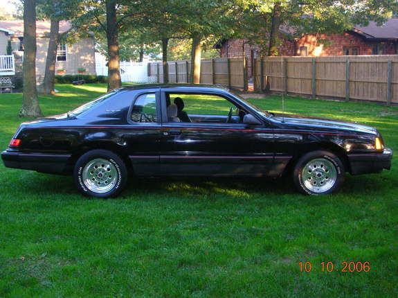

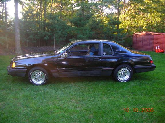

thes are 15x8 wheels in the back, with p255/60r15 tires on those and in the front, I have 15x7 wheels with p235/60r15 tires on them.
the rear tires are 10 1/4" wide and the fronts are 9 1/4 wide.both ,front and back are 4 1/2 backspace.

That's exactly the look I want.  I like having 17" wheels but I really dont see any benifit to them when the rest of my chassis is not really built to handle.  I think a nice set of 15" or 16" wheels would really improve the drivability of the car.
I thought you had a setup like that!  Thanks!  If I do it I will make sure and get a different style wheel so I don't rip off your idea!

I like both of your setups...however I am starting to see that there aren't many choices on wheel styles.  I'm pretty much going to have to rip one of your guys wheel styles off when I do this.

That would not bother me a bit,you dont see any of these cars with Rodlites on them,maybe there not to well liked.
