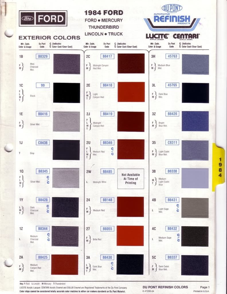

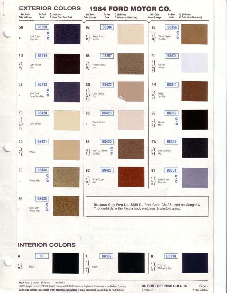

What you guys need to do is get up, get off the net, and actually go to a auto paint place. I work at a parts store that mixes paint. I can mix your dye and seeing how I'm a paint mixing store of many years I just happen to have the exterior.interior and body molding color chips all the way back to 60's. So take your part with you and have them break out the old books and look. Most places can mix what you want right then and there. Might have to find one that can put it in and aerosol can if you need instead of spraying form a paint gun.
here is an example of what you will have to look at.
