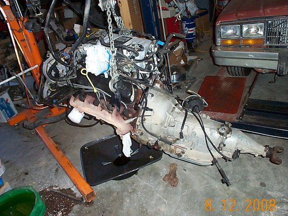

then i have a 1987 5.0&AOD tranny from  crown vic that only had 72,000 miles before the 1owner car forgot what a stop sign was.

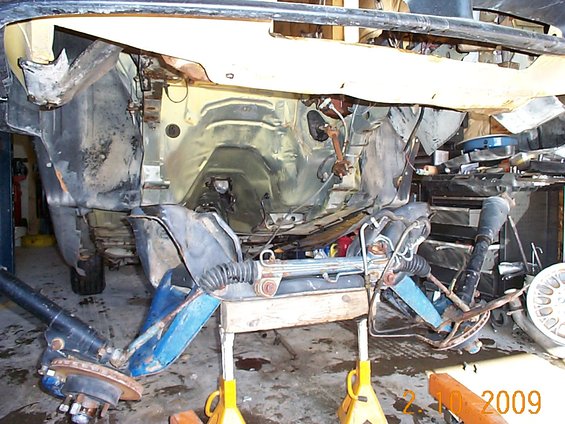

then i remember about the 6cyl K member and i happen to come across this V8 k member.that some one had put rebuilt rack and brakes on when the car was wrecked.

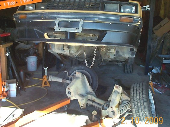

 so on this nice sunny day. i got out to the tharapy room about 10am. started pulling the 6cyl/tranny and Kmember.
a little after 12 noon .i rolled the bumble bee out side for a bath of the under side,
 at abut 2 pm inside she went to have the V8 K member was going in;

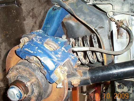

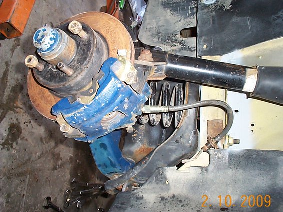

here photos of her brakes with 88GT front spings cut 1/2 coil off.
  ok, it 4 pm and she is back on her 4 wheels waiting for the V8;

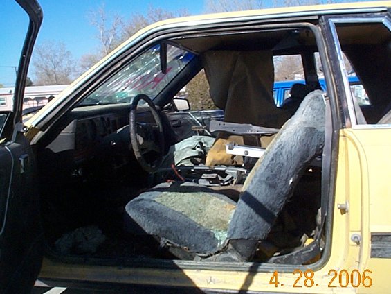

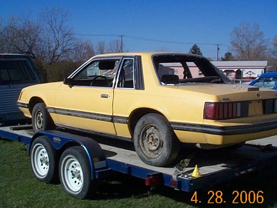

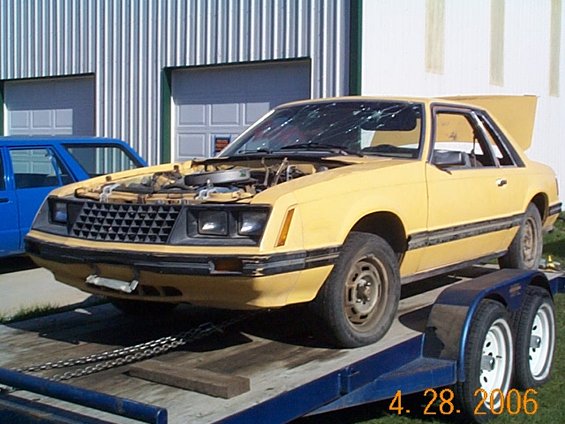

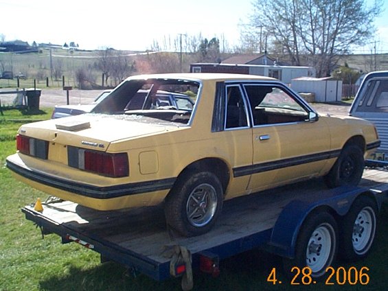

thanks . i can't believe that car only has 89,000 on it before some one trashed.here proof as i got it 04/28/2006.

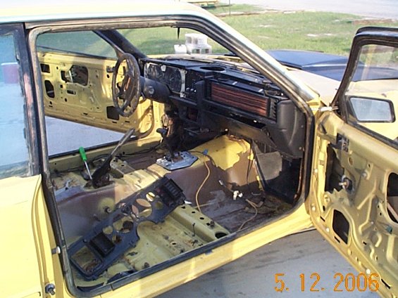

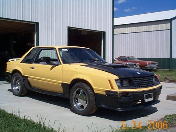

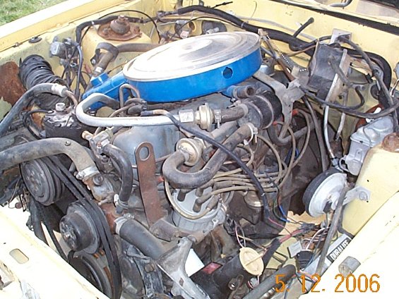

here some more photos after my tharapy the first time on 05/26/2006;

for the interior.
 i have 85/86 turbo-bird front seats.
inside door panels and carpet from black 82 stang GT .

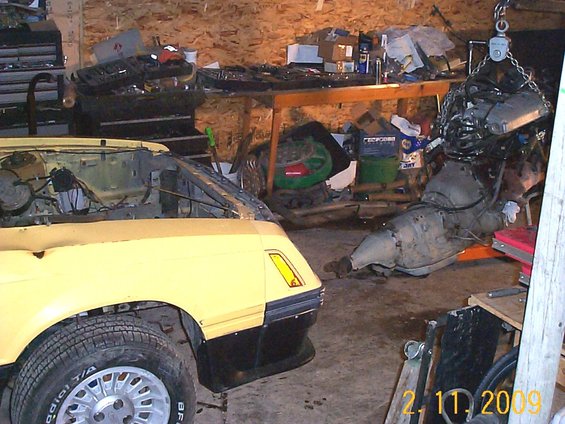

well after work .i hurry home like i had a hot date.
ran to my bed room,strip off the work clothes. jump in to  the tharapy clothes.

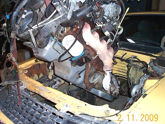

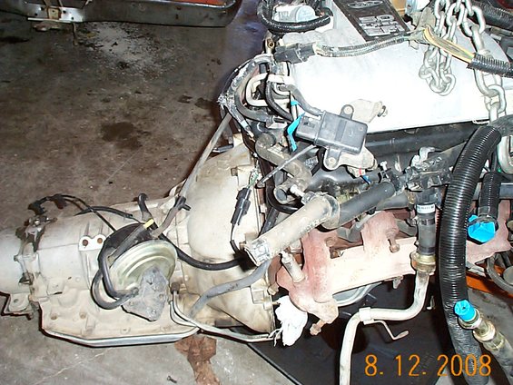

i got out to the shop about 7pm. i move the 5.0&AOD to front of the bumble bee.;
while the 5.0 was there .i change the front motor mounts from crown vic to fox body. then i put her up on jack two stands and i said ,here  open wide;
 after gettting the 5.0  sitting on the front mounts. i move to the under side to put the double hump cross member in. first one cross member side bolt, then  run around the car to other side. put in the other side cross member bolt. lower jack under tranny.  dang,i forgot to swap out the tranny mount. i get out ,go over to the 6cyl/C-5 tranny on  floor on the other side of shop.i get mount. go back to bumble bee. i get under car. take crown vic tranny mount off,install the fox body.
then it hits me! i'm laying on the floor under this car.which is under the 4 post hoist.  that is holding up casper(82cougarXR7). some times, i'm not the brightest bulb in the shop.
well at 9pm the5.0&AOD in.
 time to clean up mess i made. call it a night.
