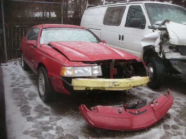

Parts needed to rebuild my car:
Front bumper assembly
Front bumper
Front bumper (cover)
Grille assembly.
Front end panel
Headlamp assembly.
Hood panel latch
Hood safety catch
Hood lock
Hood hinge panel for the left and right.
Radiator panel
Front fender for the left.
Front fender repair for right.
Fender assembly
Please help my car is broken :hick:
I also need my car to be welded and the frame is bent.

i have some ls parts but they arnt all that great from an 88 v6. i may have a grill and if by some odd ball chance the bumper itself, but i dont think any of it is in suburb condition i can check if you wish
P.S. looks like that passenger headlight and signal assy is flawless so one less set of parts to find there...

Do you have better photos of the damage in the engine compartment and the core support area?
Thanks
Ken
Parts needed for Samanthas 88 cougar
I have no more pictures because my hood is jammed shut so in order to get that open i will eventually take my fenders off too see.

in my opinion and in light of your needing to save money,,,
Quote from: Samantha;248783
(weld that piece back on)
Front bumper
(cant see where that plastic bumper is actually broke)
(dont need, plastic weld kit can fix all that)
Grille assembly.
(need)
Front end panel
(called header panel, yes its needed)
Headlamp assembly.
(need)
Hood panel latch
(need)
Hood safety catch
(need)
Hood lock
(i guess you need it, not sure)
(not sure what this is)
Radiator panel
(pull and straighten, too costly to replace)
(dont need)
(dont need)
Fender assembly
(dont need)
Like on your bad news thread, all i can see you really need at this point is a header panel (contains the grille / headlamps). You need this part pretty soon because it will contain all the bolts that will tell you when your done pulling the frame.
You know full well your going to have it painted up front anyway, your fenders are not jacked up at all and there are no creases in critial 90deg bed areas. All of that minor damage can be tuned back in with common sense  basic tools and a little love.
Again, the header panel is the key part at this point,
here is what i think you need for the whole project
big stuff>
header panel
weld bumper shock absorber
bumper (not sure, cant see the real damage to it, the bolt holes are all that matters)
little stuff
grille or modified to a 20th looking grille (you can have fun doing this part)
driver lights
driver plastic molding (iirc)
hood lock
hood latch
test radiator
test AC radiator thing (see if its holding presure by pushing in valve, if so, let it leak off and remove/save / re-install / recharge later)
plastic weld the bumper cover
