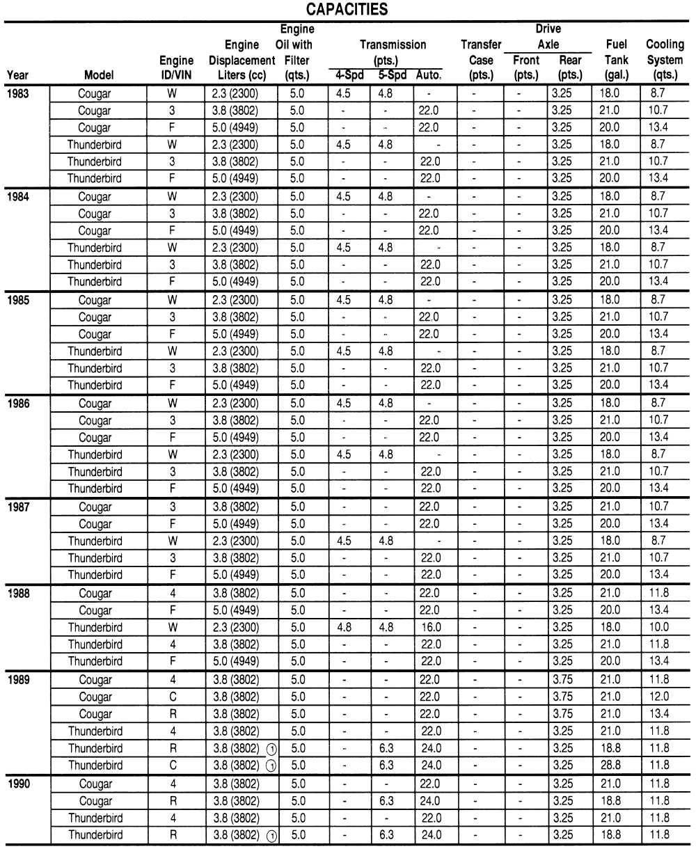

those are mn-12 capacities.... are they the same?
another how to question
For '84 it's:
2.3L 10.8 qts
3.8L 11.7 qts
5.0L 14.2 qts
By the way, since you didn't answer in your other thread, when you put the ignition in run without starting, what does the fuel pump do.
Quote from: mywifeskitty;245538
Probably not.....wrong chart....sorry.  I've fixed it.
