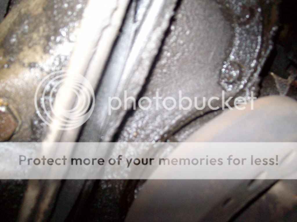

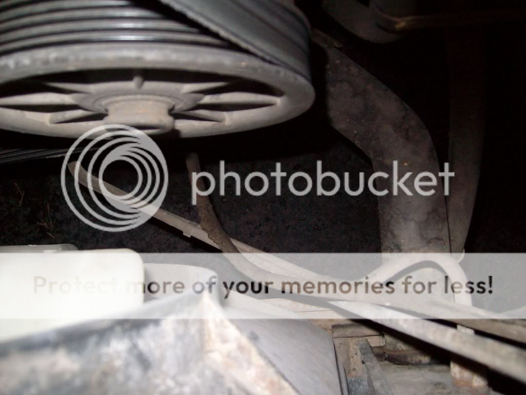

I couldn't get underneith the car to get good pics on the side of the tranny. Heres the two from the front that show where they go. That is prolly the part you know though...
Transmission Lines Routing
Do they go over or under hte motor mount then?
It looked like it went under. I'll get you a good pic tomorrow.
