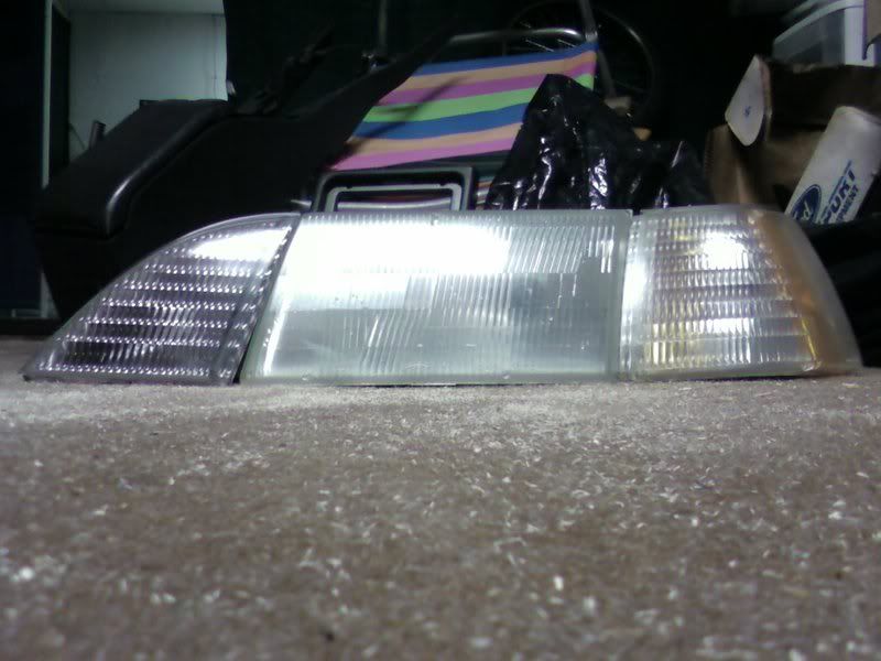

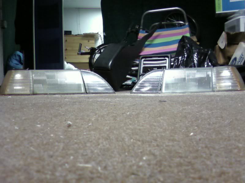

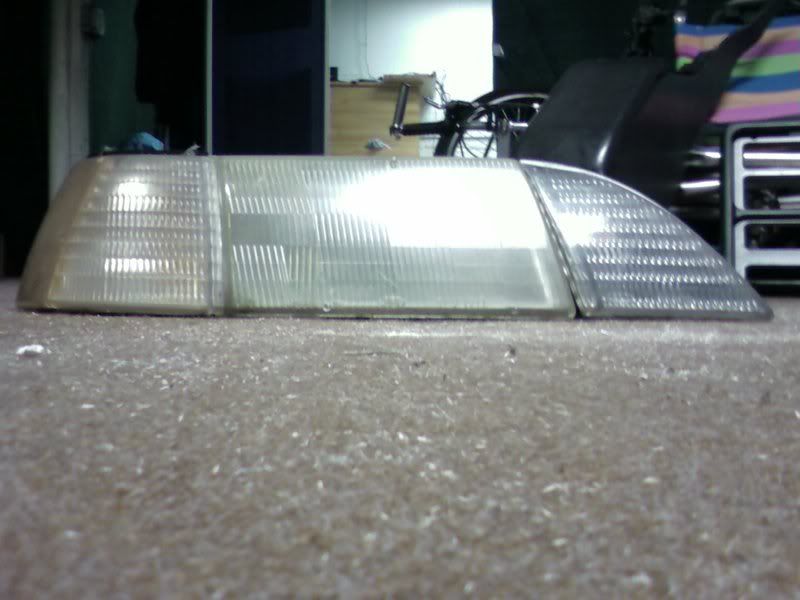

I don't really have a plan for those headlamp assys yet... they're just in really dirty condition and I wanted to clean them without spending any money, and perhaps more importantly, without breaking anything. Don't get me wrong, I'd love a set of NOS lights... but I have to work with what I got for now.
I managed to get the lens off yesterday with the butter knife and plenty of patience.
I got the cleanup idea from this thread
