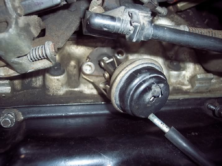

Managed to break the plastic taking the valve cover off.
I've got the bolts out, I've hit it a few times with a BFH... Whats the deal here? Hit it harder? :hick:
I'm going to need to grab a replacement at the junkyard, So i'm going to need to be alot more careful getting that one off...
Any Ideas?
(And ignore the grime... I'm in the process of cleaning everything up, It's a filthy beast)

Woo Hoo!
Got it off.
I had to pound on the thing to even get it to swivel like the book said...
I grabbed a solid long piece of wood and chisel pounded it counter clockwise, After it broke free and moved i noticed it had raised from the intake...
After trying to pry it up, wiggling it, trying 360 spin outs... lol.
It didn't want to lift out much higher. :mad:

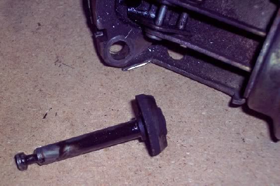

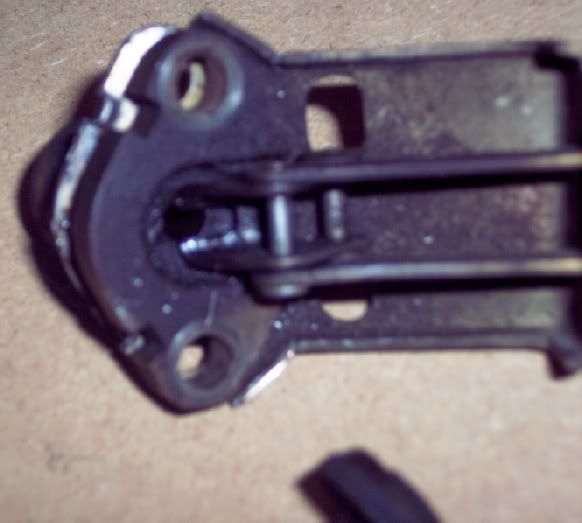

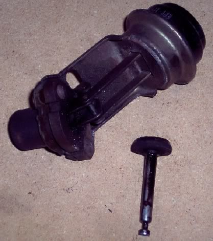

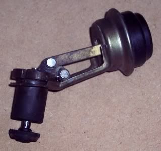

Then my dad comes out with a letter from my friend (he's off in navy seals training), And i tell him about the whole ordeal with this sucker and he straight up bends the thing downward, so now the pin is free from the spring loaded part of the HCV, and lifts it right out!
I'm like... WTF! lol. Thanks dad.
I'll post pics soon.
How do i get this sucker off?
Pics:

Just got back from the junkyard.
They only had one 3.8 with this thinger on it, Surprisingly it was an '85 LTD, And had the same engine as a T-Bird.
And to make things worse, IT BROKE!
The  thing was more stuck than mine was, I tryed hammer tapping it loose like i did with mine, And the sucker broke into 3 pieces.
It broke at the base, the thick bolt down area.
It broke enough i was able to bend and get the top part of the assembly off... Kinda hard to explain.
I'll post pics here soon.
I think i can fab up a good one~between what i have of my broken one, and the broken one from the 'yard.
