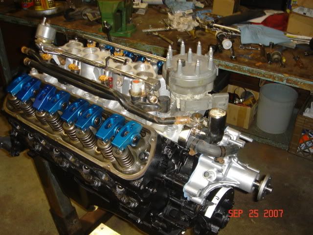

some motor pics
 Before I put the motor in I put some fresh paint on, wish I didn’t rush it though but it came out better then I thought for a rush job.

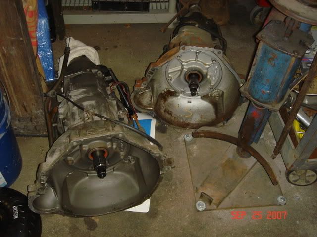

heres the lentech trany next to the AOD check out the shafts

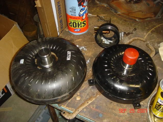

the old stall next to the newer stall converter

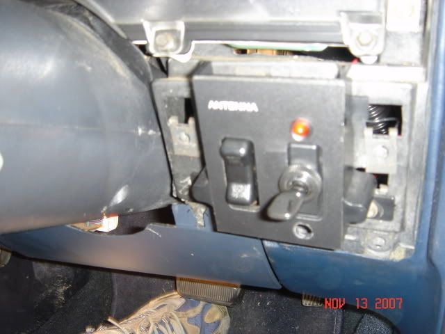

the O/D delete switch
