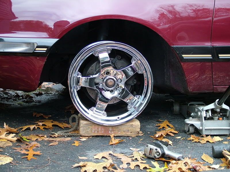

Here is the side view;

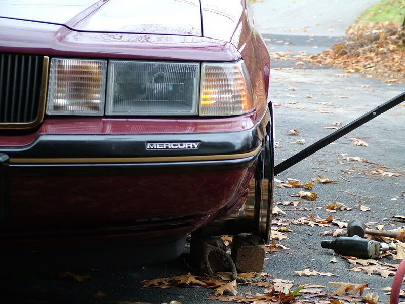

Here is how far the rim sticks out!
Here is top view:
There is 1/4" clearance to strut which is fine, more than that for the tire section width (3/8"?). Can turn the wheel stop to stop without issue due to Cobra "D" arms in front. Hub is an issue and will need my "custom" touch to fit - oh, well.
Should I even bother to mount tires as I am slightly illegal? Should I go with 235 or 245 cross-section - I think either will fit but the 245 may hide the edge view of the rim better.
Any opinions out there?

What size wheels are these?
I can't see the pictures, since IT blocks all the photobucket domain (rendering most pictures on this forum useless).
My 5-Lug plans (um, back to 4-lug!)
They are 17 x 9 with 25mm offset. They are the right offset but the rim sticks out a little more than the old 225 tires as they were 9.625" cross-section (just measured) and the rim is 10". I can use a tire up to about 10.4" max cross-section, but I would prefer 10.3" or under. Any help appreciated as I am looking at getting some tires!
Put a tire on it then look at it,i did the same with my 18x9s and 10s and they didn't look like they would fit but they fit perfect.
It's very misleading with just the rim.

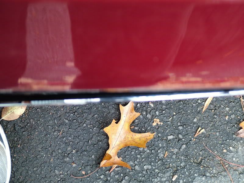

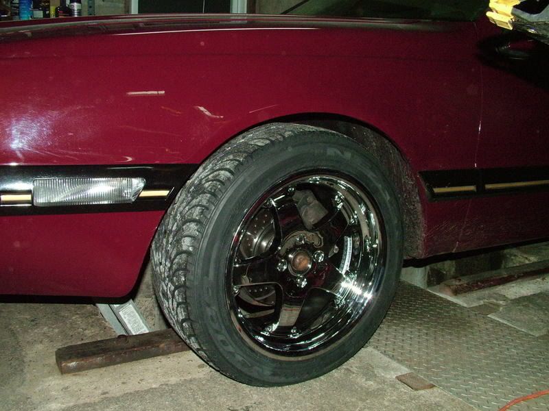

Well, the 255's were hard to find and I realized that the tread would stick out quite a bit (tread width is 3/4" wider that 245/45) so I went with the 245/45/17's. They don't seem to stick out much, but they really rub the fender too easy - I'm really bummed.
Worst picture ever:
I know my camber appears to be the wrong direction so that may be something to look into. I am a bit annoyed right now :(

Nothing worse than getting done a project and being bummed about it. Where is it rubbing?
Jim
Reply #44
If I take a slight right hand turn and there is uneveness to the road, it ****ing rubs. The marks on the tire and sound location say it's just simply hitting the fender. This is the famous drivers side tilt coming into full play here - passenger side - no rubbing.) My head is about to explode! The damed tires are hardly any bigger than the 225/60/15's I had on there (in theory), but they look quite a bit bigger side-by-side (can tread wear make the old tires look that much smaller?)
The camber adjustment is on the most outward rivet, but it does appear that I already have a slight amount of negative camber. How much negative camber will those two holes give me? It will have to help keep the tire off the fender somewhat. ARRGGHH!! :(:(:(
