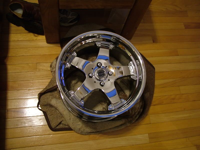

In my current case (described earlier), going to 9" wheels would push it out .7" (4.02-3.32)=.7
My 5-Lug plans (um, back to 4-lug!)
Reply #61
Yeah, that's about right. Turbines have a 4.95" backspace (verified just last week) which is about 24mm offset assuming an 8" wide lip to lip wheel - I just round off to 5". The new wheels have a 6" backspace and 25mm offset so I expected the rim lip to be 1" farthur out. It's close enough for horseshoes and hand grenades. All I care about is that the center point is approximately the same. They fit perfectly as a rim lip 1/4" from the strut is about as close as you want to go! I suppose I could have a bit more as I always push the top of the spindle in as far as possible before tightening up the strut bolts (for obvious reasons). Everything is on target as far as tread edge location WRT the fender lip - like I said, the actual dirty part of the tread is slightly more inboard with these new tires/rims.
And yes, you having the 30mm offset are in good shape so long as you can resist upgrading :D
