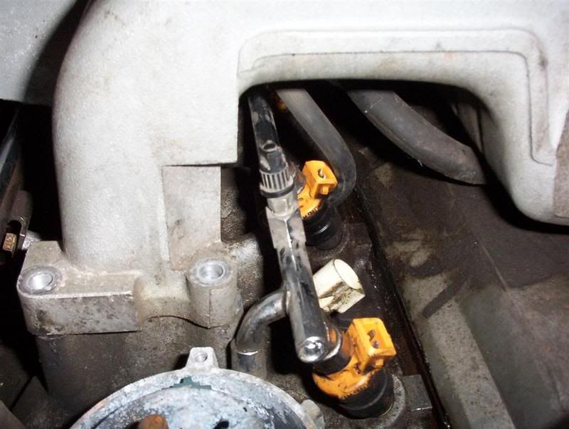

Enter a 5.0 truck/van fuel rail.  The truck fuel lines come up under the booster, the same spot as a TC.  The hard lines are the same fittings as well.

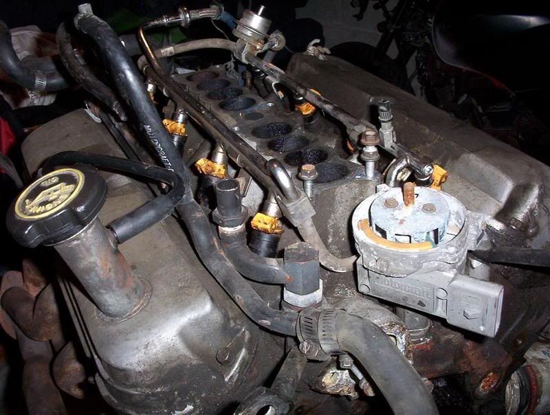

Here is the fuel rail on my 5.0.  Notice the lack of entry point.
Here is the entry point.  On the backside of the engine on the driver side.

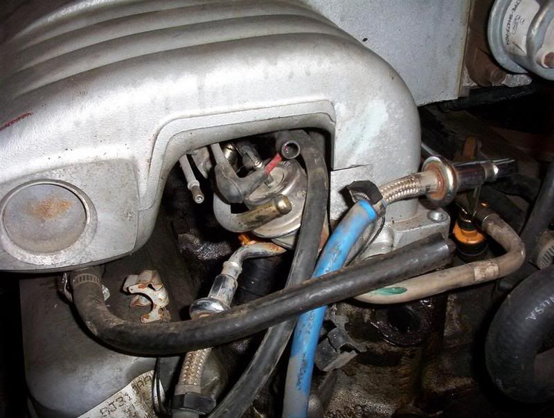

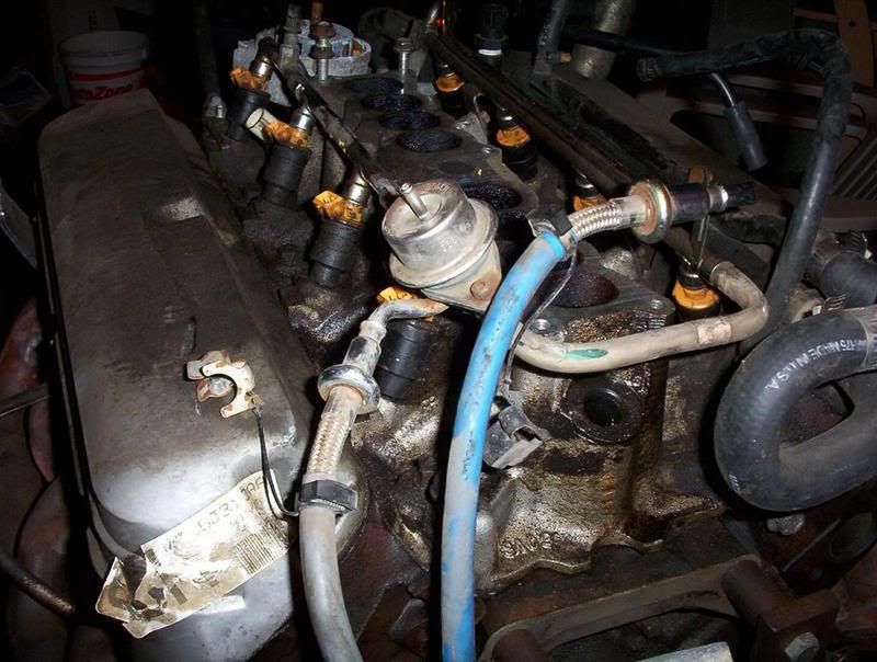

This rail places the FPR under the intake kind of tight but this wont be an issue, I'll explain in a minute.

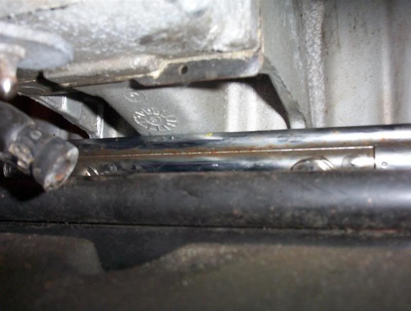

Here is the issue.  The passenger side rail is double stacked.  The car rail isn't like this.  The truck intake is high enough to clear but the car intake is not.  the bottom of the intake hits the rail.  Solution...  1/2" intake spacer, a good thing either way.  So with this spacer it will give the room the FPR needs.
The schrader valve is in kind of a better spot.  With the required intake spacer and probably a 45 or 90 degree elbow the gauge would be in a good viewing spot.

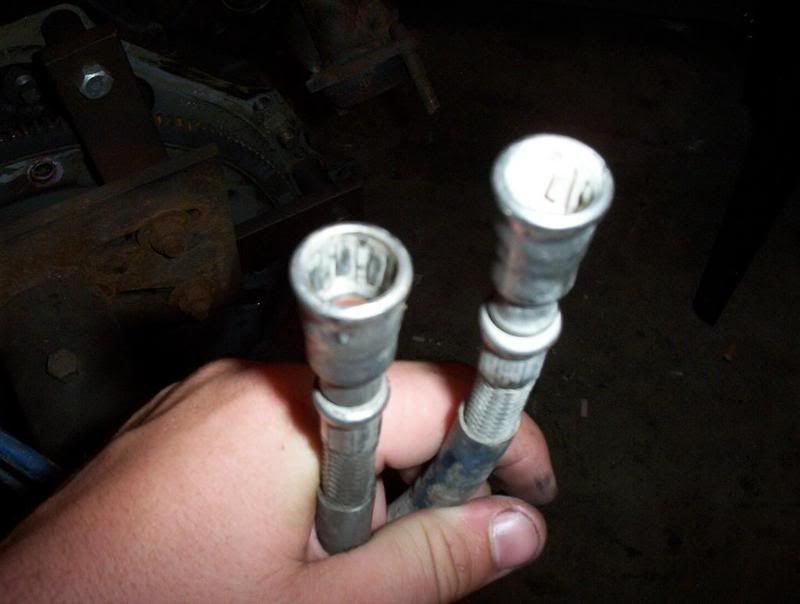

Another bonus, the stock lines that connect the fuel rail the hard lines on the rail are braided stainless.  These lines connect right up to the TC hard lines.  :hick:
