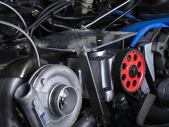

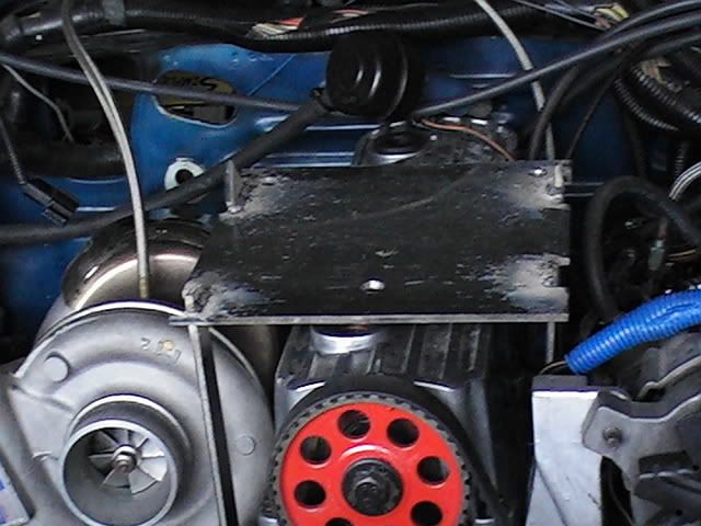

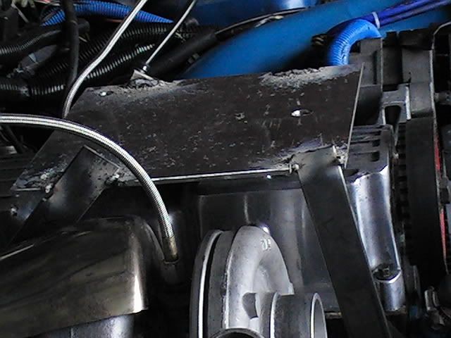

I wonder if anyone can guess what this bracket will hold and give me more low end torq? The only person who I've told is sleeper-tbird.:D

And xr7cat is the winner!!!

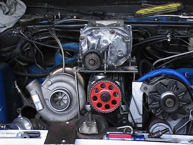

Still need some more lil stuff before its working and need to paint it. It's a experiment to see if it would work and have the best of both worlds, the low end of the sc and the top end of the turbo.

You now have my full attention, and thats hard to accomplish. Do tell more
Hmmm I wonder...
Well the sc will be feeding the turbo and also maybe help it spool along the way faster. I won't be able to test drive it because It no longer has a tranny need to rebuild it. Also Im converting it to 5 lug using stang 03 gt pbr brakes.

why dont you just find a smaller turbine housing?

Well yea I could find a smaller turbine housing but I already had the sc and cost me lil to nothing to mount it. Also I want to prove wrong the ppl that say that this combo would not work. And last reason I did not went smaller housing is because im 19 and currently dont have a job.
