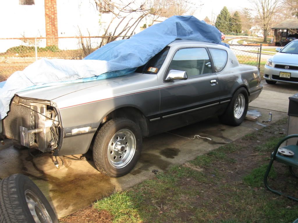

Here's my 87 with 15x8's bfg drag radials 275/50/r15 with the stock 7.5 (I haven't driven the car with these wheels yet)
I want to try 235's cause the 275's look like they'll rub. I can try to get a closer picture. If you try the 235's let me know how they fit.
Back spacing Question! 87 Cougar
I think those are gonna rub, is this with a 4.5 back spacing ?
Thanks for your time..
Brian
To me they look like 5.5 back spacing, do you have the fender wells rolled ?

Sorry for the late reply, those wheels have a 4.5" backspacing and I don't have the fenders rolled. Since putting on the bullit springs I haven't tried putting these wheels back on. I don't think they'll fit but I'll try tomorrow.

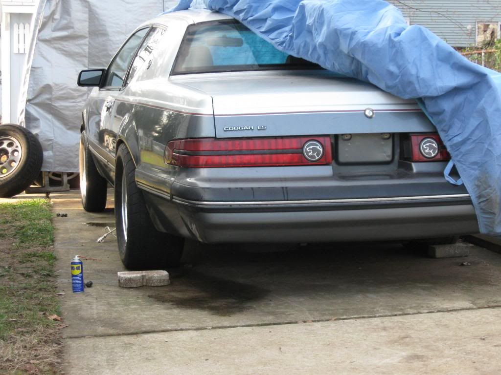

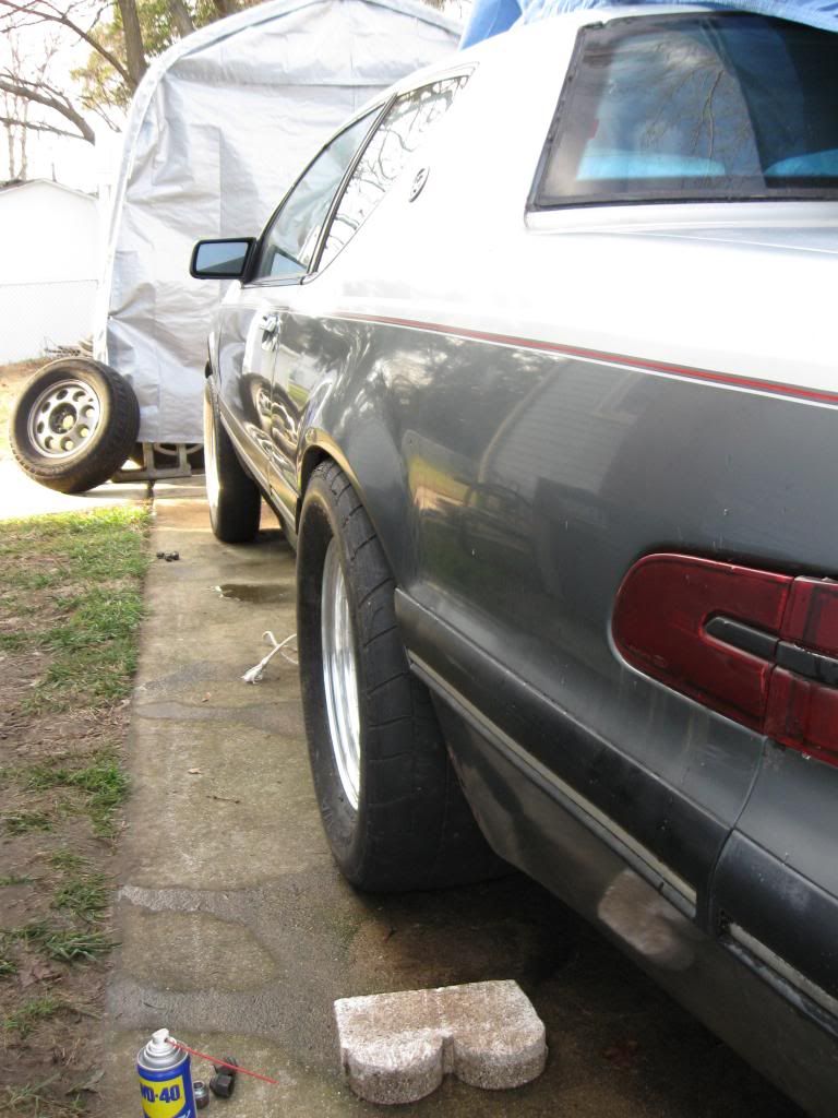

Seems like I'll never get anything done. Here are pics of 235/60/r15 on 15x8 draglites with 4.5 bs. I rolled the fenders but I think I could have gotten away without it. Unfortunately I don't have pics without rolled fenders.

Your golden right now
5.5 is the best but I run fast 5 rims 4.5 because it gives the rim a extra 1" of lip and looks way better than a 5.5 I run a 235/60/15 and its perfect
Bit small for power but I think 255 will fit also
I have proper tire for racing but my suggestion for looks
Thanks. I like the extra lip also. The 235's give a "square" look I like the to wheel and tire combo. My 302 isn't worthy yet for bigger tires!
