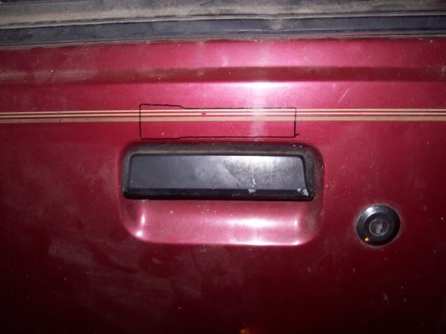

the mark for the keyless entry cutout:

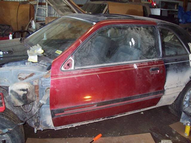

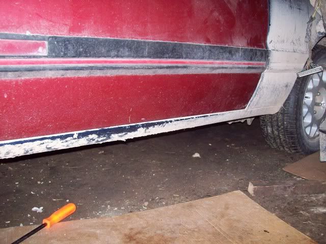

not too shabby, but seriously needs a wash:

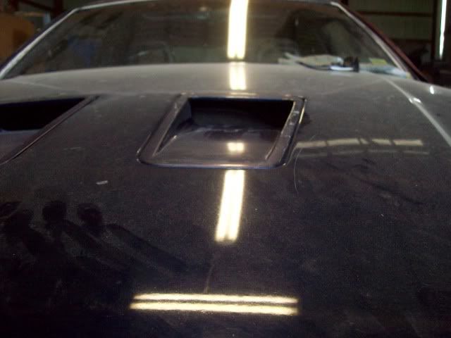

"real" TC hood:

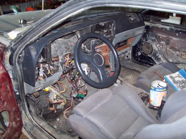

dash back in, finally:
I have the mirror on, and have to get some more jigsaw blades to finish the cutout for the keyless entry panel. I knew I shouldn't have started that with only one blade left..ughh.
That's all that is left before I slap on the door panel and whatnot.

On the template drawn on the driver side door for the keyless,it looks like it needs to come up a little higher from the door handle.Measure a few times,and cut it once.On this matter,once it's cut,it's cut.No going back.You are where I was a year and a half ago.Doors,interior,hood and more.Feels good to make progress doesn't it?

Take the lock and keypad off of your old door, put masking tape over the holes and cut them out with an exacto knife. Tape it back on the new door. Perfect template.
