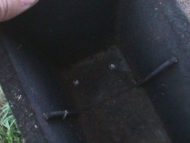

Oh on this console thing.... there is a piece of steel that is under the console bucket.  The two holes in the bottom of the bucket screw into this.  On early cars it was actually screwed in, on later cars it was spot welded to the floor.  I made my own piece.  Its roughly 1/2" tall.  When you cut the carpet out you will see a square cutout of your rubber sound deadener directly under the console bucket.  That is the placement for the metel piece.

These are the two screws I was talking about that screw into the little stamped bracket under the bucket.
