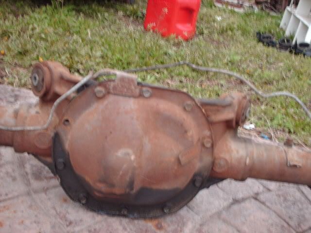

Long story short, it seems to be a shorter rear end, by about 1 inch overall, it is a 7.5, and it is a 3.73 gearing, so I am getting it, even though its a 7.5

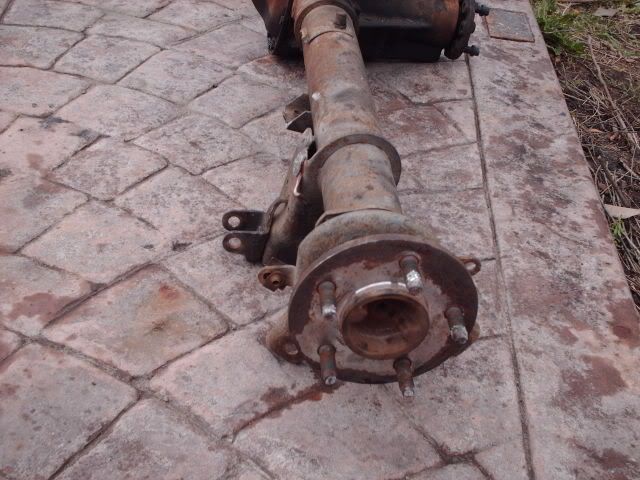

picked it up today, here are some pics.
3.73 gears and traction lock, here I come.
:bowdown:
Quote from: Haystack
You lucky !
Congratulations!

best part, disk brakes and 5-lug, and its off of a 85 mark, so it should be mustang width too.
