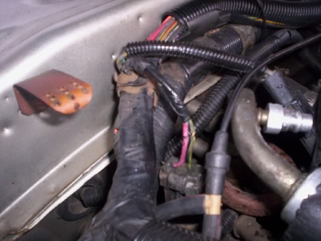

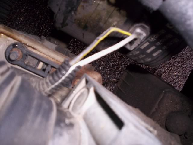

Ok guys, here are the pictures to show you what I am seeing. Now, I am NOT an idiot, but i'm just having a real hard time understanding what you guys are telling me to do.
I'm ASSUMING this is the Cycling Pressure Switch above the dryer correct? If that is the case, as you can see, there is a Pink wire, with a Blue Stripe, and a Green Wire with a Black Stripe. This is part one of my confusion. You guys keep saying Green/Pink wire, yet there is none. There is a Green wire and a Pink wire, but not both combined into one.
This is a view of the Compressor. The only thing I understand is I'm supposed to connect some wire to the yellow one on the left side. Right?
Ok, with that explained, someone please visually help me. What goes to what!?

The way I read this is that your car is equipped with Auto Temp. Control.  Are you getting any fault codes if you run a self test?

Connect that pink/blue to that black/yellow
BUT Don't run it long if the system is not taking any freon.  You risk burning up the compressor.  You may need a new orrifice (sp?) tube.

Ok well now what? I ran the Pink/Blue wire to the Black/Yellow and the clutch didn't engage. Heck, I even ran a line from the Battery to that Black/Yellow wire and it still didn't come on!
There's no way your going to get me to take it into some place and get laughed at, so I'm stuck fixing this problem myself. What's the next thing I should do? I've heard something about the ICRM, something about an orifice tube, possibly a Bad Cycling Switch or "wot", where do I start????
