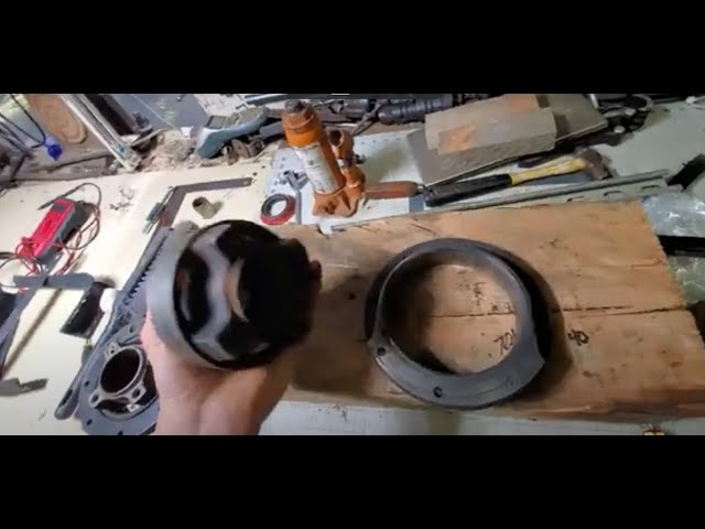

symptom- engine was shacking a bit like a plug wire was intermittent or maybe a misfire while under a load.  i also thought i had heard a metalic rattle under the hood. i checked the plug wires and all was good and tight.  i moved on to see how my fuel presure was and found good readings but................  then i heard a  rattle  while running similar to the one i heard when i was parking it last time a couple days ago.
the outter ring of my harmonic came off.
I keep equipment so long that it seems like i end up having to deal with problems that take years to surface like this one.  Ive never repaired a harmonic so any advice will be helpful.  What i need to know is are there factory alignment marks so when i install a new rubber,, i know i am doing it right.  Otherwise i suppose i could find TDC and dial it in like that especially knowiing my timning chain is really new.

no,, i mean repair the balancer,,, meaning put the inertia ring back on.
Re: harmonic blancer / damper came apart
I dont think those are repairable. :dunno:
well,, the inertia ring is pressed on and i have a spare to compare something else.
it appears that ford folds in half a rubber flat belt,, think folding "down and around" to double the thickness.  then they somehow keep the rubber in place while pressing the ring over the two layer rubber..
I have already figured out how to clock the inside to the outside parts thanks to having a spare to compare with.
I will install my spare,, but i will also do a repair vid on this.

its the part that single bolts to the nose of the crank.  It has an inner hub and an outter intertia ring.  i have a spare which i will install that has good rubber.  I am going to use some of my spare tractor innertube material to do the repair.  I was told an old leather belt will also work perfectly fine.

well now,, it appears i ****DO NOT****  have a spare harmonic.
I removed the unit from my 1990 ford bronco full size 351w.
i compared it to my spare.
it appears my spare is for a 302.
my spare is about 20% thicker than my bronco unit with repect to all thickness measurements i  made.
more differences...........
I am very confused on the exterior inertia ring.  the broco unit has more meat on it than a 302.
my bronco unit has extra metal on the inertia ring occupying the area equal to 10 o'clock to 2 o'clock.
my cougar  unit has extra metal on the inertia ring occupying the area equal to 9 o'clock to 3 o'clock.
I look on rock auto and yes these are available for my bronco.
i experimented and entered the data for my bronco and on a separate tab, entered the data for my 87' 302 cougar.
Doing a side by side comparrison, it appeared rock auto says the same number for both engines such as vendor "Pioneer".
I found this same problem with other vendors but not all while doing a side by side.
since my intension was to replace with my spare,, and now that i am gunshy with rock auto,, i found a unit on ebay for 59$ shipped that matched my for "E" number and foundary stamp so soon i will have one.
this will not prevent me from repairing the unit i have with a vid.  it will be fun,, no vids exist for this repair at all where one is pressing the inertia ring back onto the hub.

attempt 1 vid
https://youtu.be/4MTpsBlwT3s

called "pioneer automotive industries" and they agreed their database is incorrect and that a 351w is 28oz imbalance for pre adn post 82'.  the 302 is also 28oz pre82' and 50oz post 82.... "ish",, and then the debat goes on for 1981 samples.
so............  pioneer refered me to "damperdudes" out of claifornia.
i called them and they say they are repairing dampers with two part silicone and baking them.
they set them up in a jig,,, and inject the two part silicone,, let it start to set then bake.
they mentioned that in california,, rubber was classified as a health hazard and they had to spend more money to retool
and meet state epa and global warming regs.
damper dudes and i discussed my measurements and observations and agreed that they to would be simply pressing these reman units together but they never consiered using recycled material like rad hose.
i found out that rad hose failed due to its excessive thickness.  the natural gap aorund the hub to intertia ring is .100''.
rad hose is .180'',,, heater hose is .140''.  i am doing part 2 with heater hose to press fit and repair.
